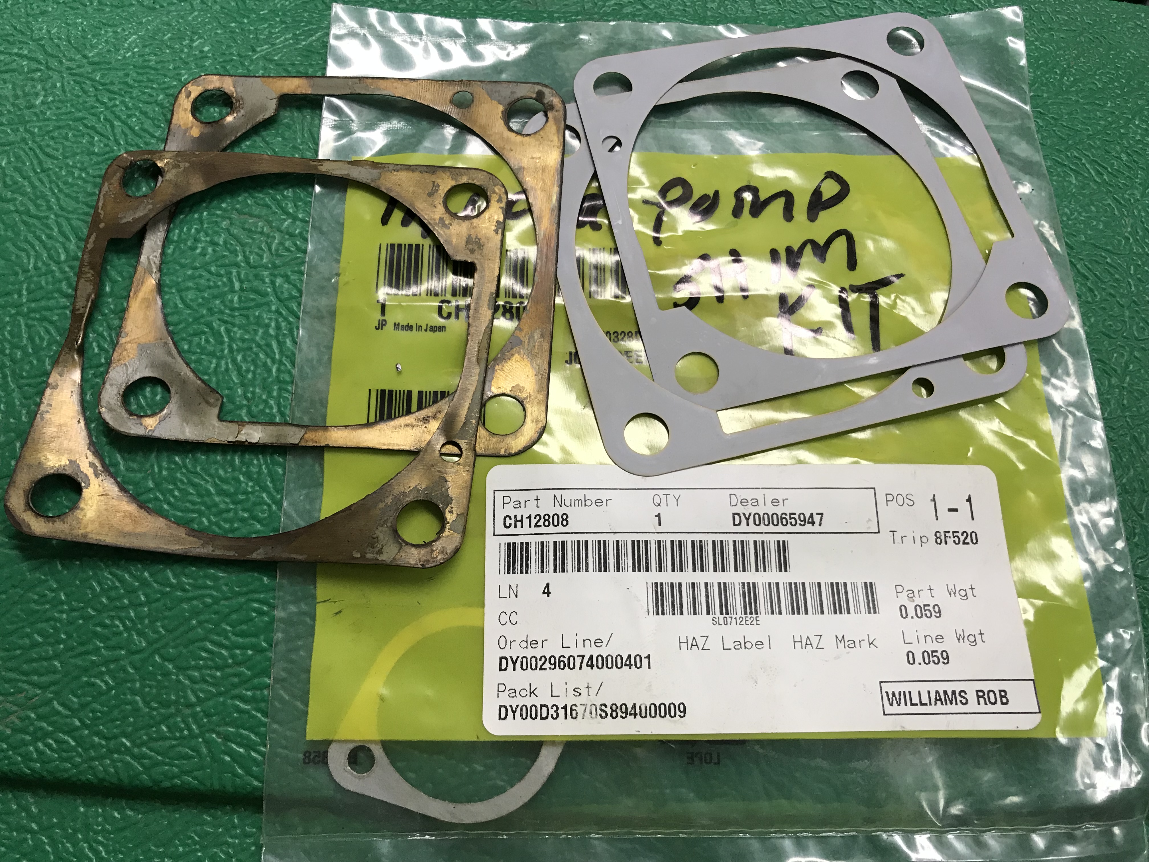

This is starting to make more sense. The shim kit I bought from Deere included 4 shims. Two were .010 and two .015. This allows every combination of shim from .010 to .050 (except .045 now that I think about it). When I removed my pump I could not remove the old shims without damage but I did keep them. The factory shim stack included two .015 shims for a total thickness of .030. Did you keep your old shims???
If you installed all the shims included in the kit you have .050 of shims installed. Likely way too much.
Think about it this way. The pump is mechanical and begins moving fuel when the plunger is displaced a very specific distance. The plunger is driven by a cam lobe so the greater the distance from the pump to the cam the later the fuel begins to flow. If I am thinking correctly, too much shim will result in late fuel delivery or retarded timing. Pump guy knows about 1,000 times more than I about this stuff so he can correct me if I am thinking wrong.
Here is a pic of my two original .015 shims and the two leftover .010 shims from the new kit.

One more thought. If I recall correctly the timing procedure requires the disassembly of the number one plunger and installing a test pipe. Because of this disassembly I believe the book calls for the replacement of a couple of seals during reassembly. I couldn’t find the seals but they are available somewhere because the pumps are rebuildable.
You could make the test pipe from one of your old lines. I bought some lines from the salvage yard for this purpose but never went thru the timing process so never made the test pupe.
It might be easier for a weekend Warrior (I’m including myself here) to install with .030 and use trial and error from there. You might pull the pump 3 to 5 times but you wouldn’t need to disassemble it. I bet it would run decent with .030 but just guessing.

NJ> they should NEVER sold u those shims w/o asking some questions.. They are not your friends..
I would find someone/a dealer that has more insightful people.
If they just sold u a "pack" of shims & u installed all of them?? Timber is right, its to much..
U need a "caliper" or 0-1 micrometer to measure the shims.. unless they're stamped w/ their dimensions.. which I don't think they are.
Seeing u prob. don't have those tools but are familiar w/ removing & installing the pump.. DO as timber suggested, remove a shim..
1 of the thicker shims will prob. get u where u need to be.??
