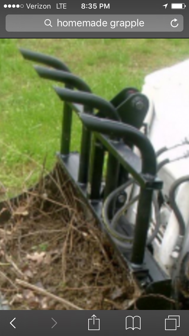

Been thinking of just welding up my own grapple for my standard bucket. After pricing out a few, that 48" titan weighs 450 pounds and costs $1100. I think the Green Thumb will be in the neighborhood of $600 after buying the thumb($400), installation mount($135), and cylinder(~$80). I mean $525 for that makes me a little sick to my stomach. I think I would just rather buy some tubing and make something like this to be honest:
I have a Mechanical Engineering background.

If you have basic welding skills and some metal tools (or a metal shop that can cut stock to your specifications) then you shouldn't have any trouble making a jaw for your standard bucket. Lots of designs to copy. Lots of threads here on TBN of guys doing that. As I noted earlier, a full grapple is more efficient especially at digging out stumps and things like that but for carrying brush and branches, a grapple bucket would be fine and much less hassle and expense.
One other thing, I doubt the Titan 48" grapple is 450lbs. My 48" Millonzi (no longer made) weighs in at about 300-320 and is made of the same 3/8" steel and 1/4" square tube. The EA Compact grapple weighs only about 250lbs or something like that and is made of 5/16 high test steel. Your focus on weight is very appropriate though.

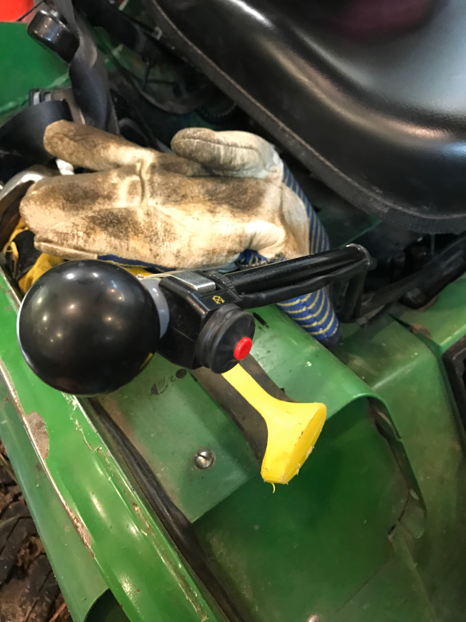

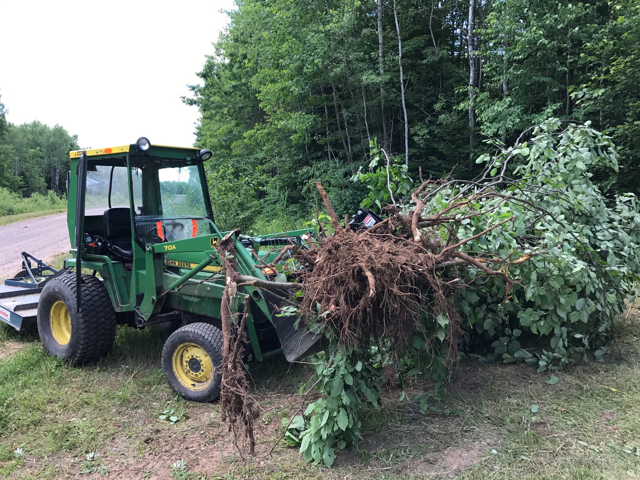

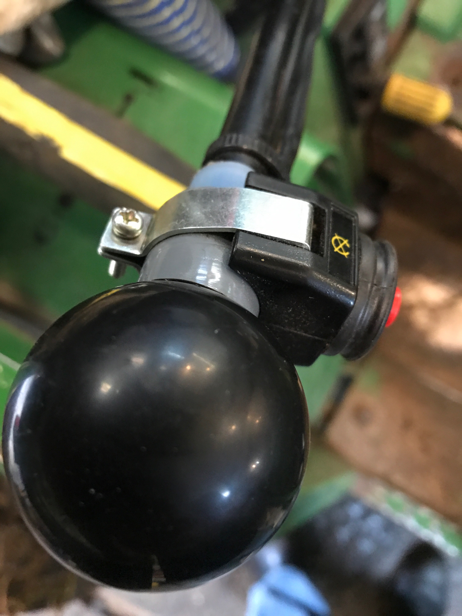

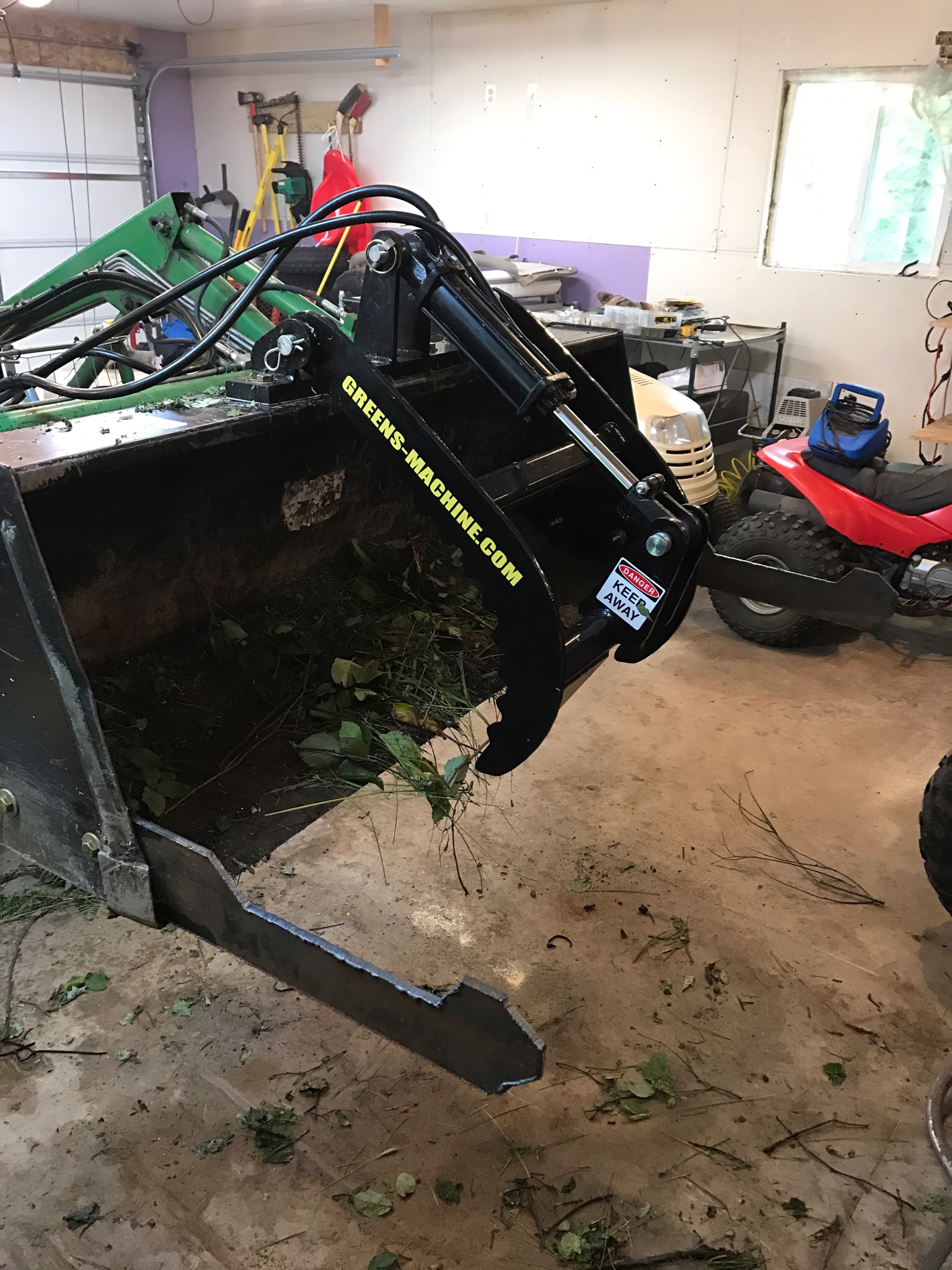

Well, I finally got it done! Used a surplus center diverted valve, KTM dirt bike waterproof kill switch, green machines 24" grapple, and custom hoses from the local John Deere dealer. Works amazing. I added some plate steel for some low cost timber teeth to hold logs. Works great and here are some pictures! Thanks for the help everyone.
