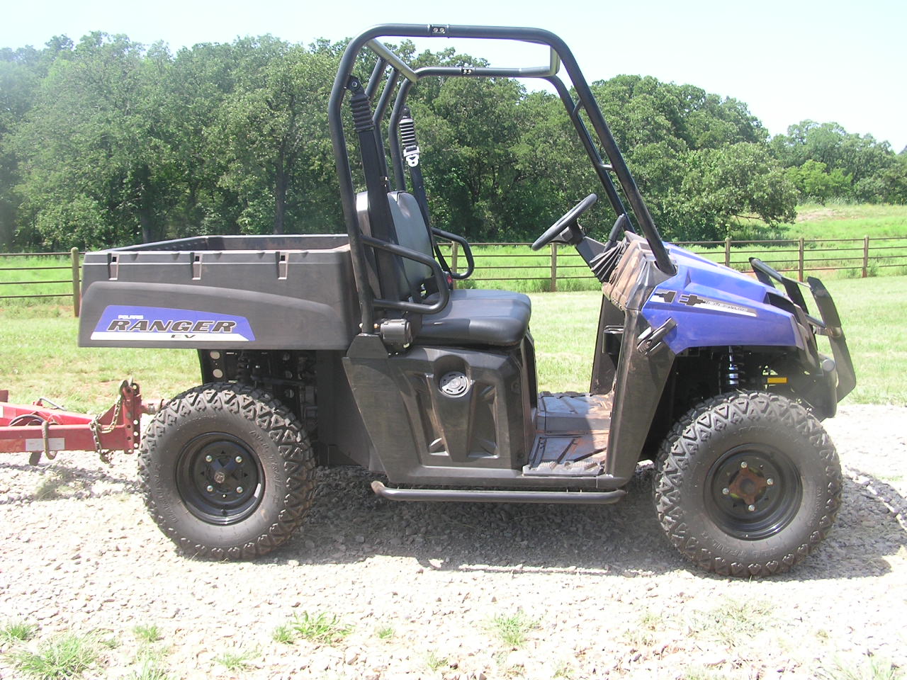

I am thinking about adding a John Deere Electric Gator to my fleet.
Can someone enlighten me as to their evolution?
I only notice that the Beds seem to have gone from Metal to what looks largely plastic on the
newer ones.
Where there other differences? Were they all 48 volt? This is of the utmost importance to me.
Have the motors and control circuits changed at all. Are some better? Some to avoid?
Thanks
Plastic beds don't rust...:)
Batteries were Trojan T-105s....new units are supposed to have Trojan T-145s
Current TE is 145 amp units...2011s were 105 amp units
The clearance is 7.3" under foot platform vs 10" in a Polaris Ranger EV
Here is a Tech Manual for the eGator http://golftechs.us/Manuals/JDegator.pdf
In our area the local Polaris Dealer wasn't interested in supporting Ranger EV which is why we went Gator TE, so that is one thing to determine if your JD AG Service Center will support your Gator TE
