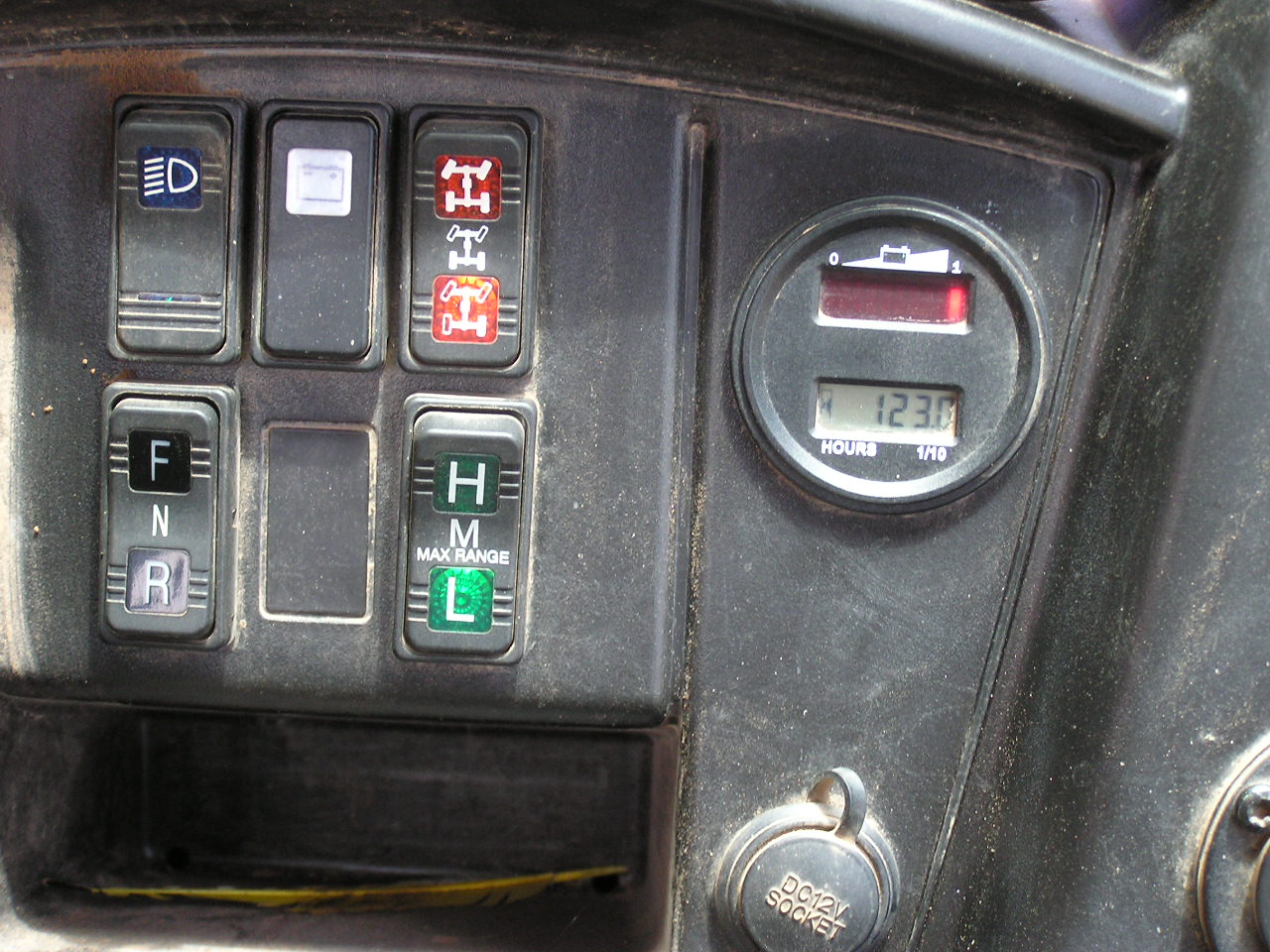

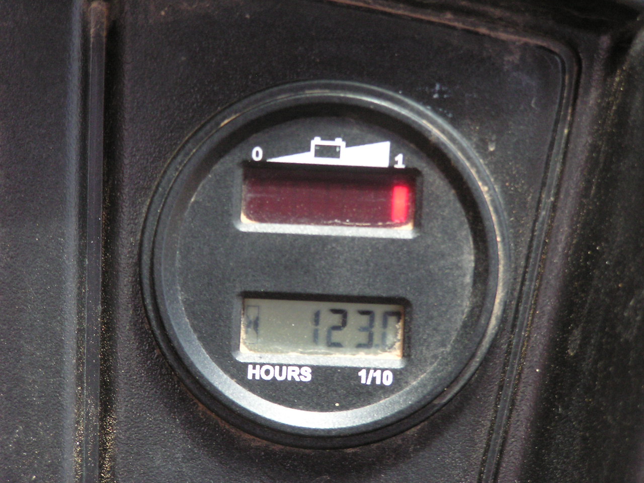

Polaris Battery Indicator
Down to 25% is deep cycling lead acid batteries and not a good idea. Better to charge at 66% .
Yep, but this battery discharge indicator on the dash is not a voltage meter and is designed as a range indicator for the deep cycle batteries. The display is 0 on the left and 1 on the right.
When the second bar from the left flashes, it is 70% discharge. I have never ran it that low.

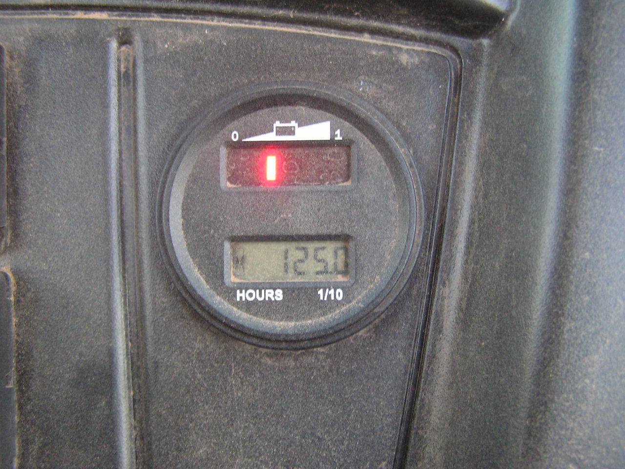

This is how the battery indicator displays power left, as power is used.
