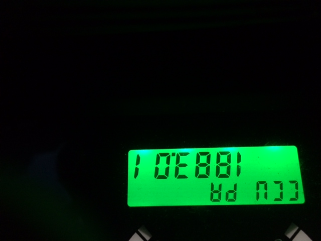

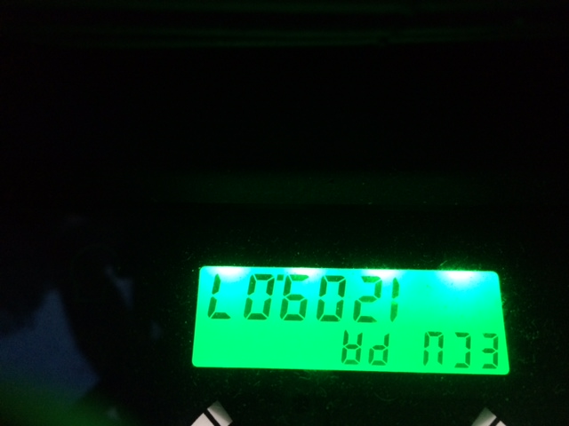

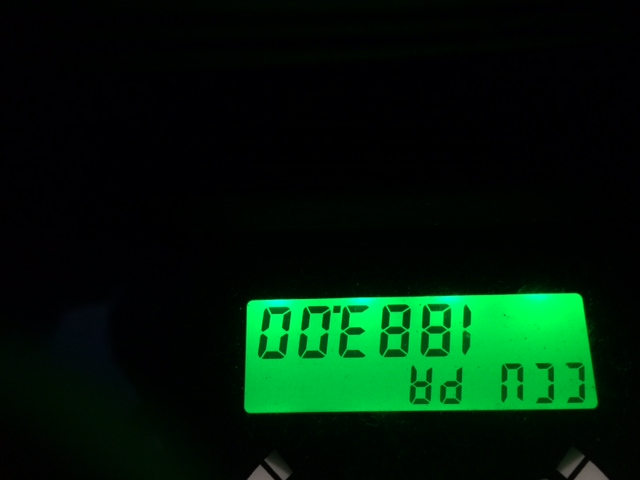

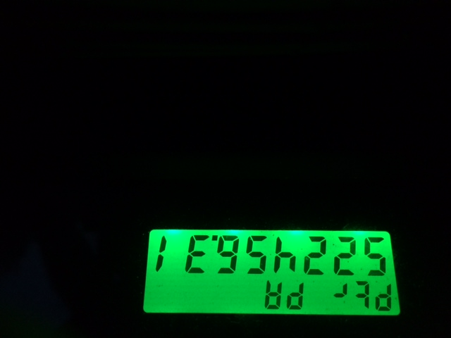

I have attached some pictures of error codes that are coming on during operation. I have a JD 5085 E 2014 model. I have not seen these error codes before but have had issues from date of purchase with error codes coming on. Anyone here know what the codes mean or have a code book that could help out? (For some odd reason when uploading the pictures, the pics are upside down)

Cell phone pictures? Usually they upload upside down.
For other JD tractors:
CCU 1883.00 rear PTO speed high
CCU 1883.01 rear PTO speed low
Bad PTO speed sensor?
third one?????
ECU 1209.07 I could not find that exact number, but 12.09.xx is exhaust temp or pressure sensors malfunction
What does your dealer say?

I called the dealer this morning and their coming out this week to check things out. Problem I have is that this has been a problem since date of purchase with error codes. On the PTO I am getting those errors without evening using the PTO. It has been one thing after the other with this brand new tractor.
