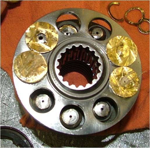

Zinc is used as an antiwear additive because it is very good and it is relatively inexpensive. Lack of zinc doesn't mean the oil is bad. If you look at Caterpillar's site, they have 2 hydraulic oils. Their standard hydraulic oil has 900 ppm zinc. Their bio hydraulic oil has no zinc - not allowed in a bio oil - but it does have other anti-wear additives. In the wear test results the bio oil is better. Also CNH Hy-Tran advertises anti-wear additives that have no zinc. They advertise their formulation as an improvement over oils containing zinc. So whether or not the oil has zinc should not determine your purchase decision. You are right, though, to look for anti-wear properties. This picture is from the rotating group of a hydro transmission from a machine that was filled with a commercial grade AW46 hydraulic oil. Pay me now or pay me later.
