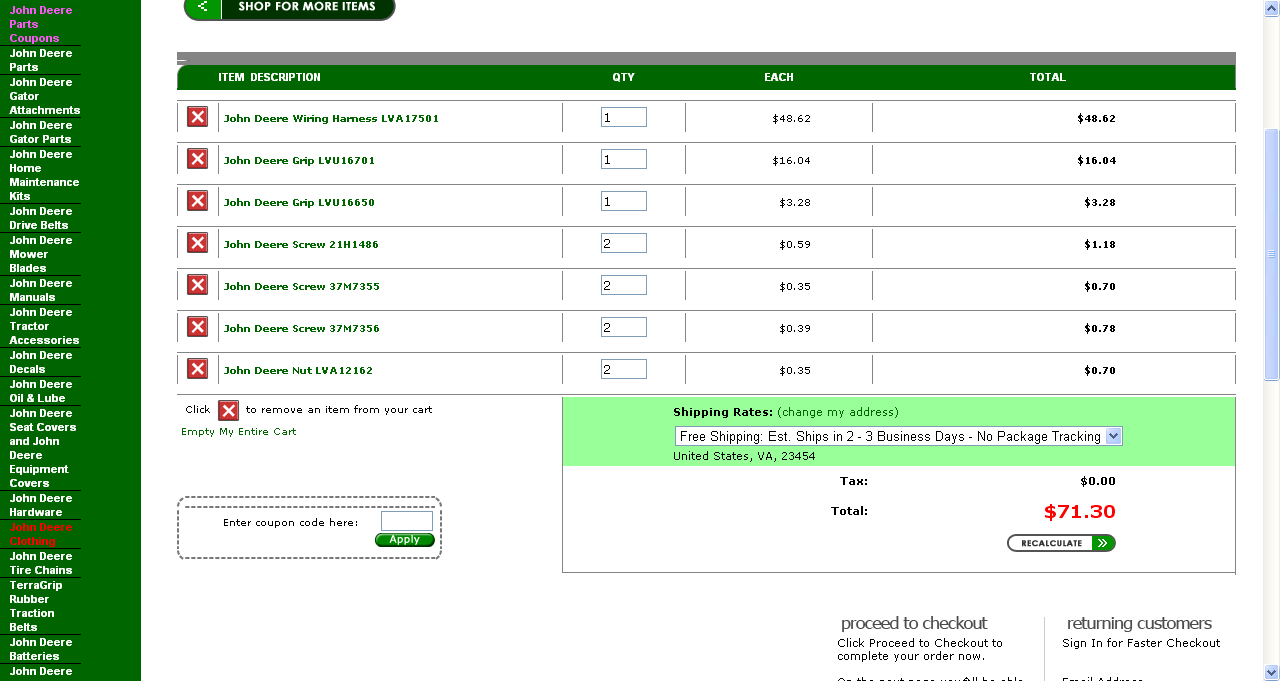

Here are all that parts that make up the handle, the prices are NOT current though:

The switches in the handle are only good for 1/10th of an amp, so the use of relays is required.
That's good info thanks for posting, I didn't see any specifications on the switch.
