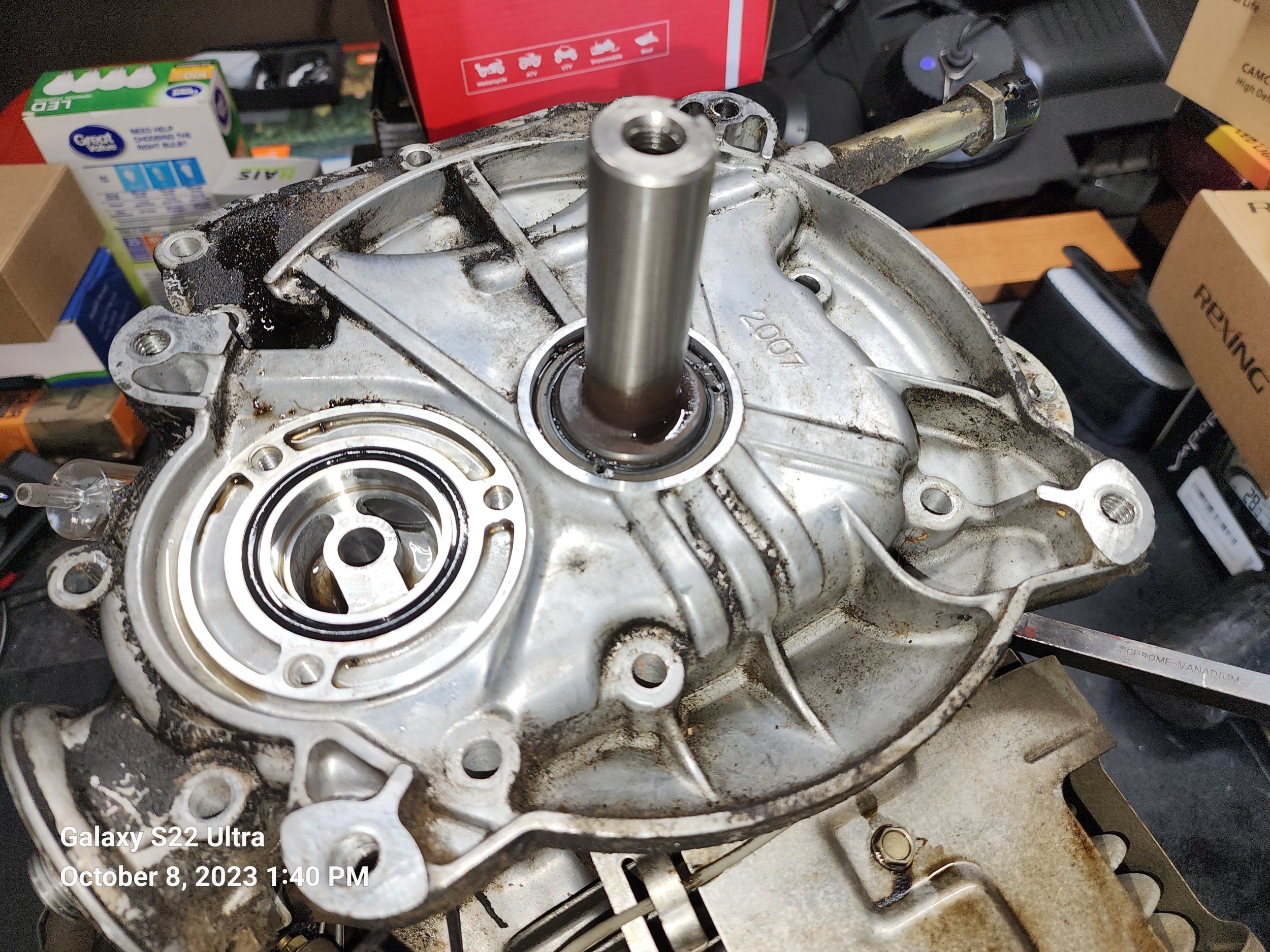

There is something really not wanting to allow the sump to lift up. I mean, I'm getting more aggressive with pretty bars than I think is wise... I'm stopping to see if you all can tell me what I'm not seeing.

My dudes... how can this toy level engine not allow me to get the dang dump to slide up. I hammered in 3 pry bars from different sides and got about an 1/4" gap and I'm telling you..... she wants to stay right there on that block.

Make sure there isn't a rust ridge at the bottom of the crankshaft between the seal area and the smaller area of the crankshaft. Doesn't take much rust to prevent the crank from sliding through the bearing surface.

Okay. How does one get a rust ridge off of the crank? It does seem that the crank is trying to hold onto the sump and crack it as we pry, beat and leverage at the sump.

sandpaper/emery paper. Course is fine.

I use the air angle grinder with 2" scotchbrite roloc discs.
