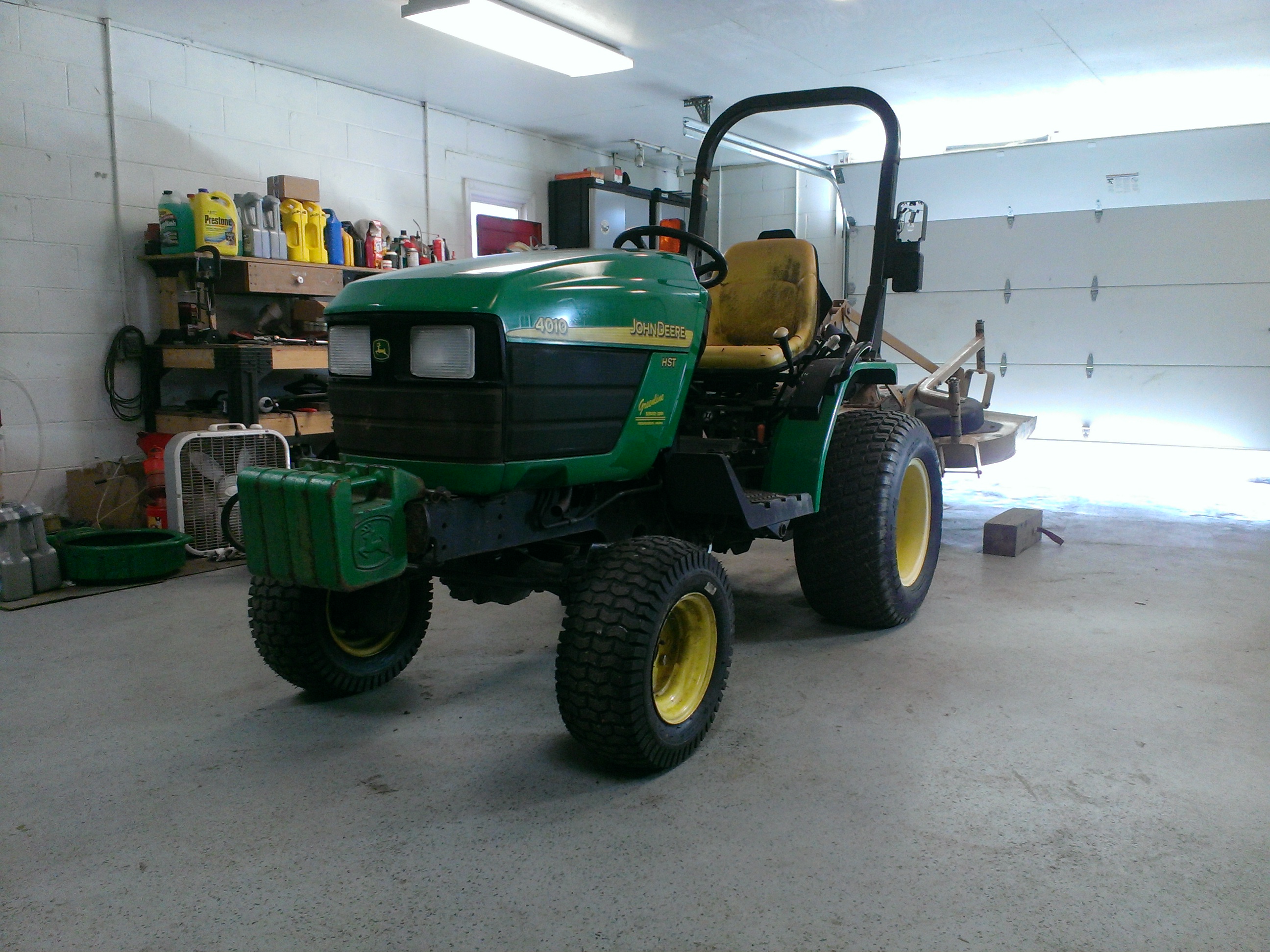

I have recently been working on a 2002 (label on engine stated 2002) JD LV 4010 HST diesel with Land Pride FDR1648 finishing mower for a friend.
The tractor had been sitting for quite some time, so he brought it to my garage and I have given it a detailed once over. So far, I have replaced the front 2 tires, greased every fitting, changed the coolant, changed the front axle oil, changed the engine oil and filter, changed the fuel filter and cleaned the sediment bowl, cleaned the batt terminals, changed the hydro filter and fluid, installed a new alt belt, changed the air filters and lubricated (silicone) everything that I could see that moved.
I am in the process of putting hard rubber wheels on the finishing mower, replacing the caster bushings, installing a new belt, installing new blades, installing 2 broken bolt/blade spacers, and greasing the spindles and every other fitting. I also want to check (and possibly replace) the gear oil.

So I got the 4010 running again yesterday and took it for a spin. It is much quieter than my Kubota. Seems to ride better as well. I like the fact that it has a tach as well. Getting onto the Kubota is easier. Still need a few more parts.
