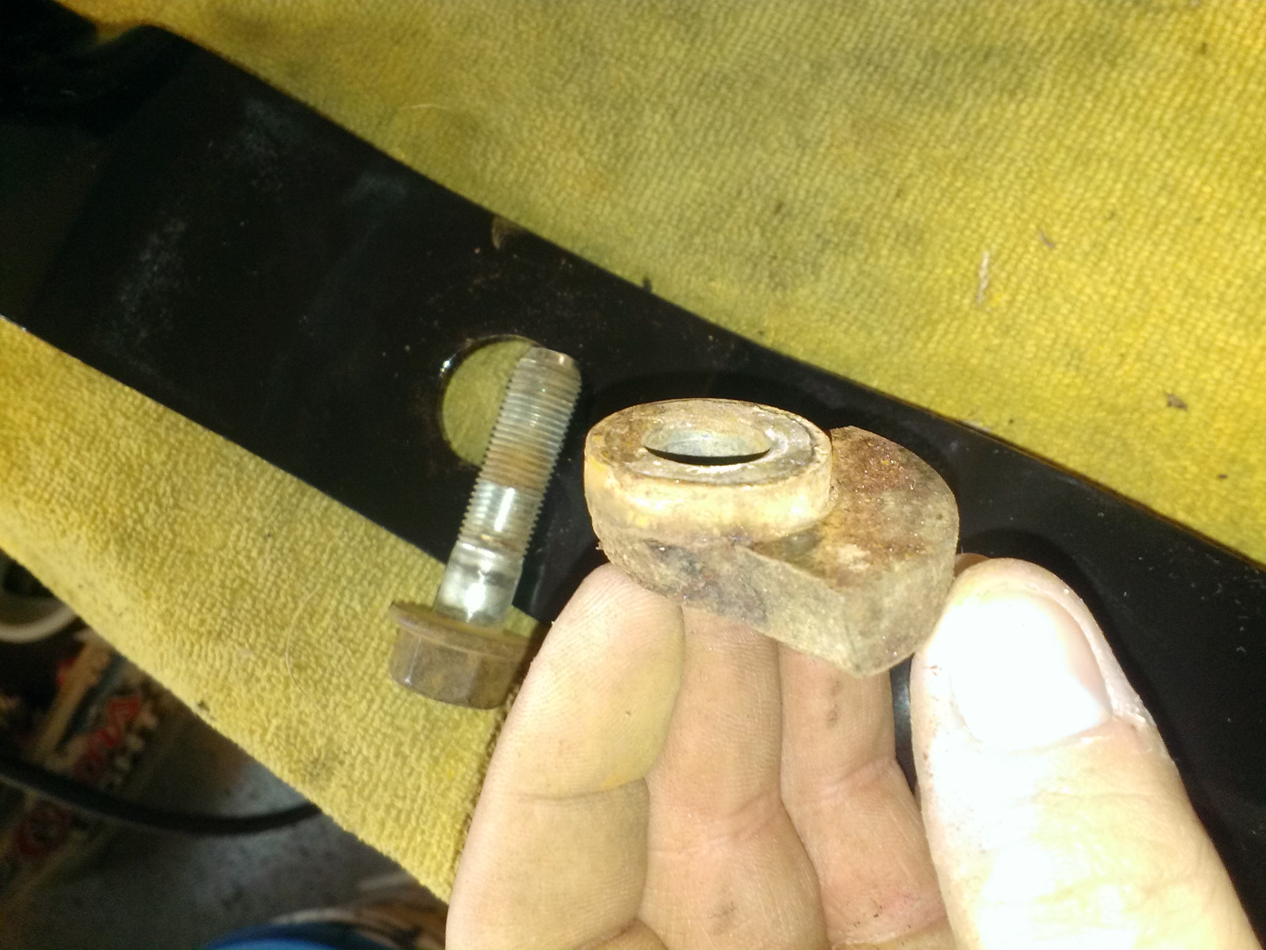

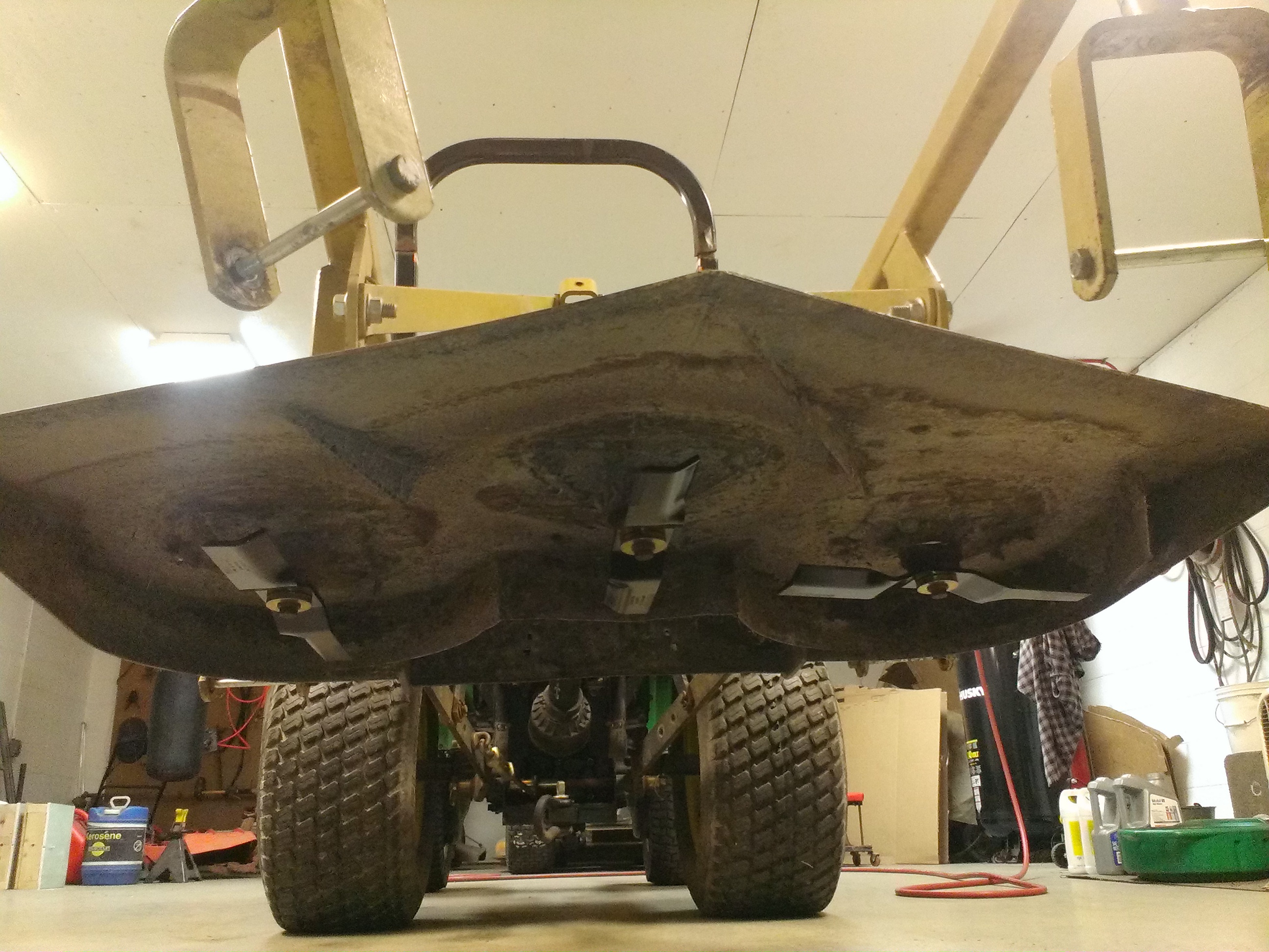

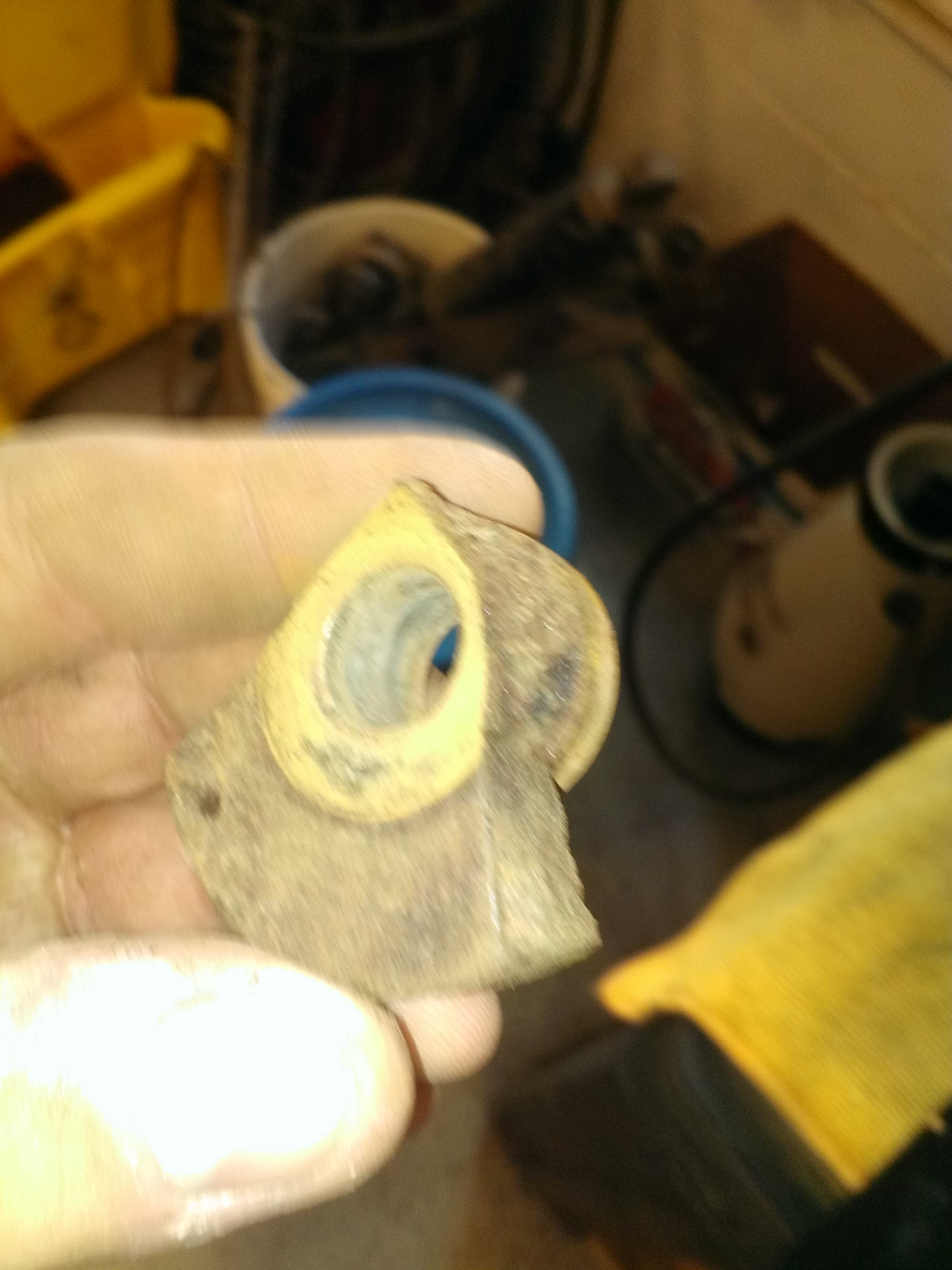

Thanks. I think he is currently under $900 on everything. Yeah...he needs a new seat and 2 amber turn lenses. Still waiting on rubber tires for the finishing mower and a broken piece on the rear lift mechanism. Tractor only has about 250 hrs on it...just a baby in my opinion. He should be good to go for many hours in the future.
