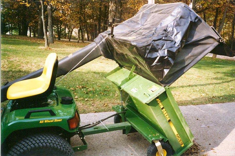

My first collection system had rear bags. When I moved up to the MC519 cart the dumping was less often and easier to do. 50 + bushels would be three dumps with the cart.
/ John Deere Material collection System Question ? #10
And less work adding the hydraulic ram to the MC519 cart.
