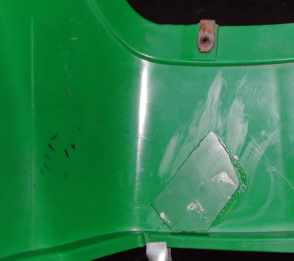

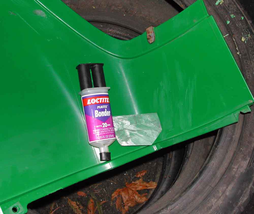

A few notes on JD green plastic body panels:
> the x55 tractors used a fiberglass plastic hood. Fixing them was easy, using fiberglass
resin and hardener just like you would fix an old boat, PWC, or Corvette. A couple
of my four 955s had broken nose pieces, which I replaced with fiberglass, rather than buying
new ones. Worked well and looked good.
> then came the 1/8th inch thick green proprietary resin plastic on the 42/43/4400 tractors.
It was used on the hood, cowl, and side panels. I repaired several cracks using the
Locktite 2-part plastic cement commonly sold, and a backup piece of the same kind of
plastic. Worked well. If you polish this plastic, don't get it hot.
> those same 42/43/4400 tractors used a 1/4" thick black plastic painted green for the
rear fenders. This stuff is very durable. Sadly, this material seems to be going away.
A trip around the massive Deere exhibit at the World Ag Expo this month showed a LOT
of the 1/8" green resin on many models.
> the one advantage all this plastic has it that it does not rust. Some folks love this
feature. I prefer steel myself.
