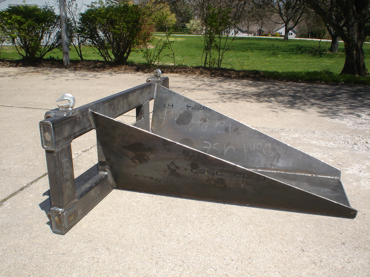

More Pictures:
Tree Scoop:
FEL Fork mounts tacked up and used as a drill guide for mounting the scoop so everything will use the same holes and make my life easier.
Brian,
Do you happen to have a picture of your Forks mounted in place of the tree scoop? I noticed in your picture that your bottom support did not have a slot in the middle, do you slide the forks on from both ends?
A picture would be great!
