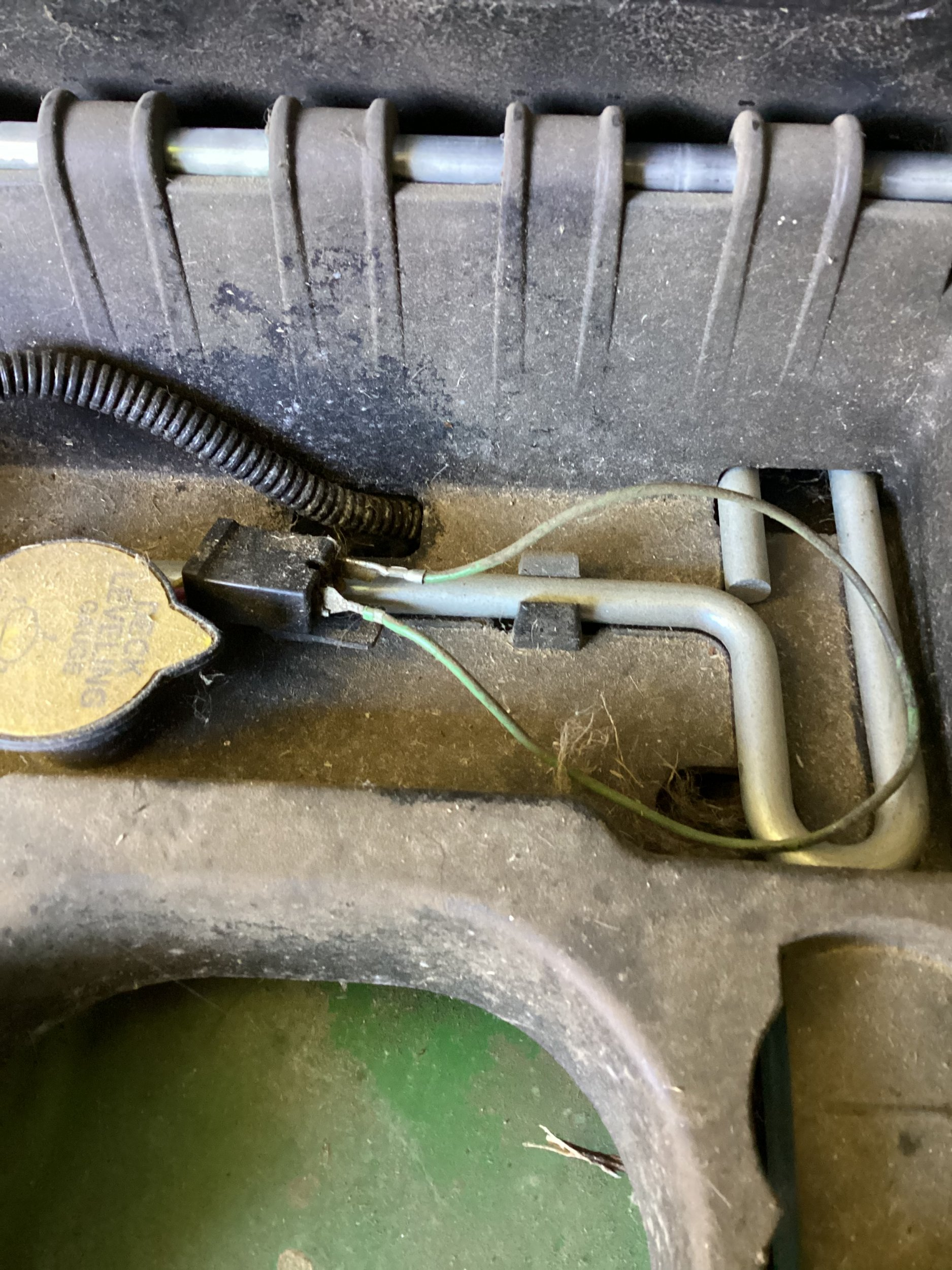

I have a John Deere X350 and when mowing on a slight slope if I lean over a little the seat switch cuts the mower clutch off. Is there any way to disable the switch or fix the problem ?
/ John Deere Seat switch #3
On my JD mower, I discovered that the seat switch is NO (Normally Open) without a rider, so when one is seated, it makes contact for the two wires that go to it. The seat has a wire connector somewhere close to the seat. I unplugged mine and inserted a small copper wire across the two contacts, in essence creating a jumper (same as what @Hughman is saying).

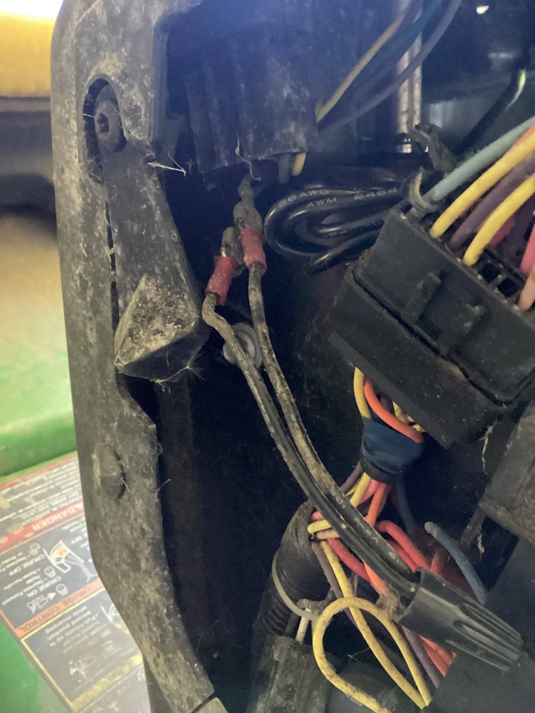

/ John Deere Seat switch #6
On my particular X300 the switch was located under the foot board of the mower body on the discharge side below the reverse pedal. When depressing the reverse pedal it pushes on the RIO switch and kills the blades. I just unbolted the switch from the frame and moved it away from the reverse pedal instead of trying to unplug it and use a jumper like on the seat switch. Because of where it’s located, plugging the switch would mean both ends of the switch would fill up with grass, dirt and water. So it made more sense to leave the switch intact and just move the switch out of the way where it would not get engaged.
/ John Deere Seat switch #7
/ John Deere Seat switch #8
RIO jumper. Blue & yellow to blade engage switch on the x500.
