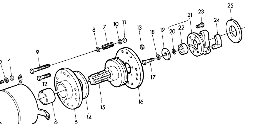

The first thing I noticed on a recently acquired baler was the lack of drive to the flywheel. I suppose that the splines on the drive plate are worn through. Is this an easy fix?

How is the slip clutch? Good or slipping?
/ John Deere square baler 219 #3
It's possible slip clutch linings(key 14) are slipping or over-running pawls(key 24) for some reason aren't engaging drive hub.

Thanks for the replies. Thankfully, I was somewhat hasty in my diagnosis and was turning the pto in the wrong direction. The baler had been out in the open for the last 4 years but I have oiled and freed most of the moving parts. How I hate those round headed screws - whatever were they thinking of?
