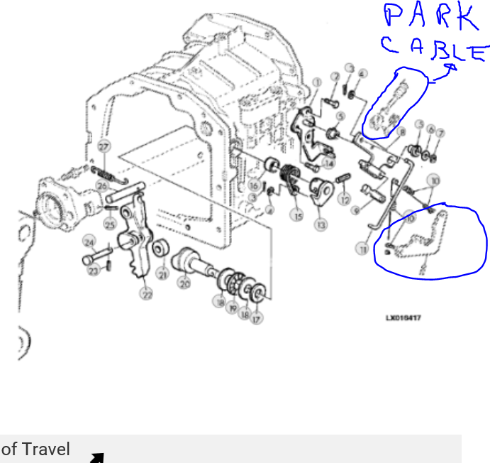

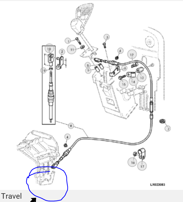

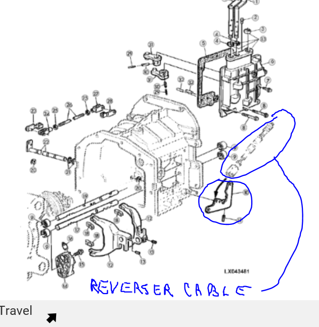

Check these drawings. Link 11 connects the two levers the cables for Reverser and Park lock connect to.
I had this straight in my head earlier and then looking at your drawings I went with what you had said. I just went and looked at it and that isn't how it is, but these drawings are a pain to use. The drawings they have and the lack of information under the parts name sucks. I used to be able to find issues pretty quickly with the old system. Same guy had issues with the syncro transmission on his 4020 a few times over the years and I could easily figure it out.
That rod (number11) doesn't connect the two at all. That rod linkage connects the parking gear cable to the parking pawl cam and rod, it connects to number 15. The reverser linkage on the side of the transmission is directly below the the lever the parking cable connects to. There is no physical link on the outside between the 2 that I see except the springs (number 10) that help pull it to N when you shift to park. Yet when you take it out of park, the springs do move and the reverser lever on the side of the transmission should be able to move and it won't.
Which leads me to believe it might be something inside the transmission. The shaft that the lever is mounted to that has both the parking cable and that linkage seems to be turning, but nothing is releasing the reverser. I was under the tractor and couldn't get it to move at all by hand.
It's hard because not only do they not label things any more, the drawings should show both cables, but they only show one. The exploded views are hard to follow.

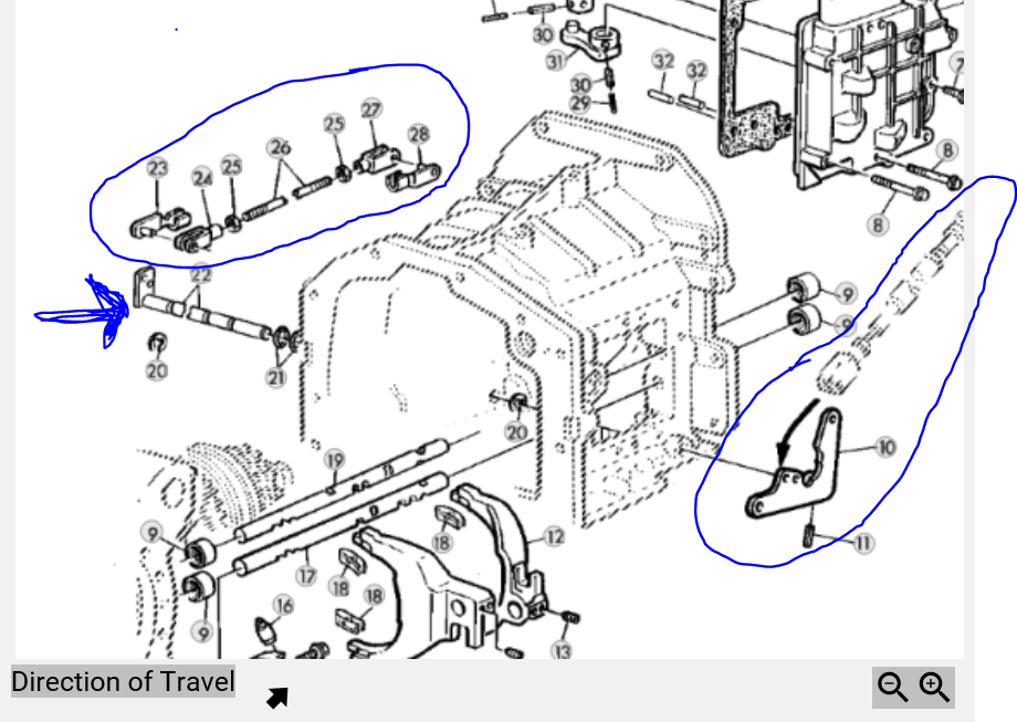

Does lever key 10 connect to the reverser cable?
It looks like lever 10 is on shaft 22. Then on the left side, shaft 22 has a link, parts 23-28. I think this link goes to the reverser control valve.
Maybe disconnect the link and see if reverser lever moves shaft 22.
If that moves, see if the control valve it connects to moves. If it will not move, Maybe problem is in the control valve?

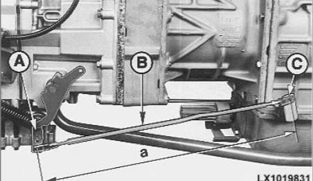

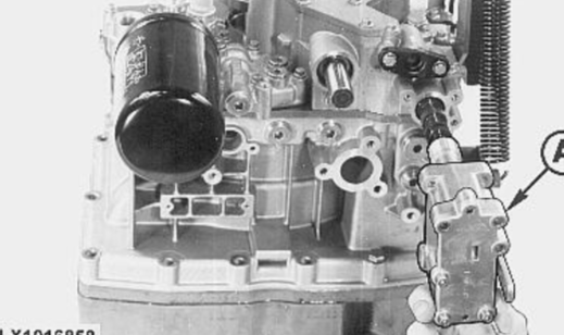

Sounds like you have some binding linkage or a cable. I would start by disconnecting linkage from the reverser valve assembly under front of transmission. With linkage unhooked, see if lever on valve moves freely by hand. reverser6605.PNG If so, then move back to rear of that linkage. It connects to a lever / shaft assembly that goes through transmission to the other side.reversershaft.PNG Disconnect linkage on other side and see if that shaft going through transmission turns freely. I have seen a few of these bind in this area. If it is stiff to turn, you need to spray penetrating oil on both sides and keep working it until it frees up. If everything there is free. then most likely the cable is tight and needs replaced or the reverser shift lever itself is binding or has worn parts.
