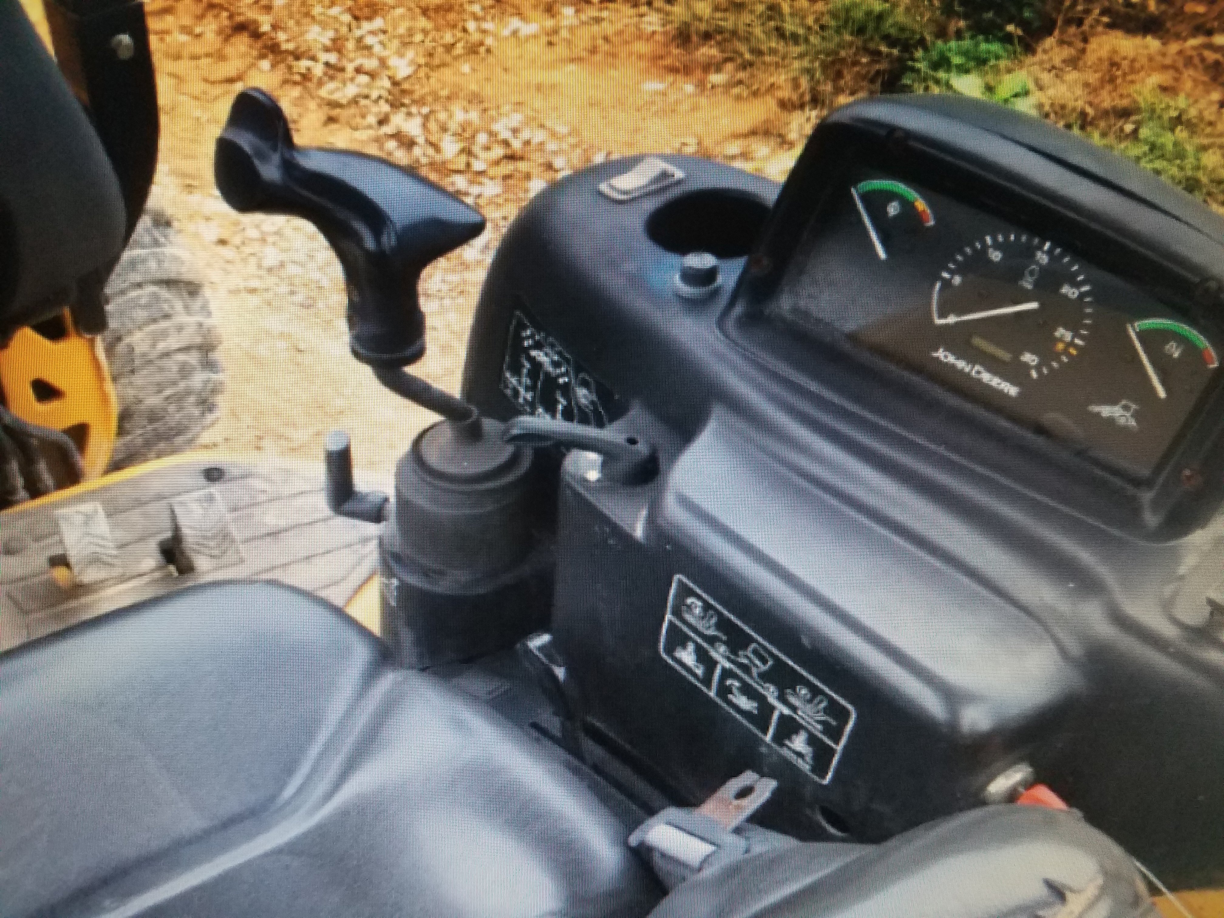

Ok...checked out the tractor this morning and this unit did not come with a horn. It has a back alarm, but no front horn. I don't even see a possible location (knockout) for the button. After more thought, a horn might have some need. Operating in a construction zone with lots of workers around could be a safety concern. Moving a pallet of materials with the bucket in the air could impair line of sight. The list could go on and on. Horn is an improvement!

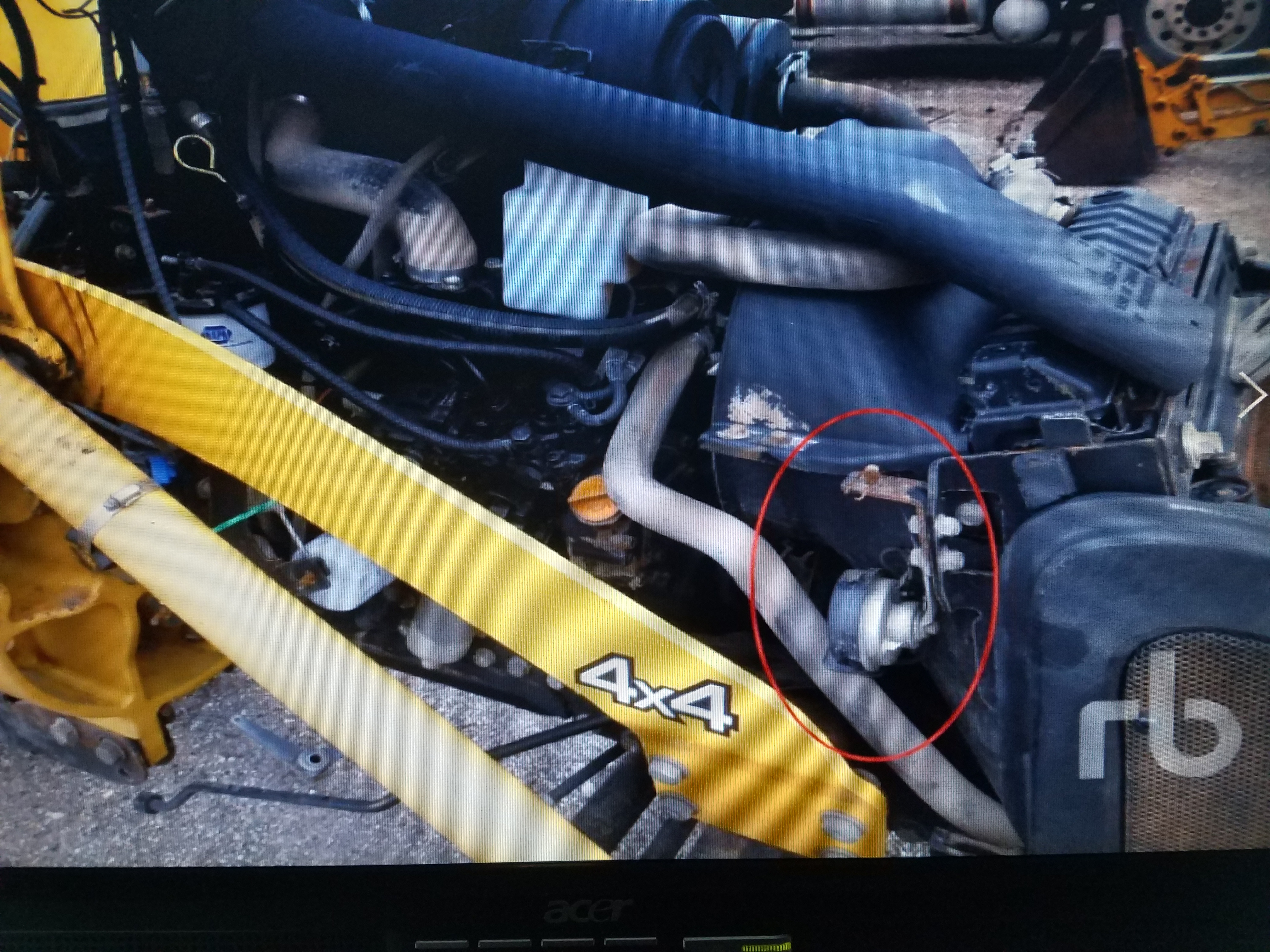

Here are a few pic of the horn button and horn location

Your issue with the power plug connection for the horn should not be to hard to overcome. I have two possible electrical schematics from the 110 tech manual. One schematic breaks at serial number 311032 and down. The other breaks at 311033 and up. Looks like different connector clips for the different serial number breaks. Also these schematics show other plug-in connectors that are within the same electrical loom. That being said, the horn connector splices in with the loom and draws power as all other connectors do off the same loom regardless of the different style connectors. The different style connectors will be do to the serial number break. I am new to the site so not yet up and running on scan and post, but will work on it if it will help.
   / John Deere tlb 110 #48
If the connector at the tractor loom is the same as the one in the horn kit loom...then I would say (by the electrical schematic) that the tractor loom connector is a power and ground source (most likely for the horn). Check for power with a test light and if there's power...plug in your horn connector!
   / John Deere tlb 110 #49
Also, power is being sent to the horn connector (and other items) through fuse "F8" which should be the top horizontal fuse in the box. You can test the tractor connector for power and then pull the F8 fuse and retest as there should not be power.
