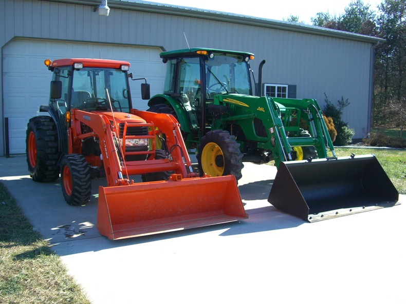

I think you ought to see one in person Tommy. I just can't see JD putting out something that is exceptionally weak. I'm not saying it would be impossible, but with the Kubota RTV900 being as strong as it is, I can't see JD coming out with something that is a step down from the existing HPX units. For example, here is a pic of two tractors I now own. Although the JD is bigger, neither are what I'd consider weak by any stretch of the imagination.
