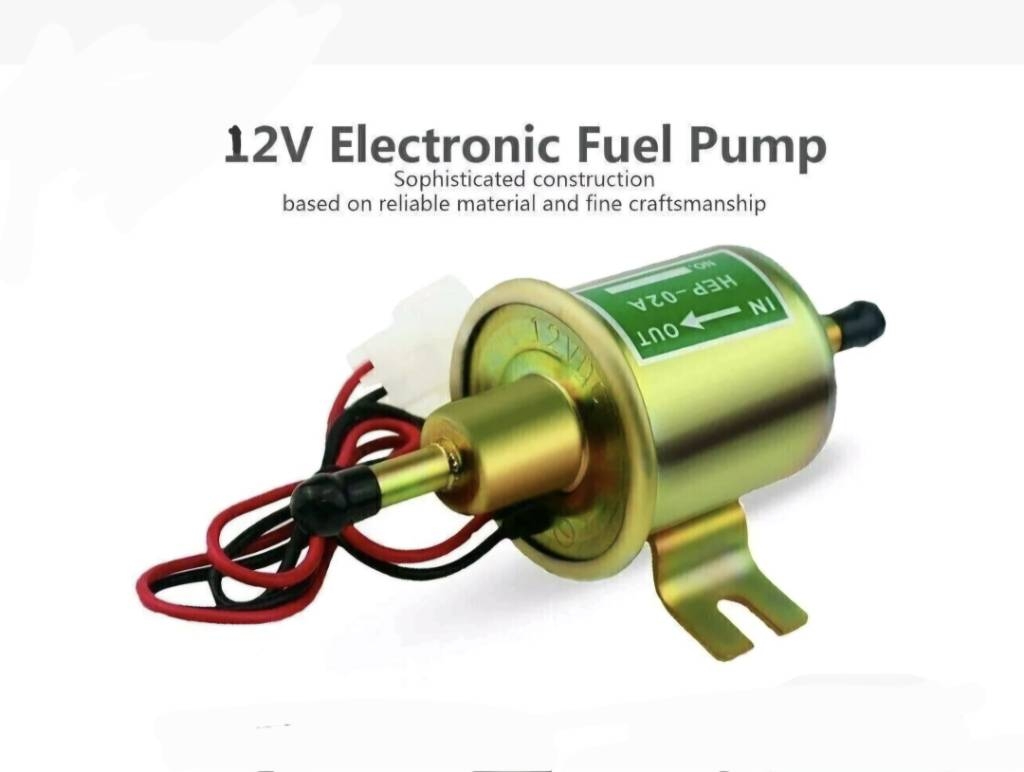

On ebay you can order these universal 12V fuel pumps for $10. I'd get one and several feet of 5/16" fuel hose. Add a few feet of wire to the two pump leads with clips on end.
Get a 1 or 2 gallon gas can (new or 100% clean). Zip tie or mount (away from heat ), fuel hose in...to pump in...hose out run directly to carburetor. Plug & clamp removed hose line.
Connect pump leads directly to battery (red+, black--).
See how it runs now.
If it still cuts off you've eliminated fuel, so reconnect original fuel line.

Ebay pump...
   / John Deere ZTrak runs, then dies #15
Have 1 of those on my ztr, Original vacuum pump seems seemed be struggling keeping fuel to carb. Replaced with another vacuum pump, not much change. Put this 12 volt pump on and problem went away. Tied hot to wire to carb solenoid cutoff so when key shutoff fuel flow stopped. Been using this for 6 years with 100% reliability
