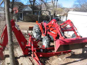

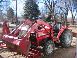

Did you guys have to get a "skid steer universal hook" to make it fit on your rigs?
Markham only makes the grapples and buckets three way's, plain back(no attachments at all-buyer must weld on something), the JDQA, (John Deere Quick-Attach), and the SSL QA (skid steer loader quick attach, also called "bobtach")
I am going to assume your bucket is pinned onto your loader arms and you have no means of quickly detaching it? If so, then you would need to convert your loader to the SSLQA setup for a price of 300$ to $700 or so.
Your other option is to but the plain version and weld bushings on it yourself so you could pin it to your loader.

I am posting a couple of pictures of my tractor, what do you think the best option would to pusue?

How much do you want to spend?
Grapple=1000
QA setup=1000
Hydraulics=500
Can you weld and fabricate steel?
