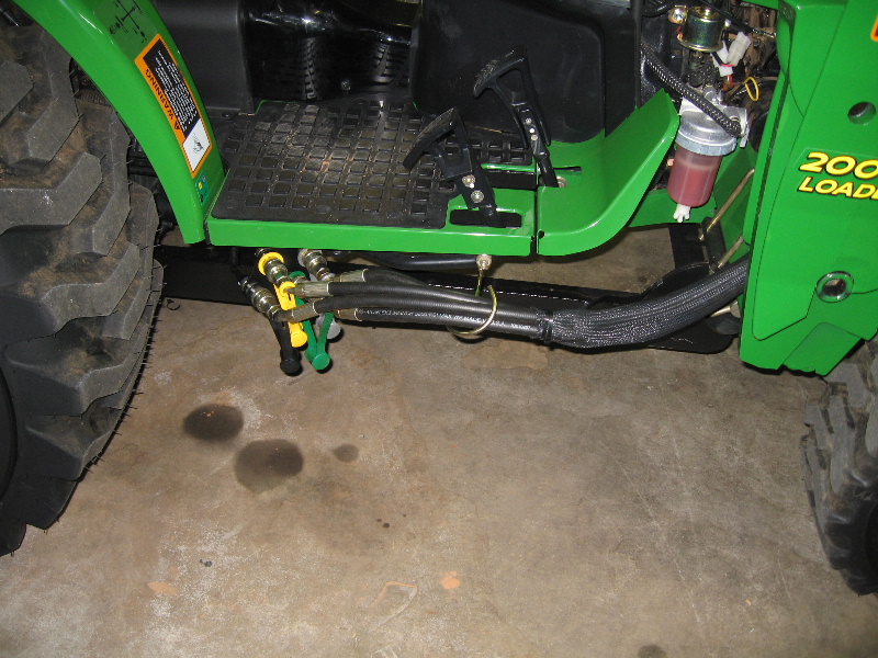

Nice looking rig, but why/who routed the hydraulic hoses below the right step and sticking out right in front of rear tire like that? You may want to rethink that set up.
Good eye - and you are correct
Should be tucked in much more -
   / Johnny D got a little work out today
#12

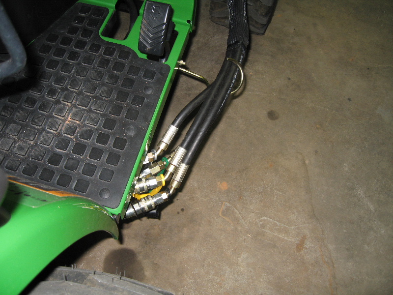

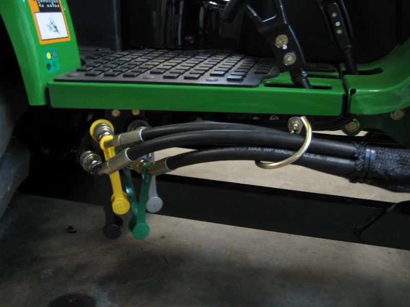

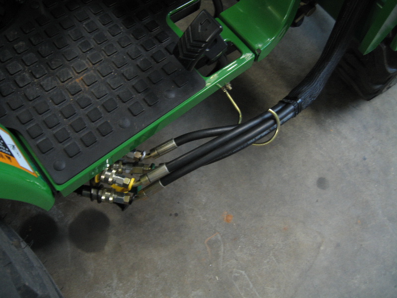

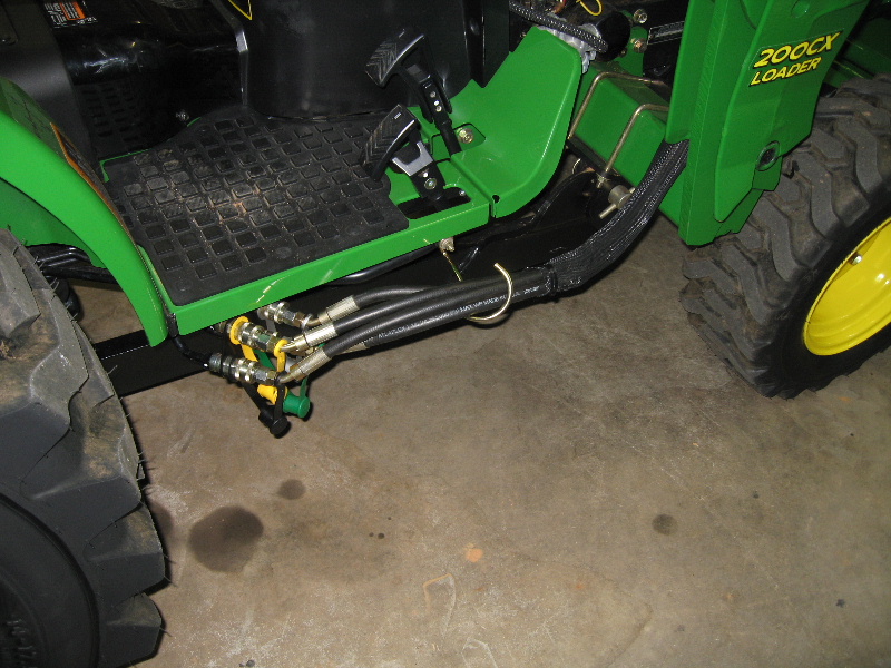

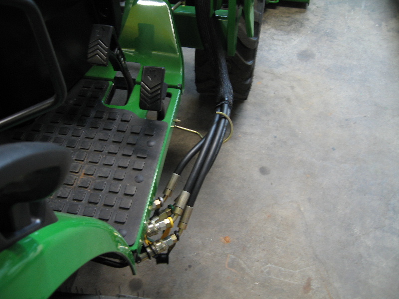

Well , after yall gave me a hard time about my loader hoses being twisted backwards. . I fixed it.:) i knew it was not right.
the guy that put that mess together must have been a moron.....:mad:
all the 45 degree ends were put on to face away from the tractor.:rolleyes:

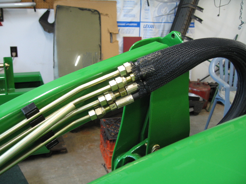

I took all the loader hoses off , i dont mean unhooked. i mean i unbolted them . took them off out of the weave. stratened them all up . put them in the right order. and put the weave back on. and reinstalled everything. it was alot of work...:( But now there nice and strate running perfect right beside the floor boards. and hoses are nice and even. :) I am pretty **** about things. if its not perfect , it ant worth doing...:rolleyes:
here is the pics of the hoses fixed . i pulled the weave back a little on the top of the loader. i wanted to be able to see the fittings. if i ever had a leak.
tell me if it looks right now. :)

Ahh--much nicer looking. And from another **** retentive person--I always connected the plastic caps above the hoses so that they wouldn't get snagged on stuff while bushogging etc. Figured that sooner or later one would get wrapped in a vine or something and get ripped off.

That sounds like a good idea....:)
