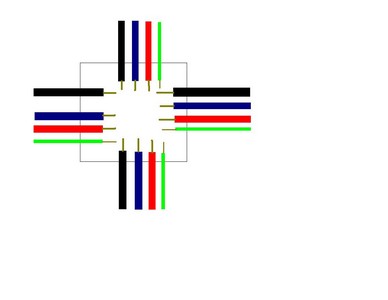

I'm planing the wiring layout for my barn. I need to run 8 gauge wire to 3 different locations with the wire run to the closest point being 80' from the breaker panel. I'd like all 3 points to be on the same circuit since I will only be drawing from one point at a time. In order to keep the wire length as short as possible, it looks like I will need to join (4) 8 gauge wires together. Since it is a 240v circuit that will put 3 sets of these in the same box along with the ground wire. The complicating factor is that this connection will be 20' up in the air near the roof. I really do not want to go the solder and tape route if there is another choice. I was hoping there would be some kind of box with a bus bar that could be used to do this. See diagram - each color gets connected together and each of the wires will run to the 4 corners. Any ideas or suggestions?
The alternative is to make each location it's own circuit and run lots of wire.

From what I have observed most are doing the "home run" route. I am sure it is possible but may not be code as there is the "potential" to overload the feed if all three branches are used at once. If you ran the feed to a fuse box with separate fuses for all the branches then you might meet code. That however might exceed the cost of how you are trying to do it. There are plenty of mechanical connectors available to do what you want to do.

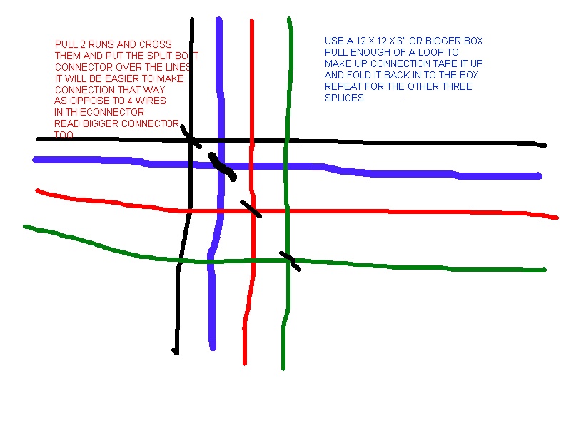

Don't pull 4 runs pull straight through and over lap the wires like my crude dwg and put split bolt across the junction tape up correctly and fold in to the box.
tom

Tommu, nice drawing, i don't do them yet. Correct idea about the joints, be careful about the bottom of the bolts cutting the tape, we use Vc and or rubber for a perfect fit and insulation.

I actually use scotch 2510 Cambic and 3m 2210 mastic the +33 over it all
