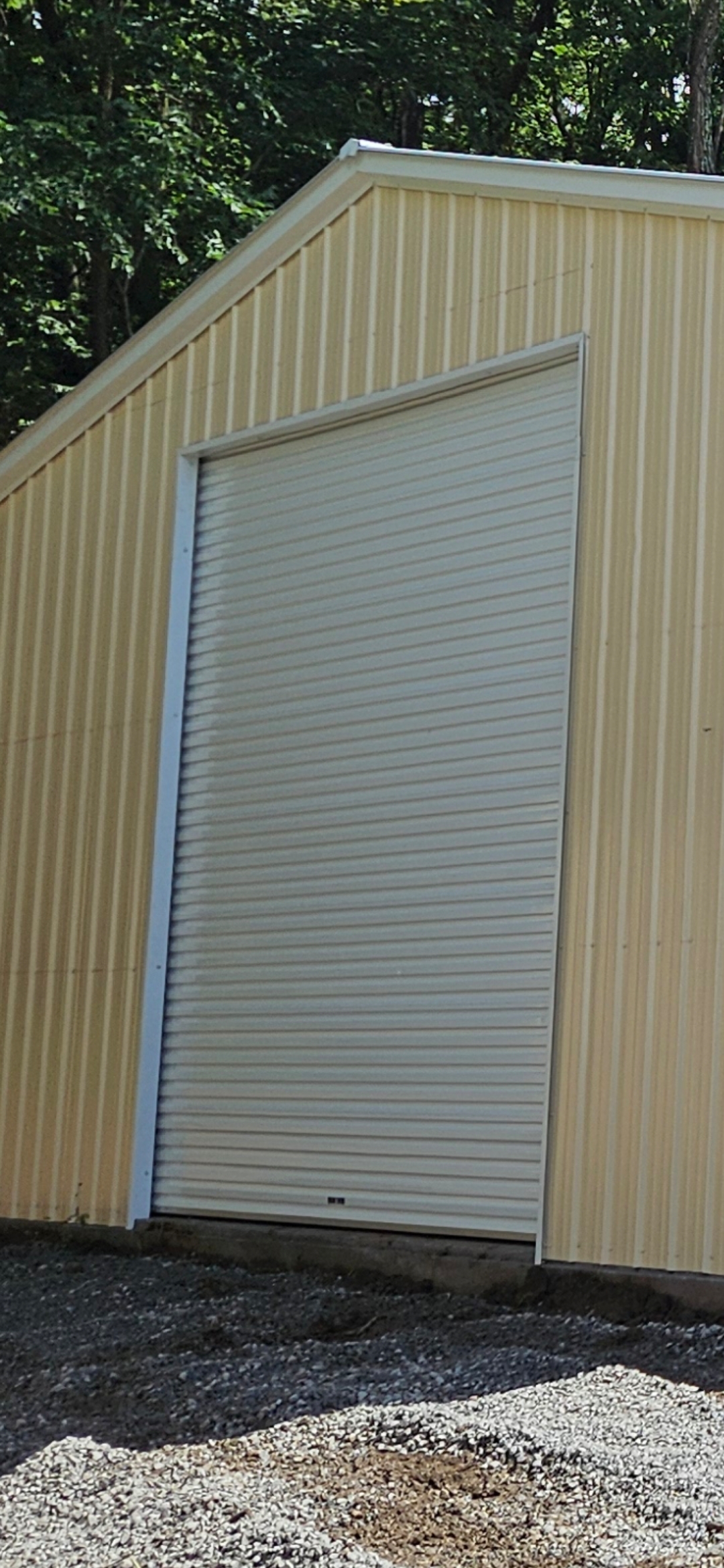

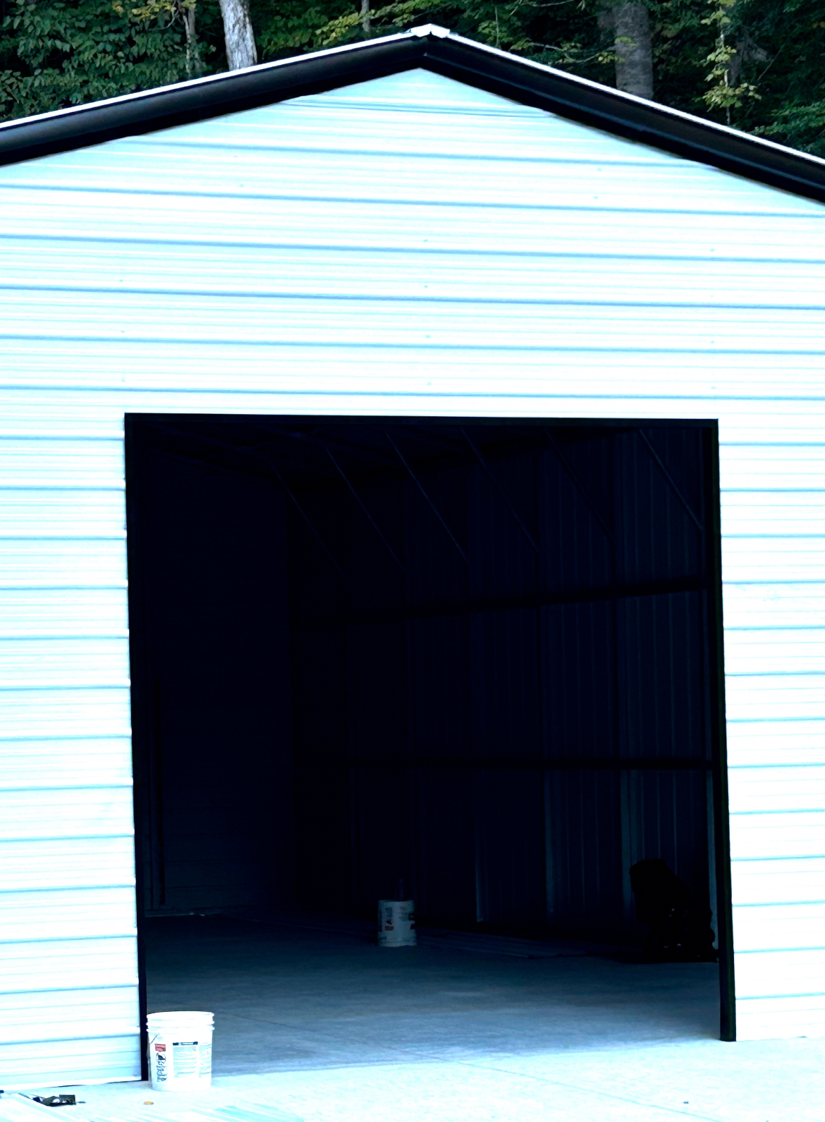

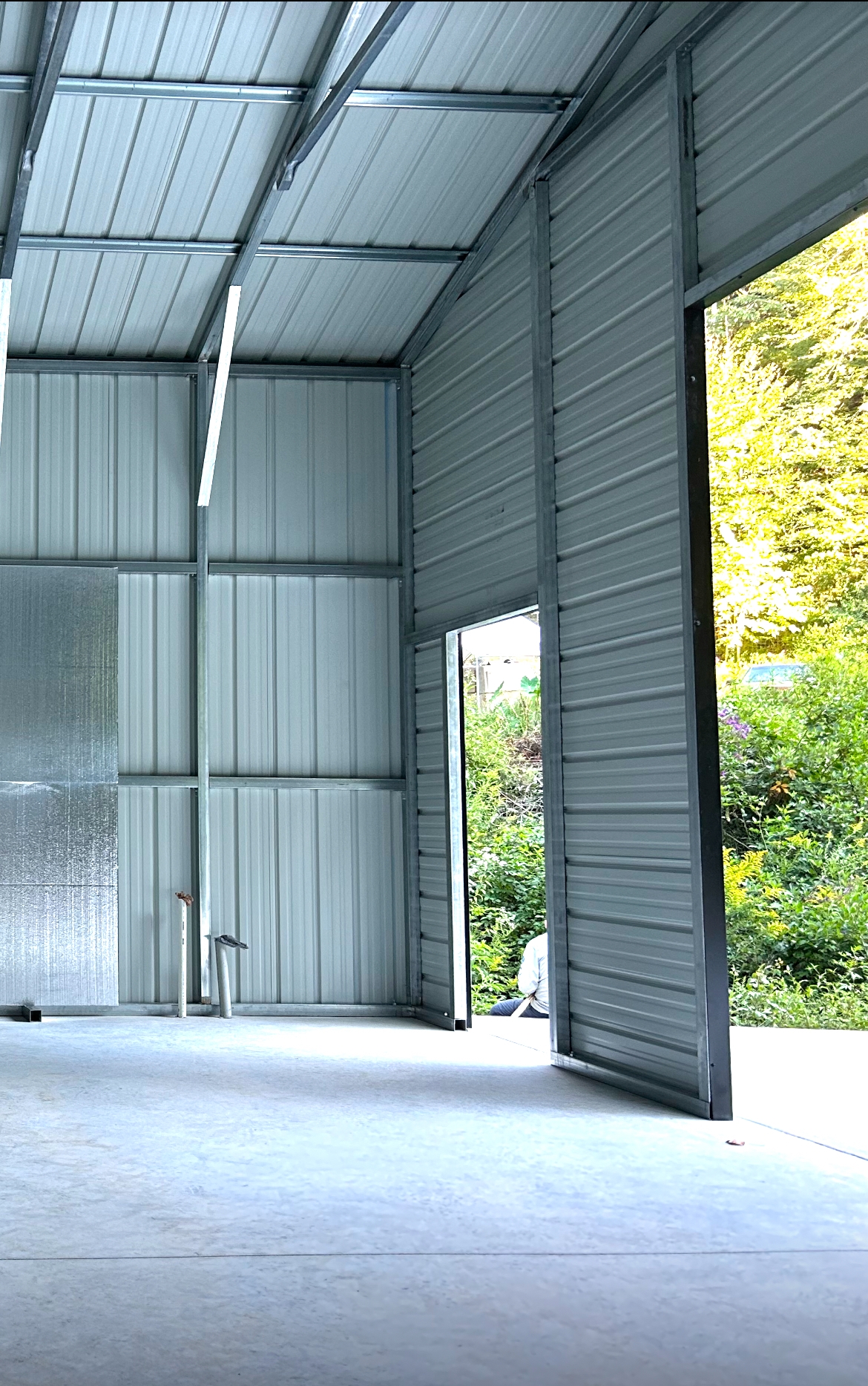

Here is some pictures i have of the inside and outside. I can get better ones if needed.

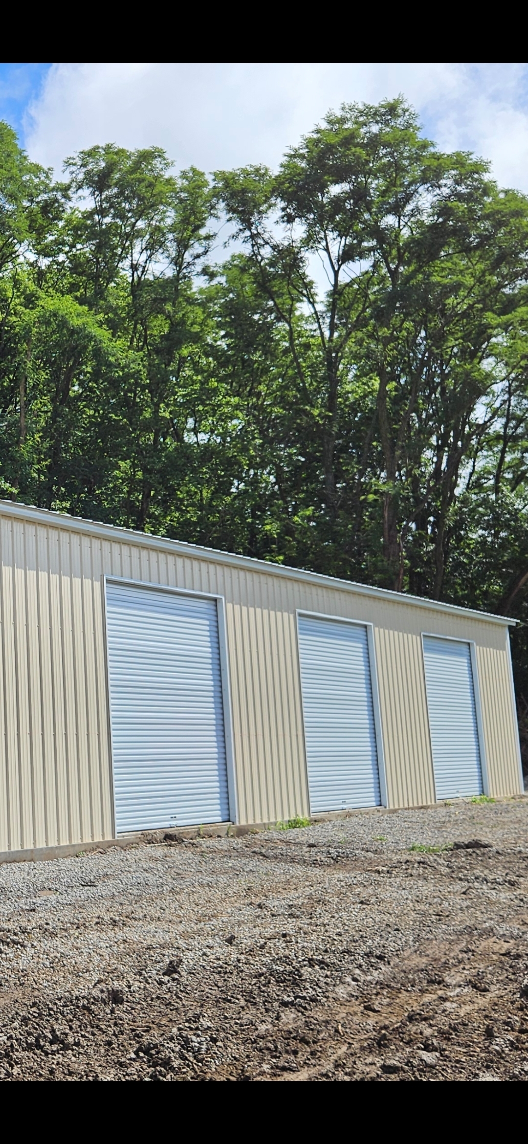

Are doors going to be roll up doors? Just did a similar building. Doors included and all were trimed out in metal. 3 roll up doors and one larger metal chain roll up.
   / Joining a "trim board" to a “stud”? #15
JK96 is correct. The exterior trim should be metal whether the door is a roll up or a track
overhead door.

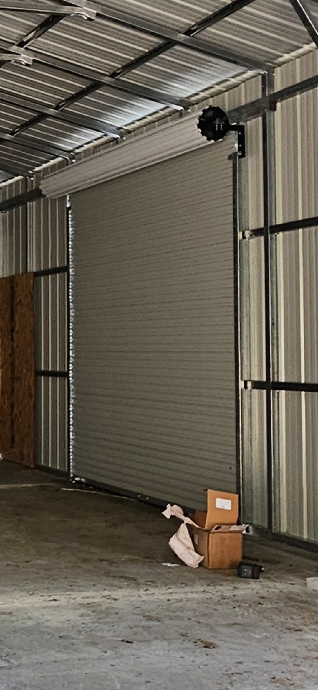

Thanks for the pics -- that helps! Most of my previous suggestions don't apply now that I see it. You're already trimmed out on the outside and door jamb side.
Seems to me that you'll want to put horizontal stringers/"nailers" (wood or metal) in your "studspace" every couple feet if you're still wanting to attach wood 2x12s. That would let you screw or bolt right through the face of them and attach it to the metal framing.
Same with over the door. Need to put something in the wall space that's fastened solid and attach your wood directly to that. The ends can still sit on the uprights.
Your interior is so neat and clean looking, I'd check with the metal building guys to see if they have a suggested approach. Do you have any metal "stud" or framing material left over that you can use as blocking? Might be easiest to attach metal to metal. I bet the metal building guys have a way to install an OH door without using a lot of wood framing.
