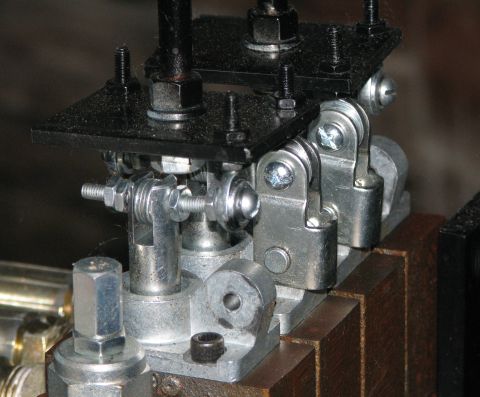

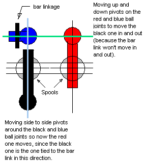

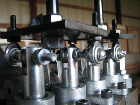

Have you thought of making the bracket to modify the valve you have now? The valves can usually be setup both ways. I would think with a little work you could modify cheaper than buying another valve, of course this depends on the tools you have to work with.
   / joystick conversion #7
I have added two post here, and they disappeared .
WOW, thanks for all the good info. I especially like the idea of modifying what I already have., like AndyF suggested, Can anyone share more of how that is done?
   / joystick conversion #9
One of the guys on here made his own joystick setup. Here are some pictures.
