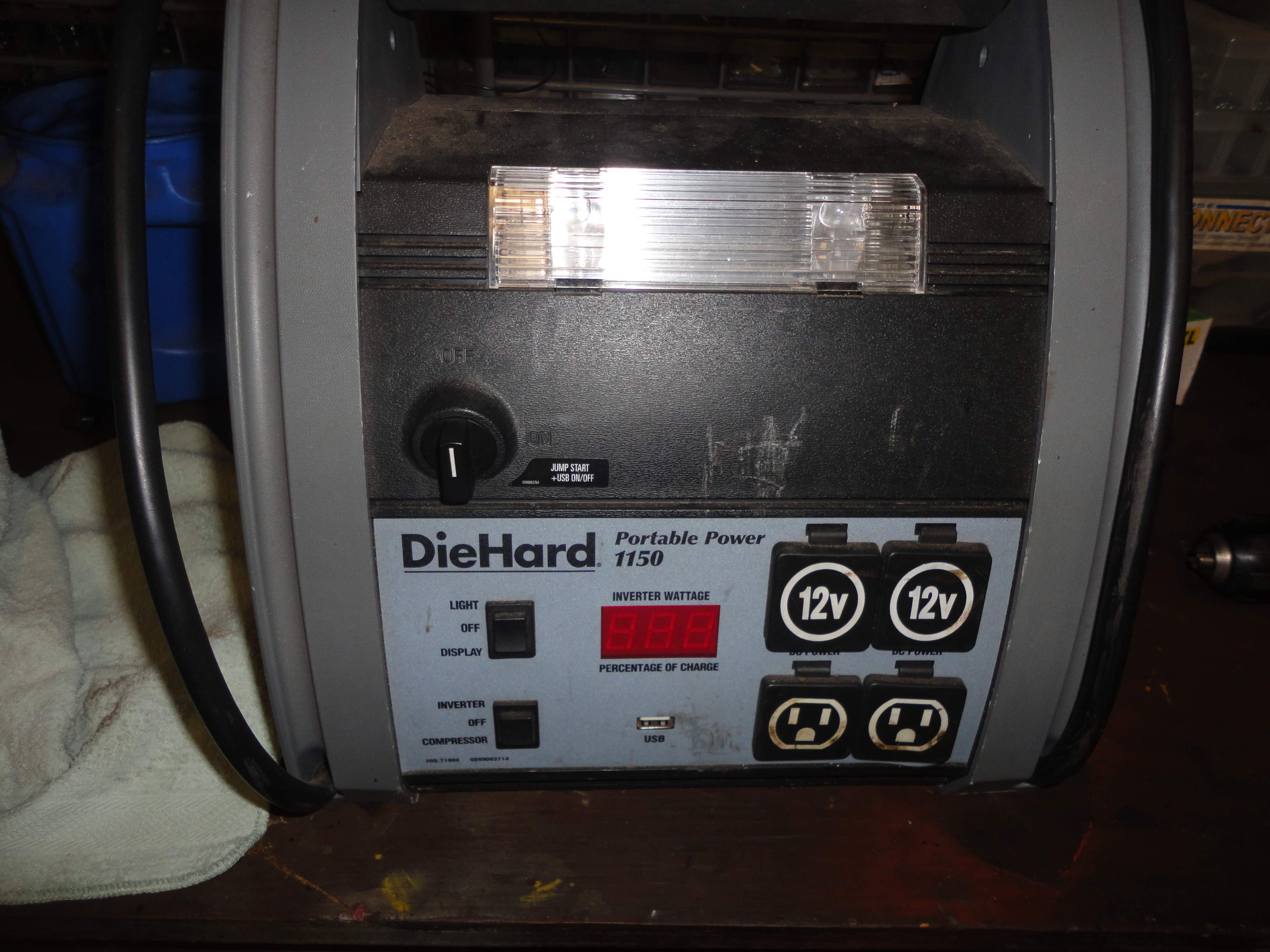

Gary here is what i have and it has worked great for us. this one is about 3 years old i have used it to start big truck's in winter. not sure how well the compressor works have never used it, probably slow. DSC00506.jpg got it at sears
