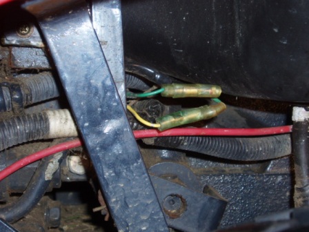

Junk was using a paper clip the same way that I would use a short piece of electrical wire. Strip about a half inch of wire off of each end. Unplug the connector that is on the pto lever. It should have two female electrical ends in the connector that you unplugged. Stick one end of the wire in each female connector. See if it starts. If it don't, replug it and try the same thing on the seat switch.

Jerry, there is no single connector, per se. The attached picture shows the wires from the PTO switch (toggle). Where would the jump wire attach to this connection? Thanks...I appreciate your patience!

The green and the yellow goes to the same switch don't they? If they do that would be the ones. I thought that they had changed them to a single plug, but I see now that they haven't.

Yes, the green and yellow both go to the PTO switch. If you look closely, the bottom wire has a green wire coming in, then yellow up to the switch. It doesn't show in the picture, but the top wire has white coming in, then green up to the switch. Forgive my lack of knowledge, but where specifically should the jump wire go (between what and what)?

Unplug both wires. Then stick the wire you made into the ends on the tractor side.

Well, it appears the problem is not with the PTO switch. Bypassing the switch as you suggested has no effect. I didn't try bypassing the seat because I don't have to be seated to start the tractor, although it will shut off if I get off the tractor without putting it in neutral.
So I'm left to believe that it's the neutral / hi / lo range selector switch at fault. Now that I do a little digging, THAT is the switch that went out before. Now it does have a knarly, almost unreachable connector on it. I assume it's the same gig as before to try to bypass it?
