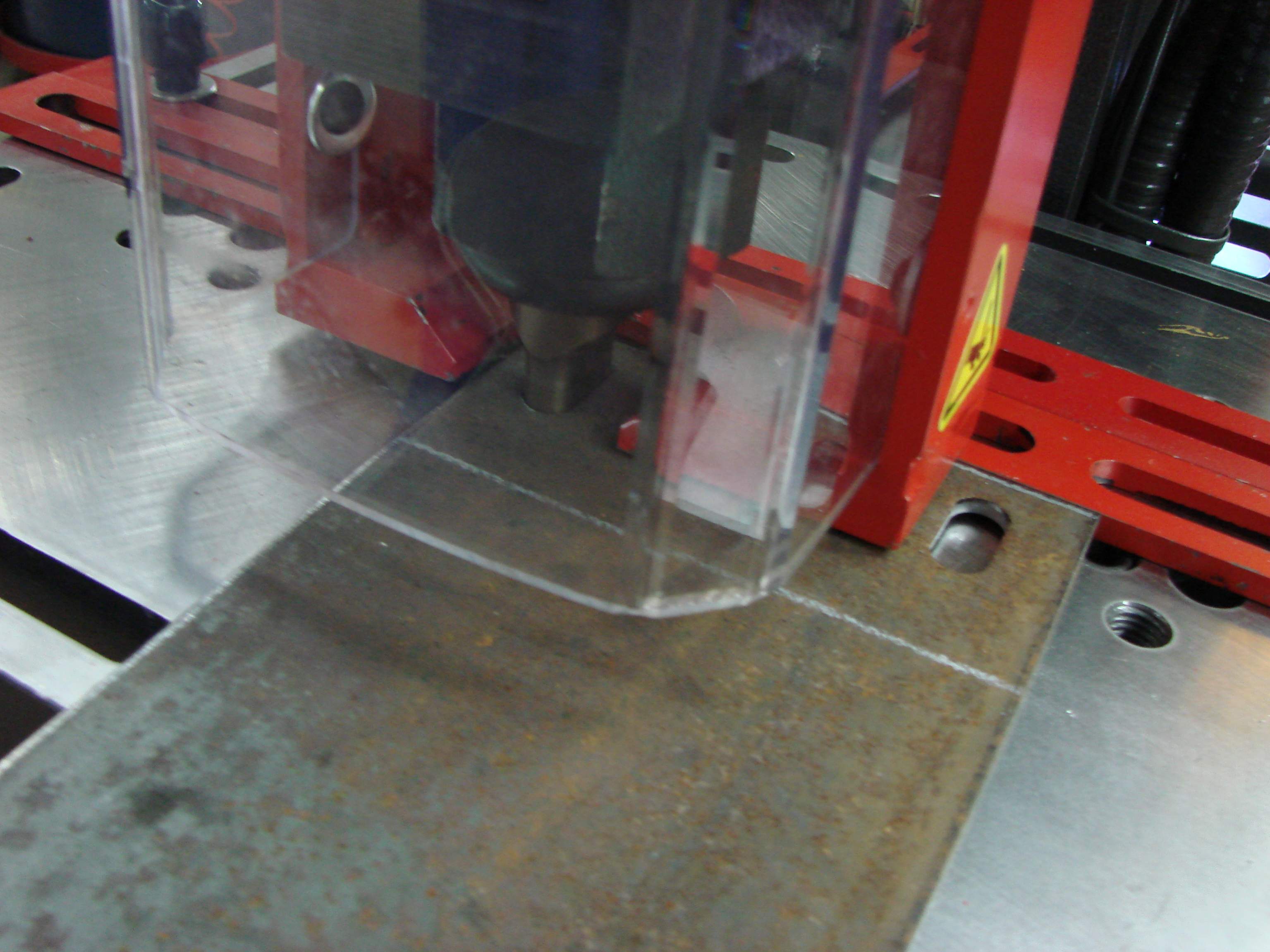

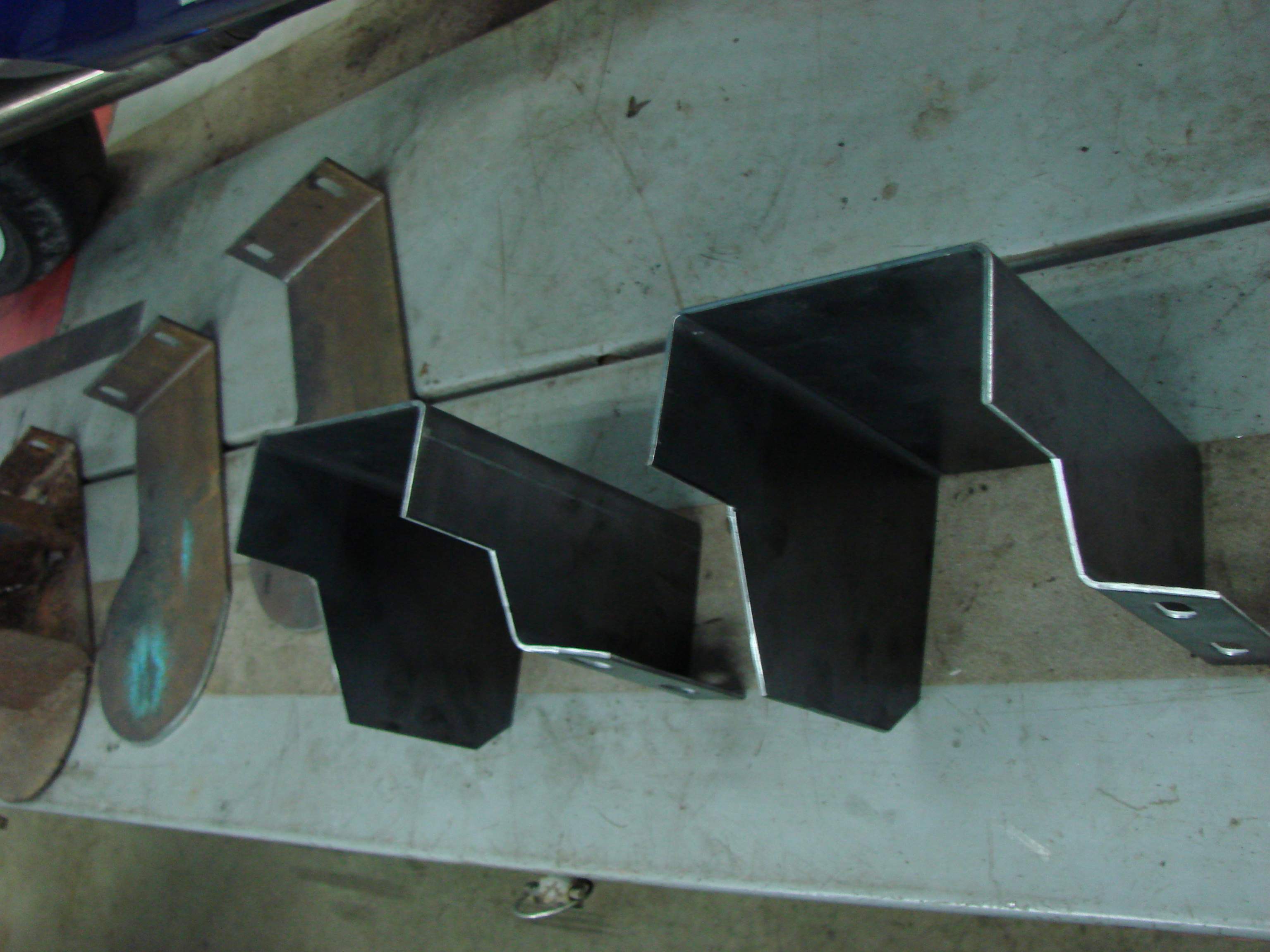

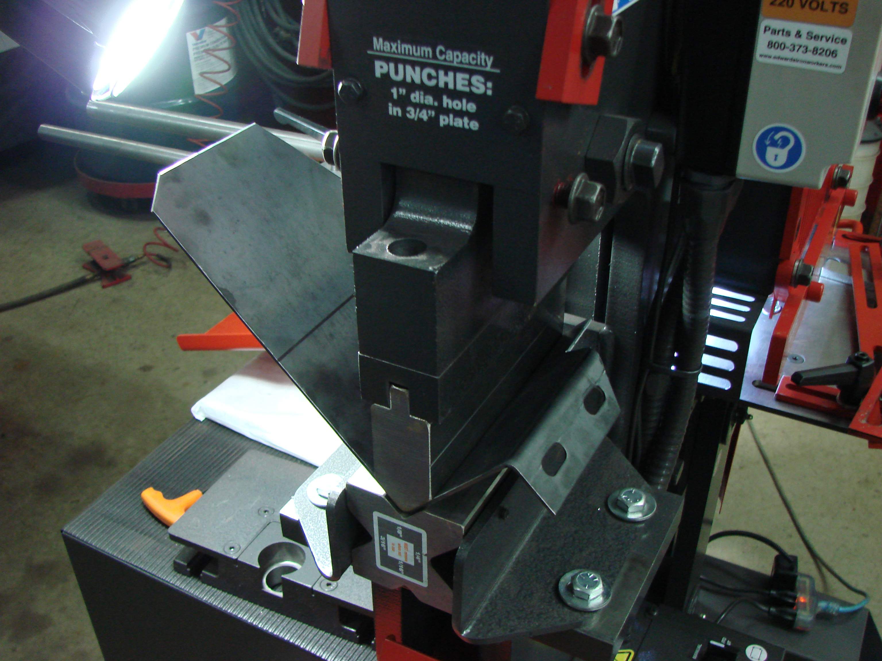

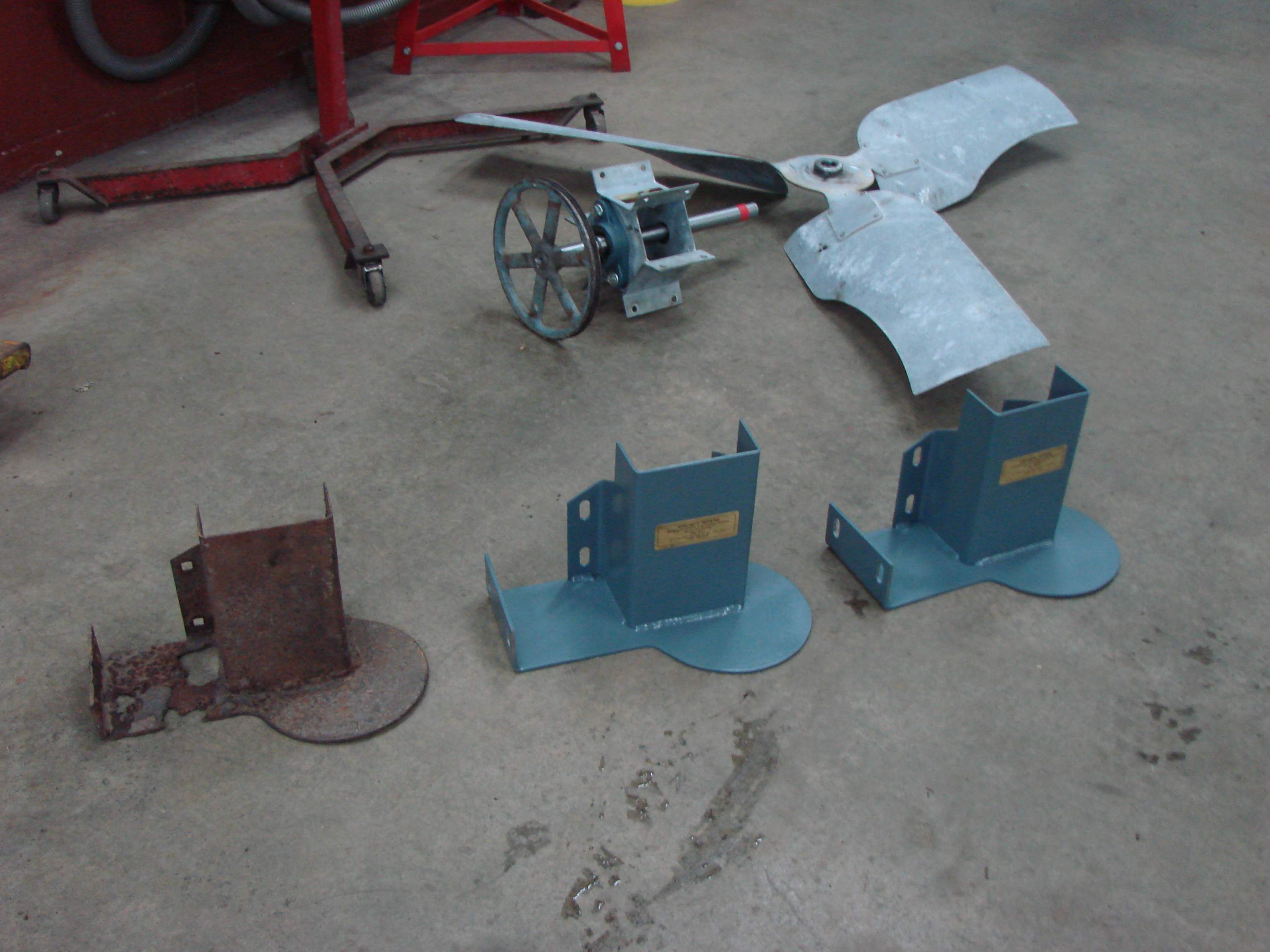

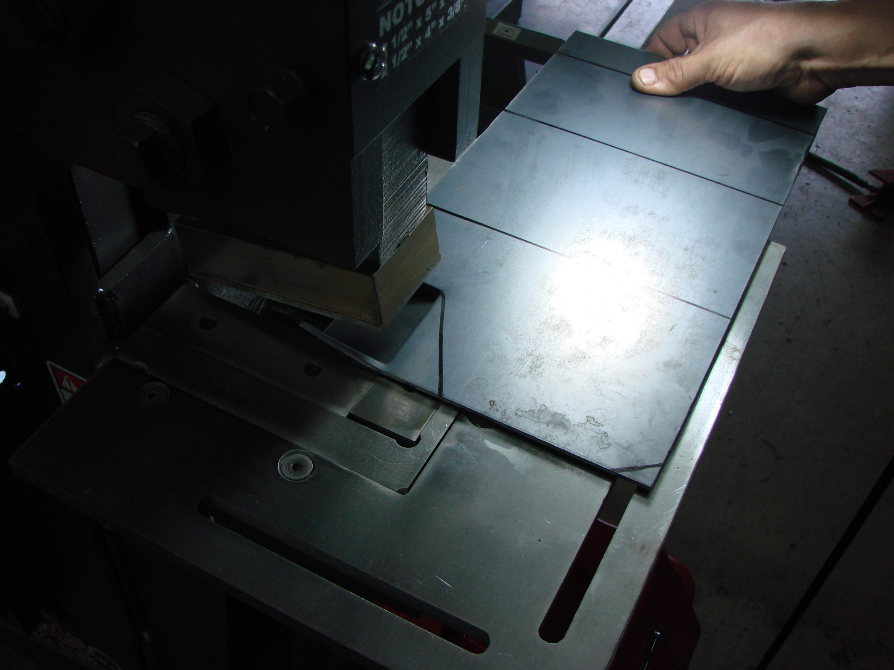

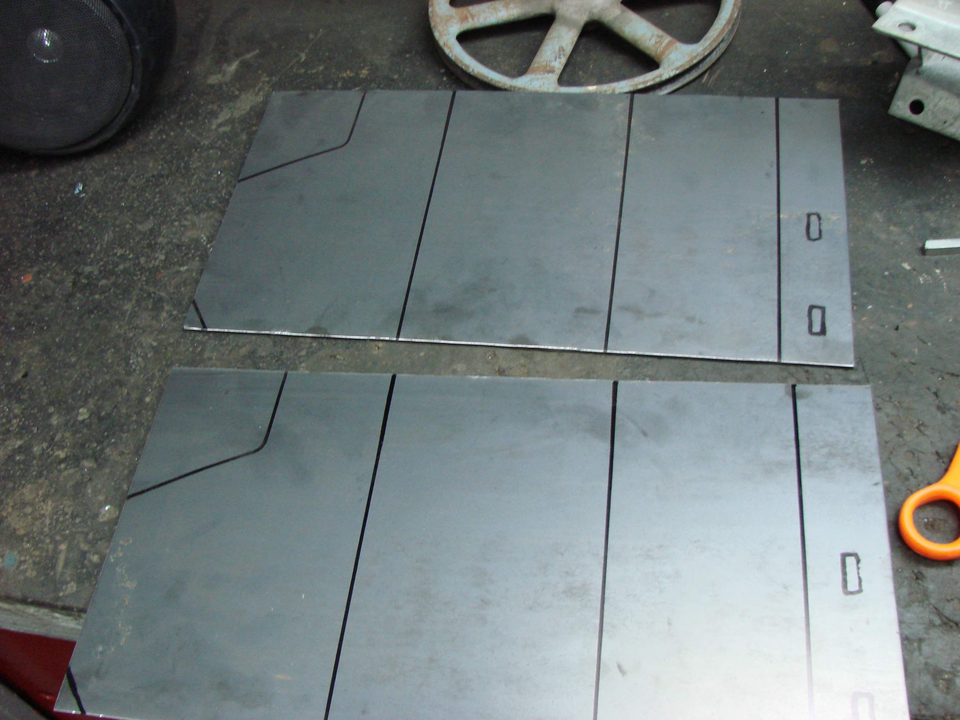

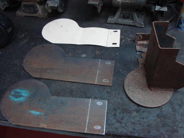

Today I had to fabricate two guards for some piece of farm equipment. As you can see in the first photo the original guard was pretty bad. All the cutting of the 3/16 plate was done with the ironworker and you'll notice that all the bends were done on the ironworker as well. They were painted and our company decal was added to them. Here's how it turned out.I also rebuilt a fan shaft and bearings that you'll see in one of the photos as well. I got 15.5 hours in for today so it's off to the house :cool:

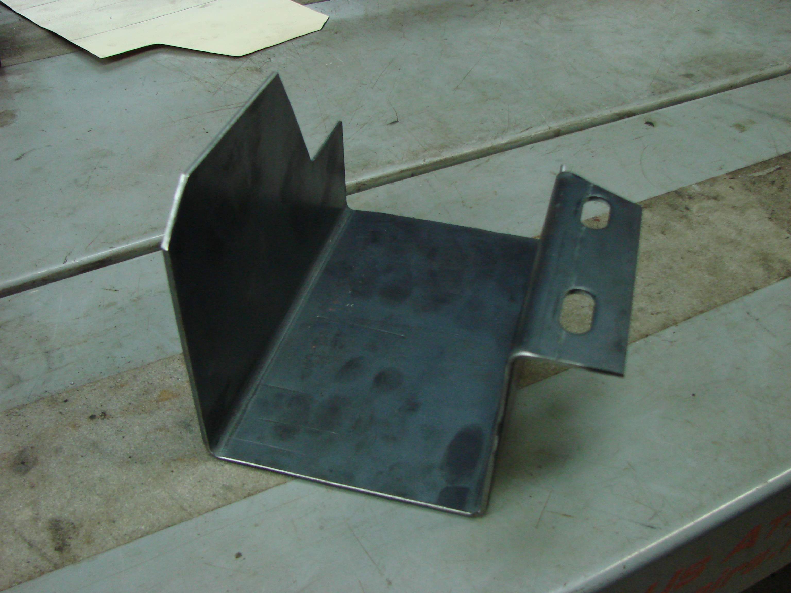

More pics!

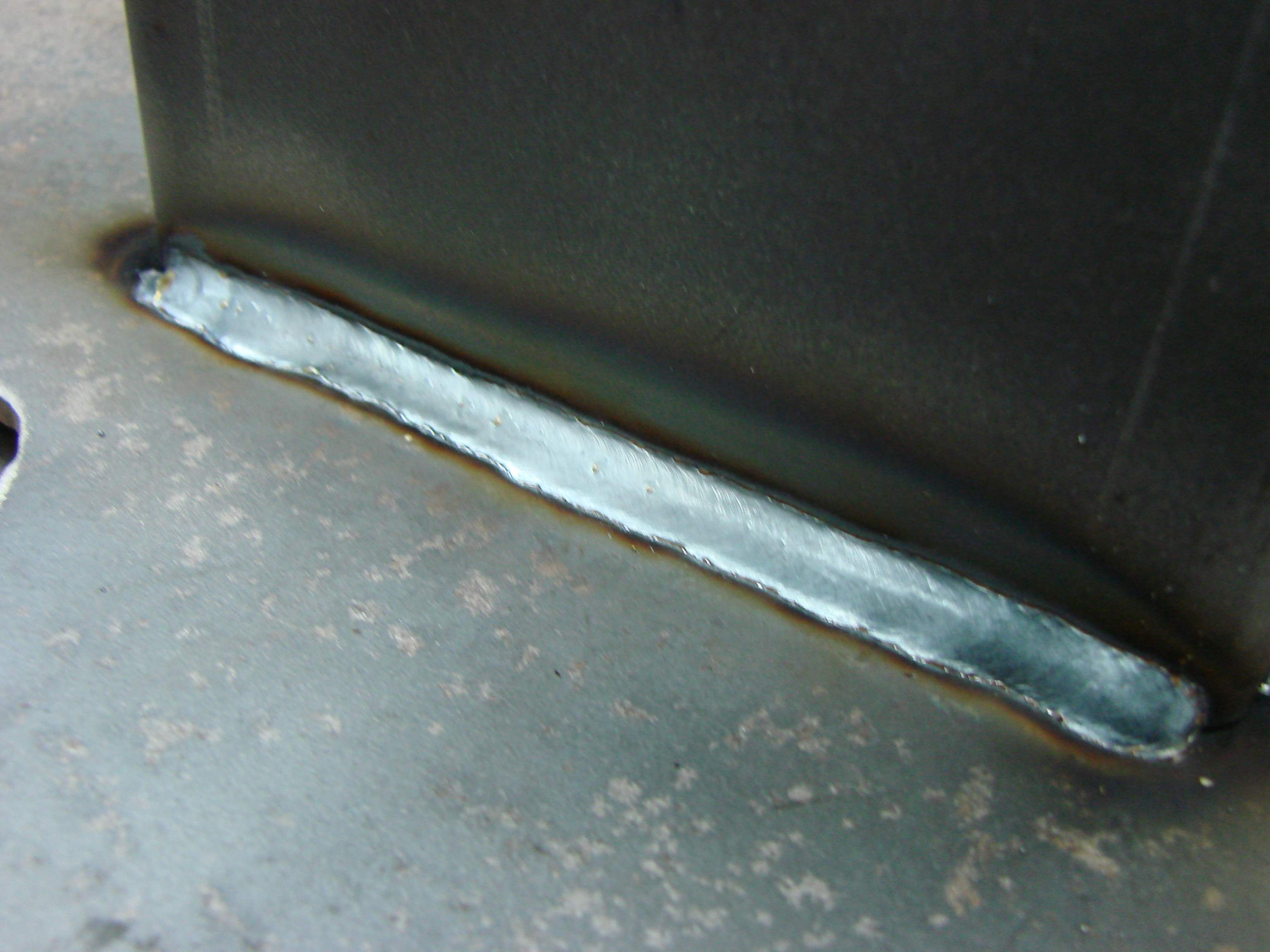

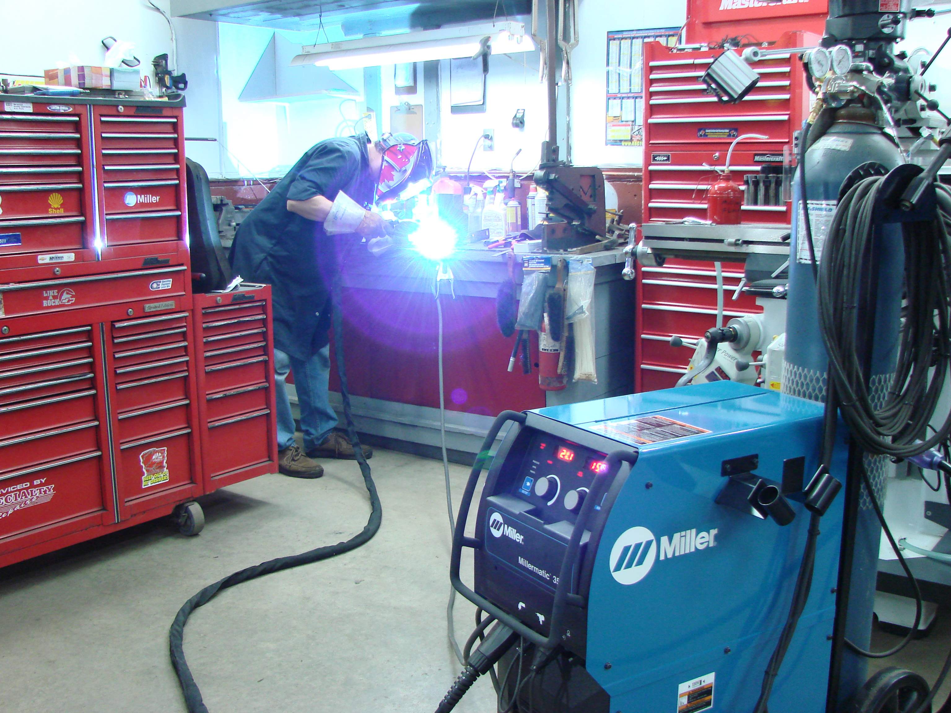

The welding was done with Millers Millermatic 350 P and welding was done in pulse mode. I included a photo of the weld for your viewing pleasure .;)

That is the prettiest weld yet. When are you getting a CNC plasma cutter? :)
Thank you Matt. When ever I post a welding/fabrication project I like to include a photo of my welds. It's just part of the package so to speak.

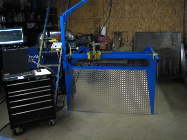

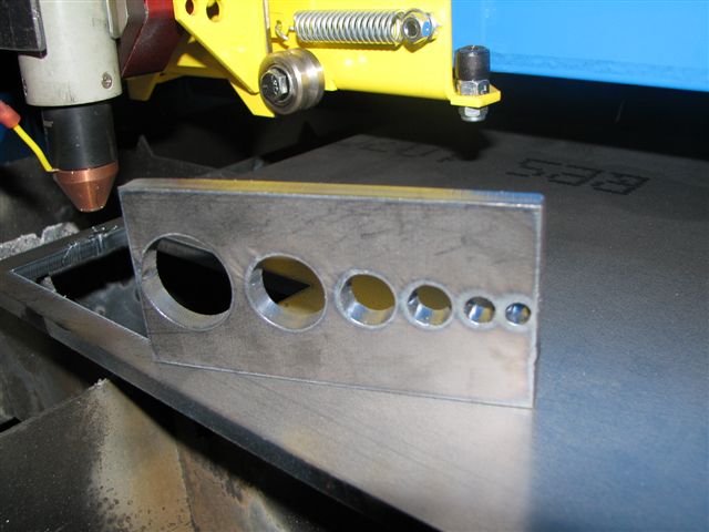

Nice work. Looks like you are using a Hypertherm plasma torch as well. Cnc plasma machines can be had for small shops for reasonable prices today. I have a 4 x 4 PlasmaCam machine in my home / horse farm shop with a Hypertherm Powermax45 plasma....it paid for itself just doing a bit of part time work in the first 6 months I owned it. Here are some pics.

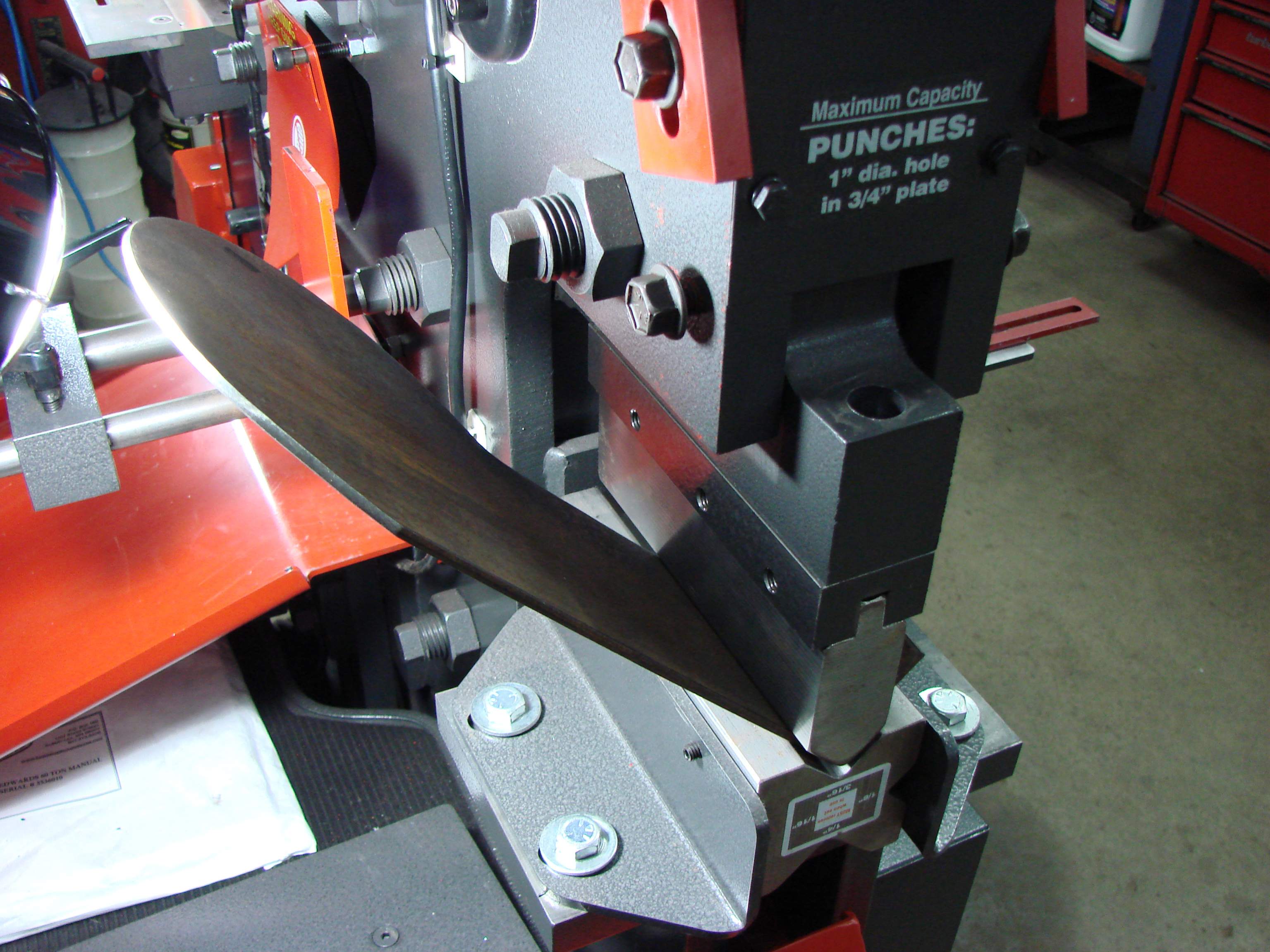

You said "All the cutting of the 3/16 plate was done with the ironworker...". How did you do the round cuts?

Jim that's a nice looking set up and some beautiful cuts. I'm going to have to do some research on that thing. Thanks for posting the pics. I think you and Matt got the seed planted :laughing::drool:
Cyril I just nibbled around it with the notcher and just had to finesse it with a flap disc. I wanted to see how much I could do with just the Ironworker and was pleased with the outcome. Now if you could buy an Ironworker with a welding station attached then add a chair I'd just sit down to the think and not move until quitting time :laughing:
