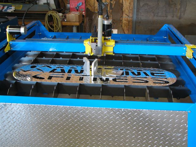

The PlasmaCam 4 x 4 machine is $9800, then add a plasma and a PC (any old pentium with a parallel port). Software comes with it...you can draw your parts in PlasmaCam CAD or import a .dxf file.
I have owned two of them, I sold the older generation model and bought the new version (DHC2) because it had the best torch height control system (necessary with plasma for good cut quality and best consumable life) in the low cost cnc/plasma market.
There are a dozen other brands of entry level machines like this, and about 40 manufacturers of industrial cnc machines that cost 10x as much. The PlasmaCam is the only one that you can program multiple parts and walk away while it is cutting them.
My background FYI: I am on this site because I have a horse farm, Kubota L4310, Kubota RTV900. My day job (32 + years) is working for Hypertherm, manufacturers of plasma cutters in Hanover , NH. Our plasma systems can be used with hand torches or cnc type machines....I have spent over 30 years working with cnc machine manufacturers integrating our plasma systems.
Other cnc entry level brands: TorchMate, Precision Plasma, Tracker CNC. TorchMate has a small 2 x 2 cnc machine (no height control) for under $3k, it is good for small one off parts. PlasmaCam also makes a 5 x 10 machine for larger shops, needs.

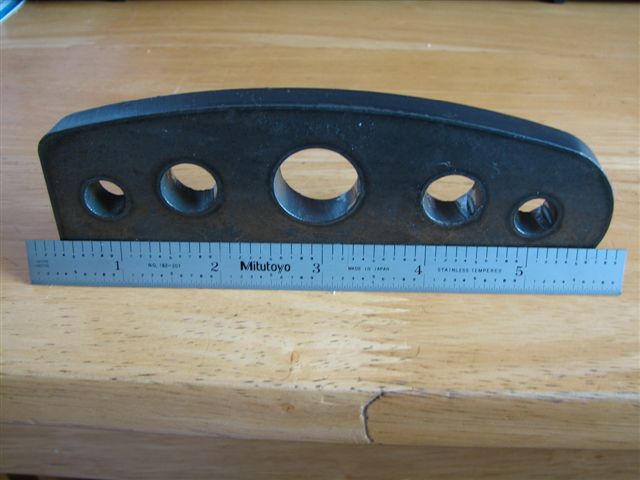

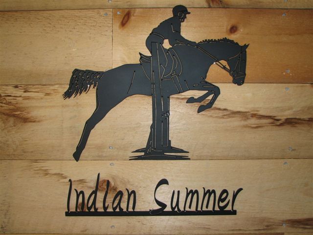

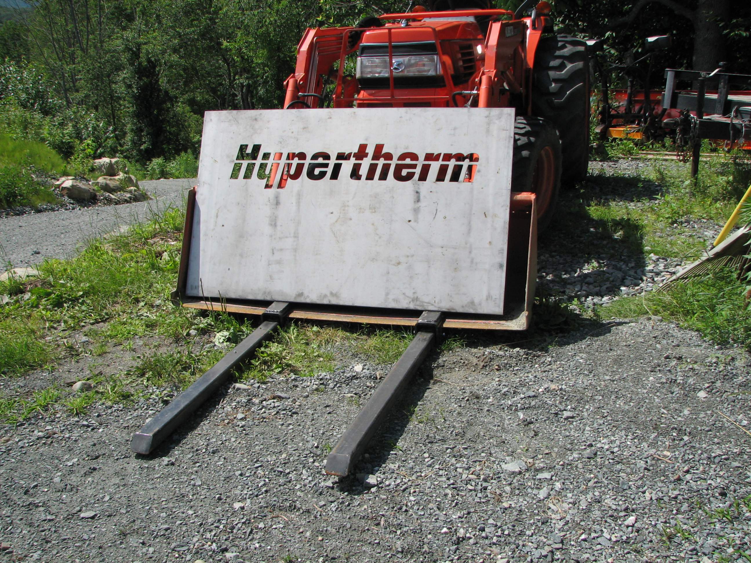

Here is a few more pics of things I have done with my machine.

Plasma Cam has never used a stepper motor for the carriage.....both x and y have always been servos from their first model. The z axis used to be a simple ac motor as it did not need encoder feedback with their first version of a THC, today the z axis is a stepper as it does accurately gauge torch to work distance. A servo is not necessary for the z axis for a plasma, however I agree servos are best for the x and y motion.
