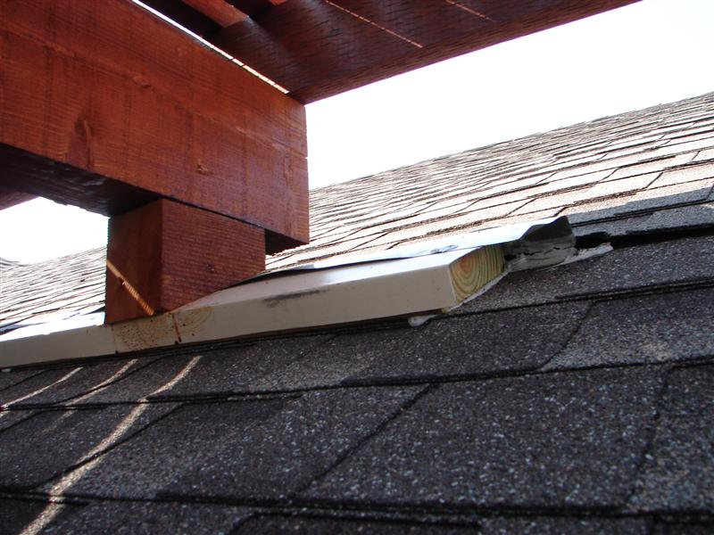

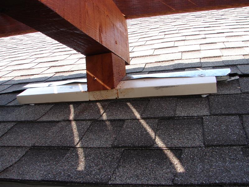

Jim and Kevin, we lifted the shingle and placed flashing up under it. In fact we got lucky and every place we had to put another piece of flashing back under and over the flashing because there was a seam in the shingles to worry about.
I cut the flashing two inches longer than the treated two by six, standard ten inch flashing that comes in rolls. I then folded it with a two by (the compound miter saw works great in assisting the bending of the flashing with about three inches going under the shingle.
Once the two by six was secured to the rafters over the top plate the flashing was folded over it. We also used some seamless gutter aluminum material to flash over the balance of the two by treated and under the shingle flashing piece.

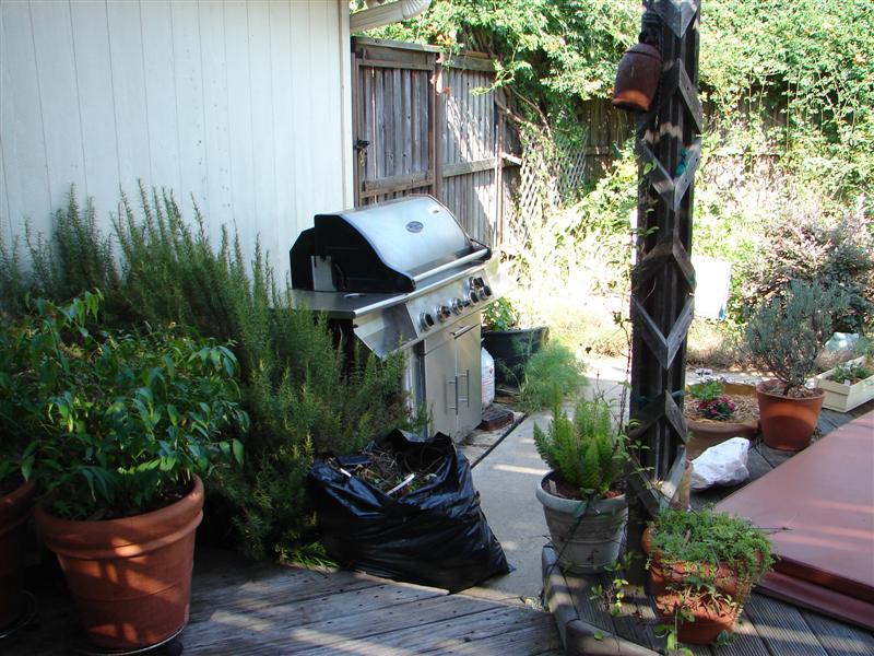

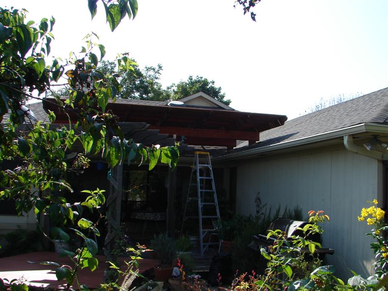

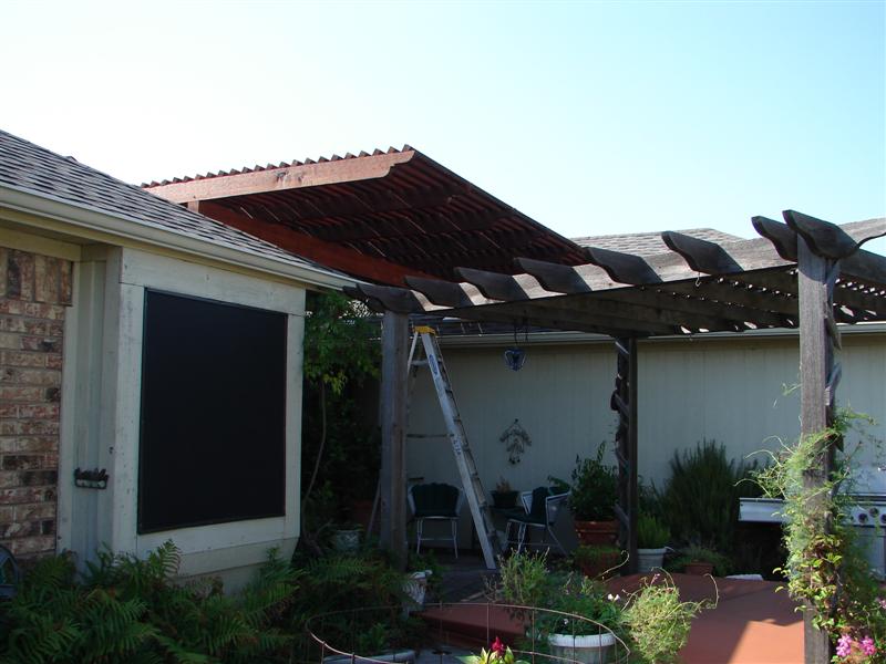

Thanks for the extra pictures. Clears it up for me a lot. Very interesting attachment method to connect to the house. I like it.
   / Just a little update on my PWRL file #15
Same here, it makes allot more sense now that I see it from a distance.
