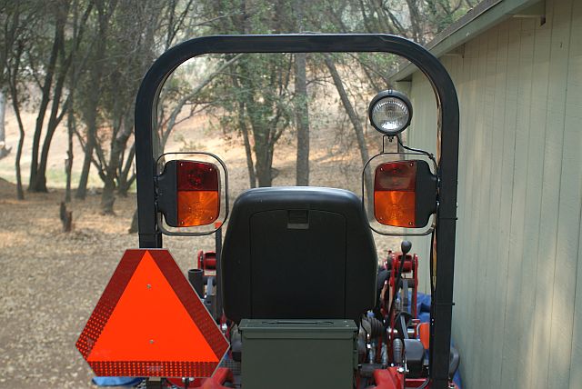

You might want to consider moving your stop/turn/emergency tail lamp from out side of ROPS to insides... I can guarantee you that a replacement lamp fixture is $127... Just unplug and swap them side to side and remount on inside...

Figure on using a couple of washers between lamp holders and ROPS bar so you don't pinch wires and get some zip ties to hold wires to ROPS bar as its tough to get wires down insides of ROPS without drilling more holes....
Apparently who ever designed system does not know about trees...

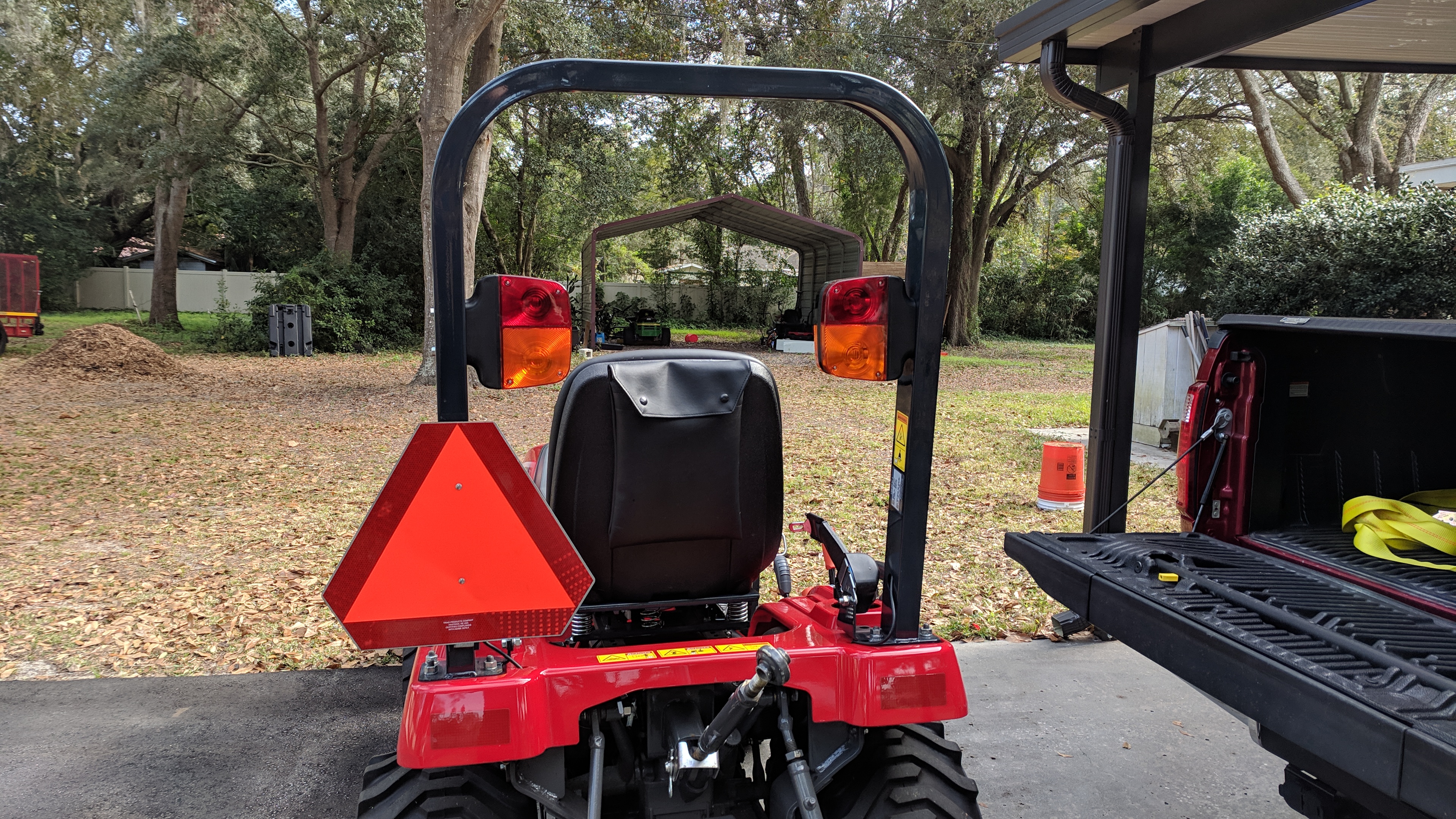

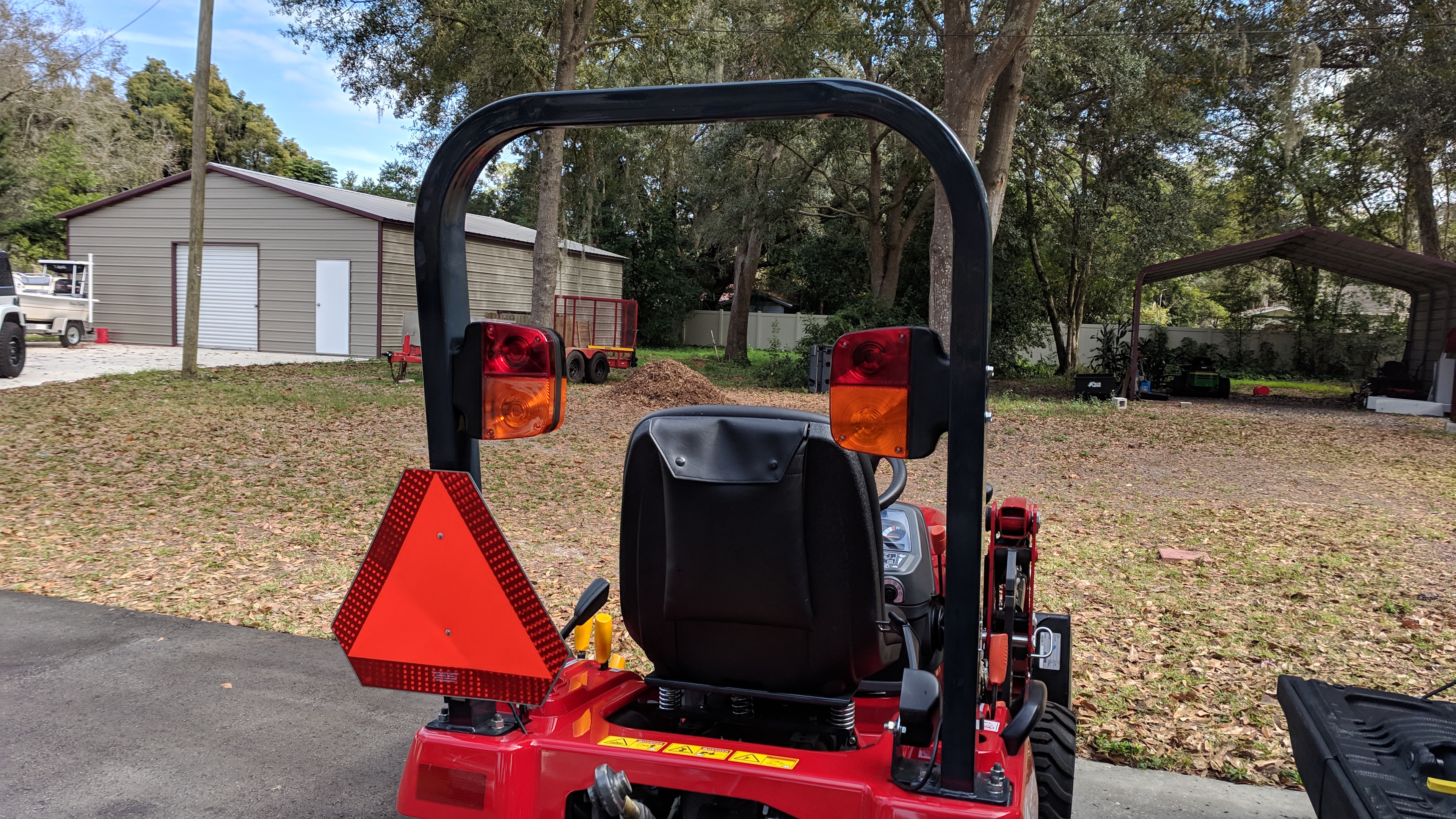

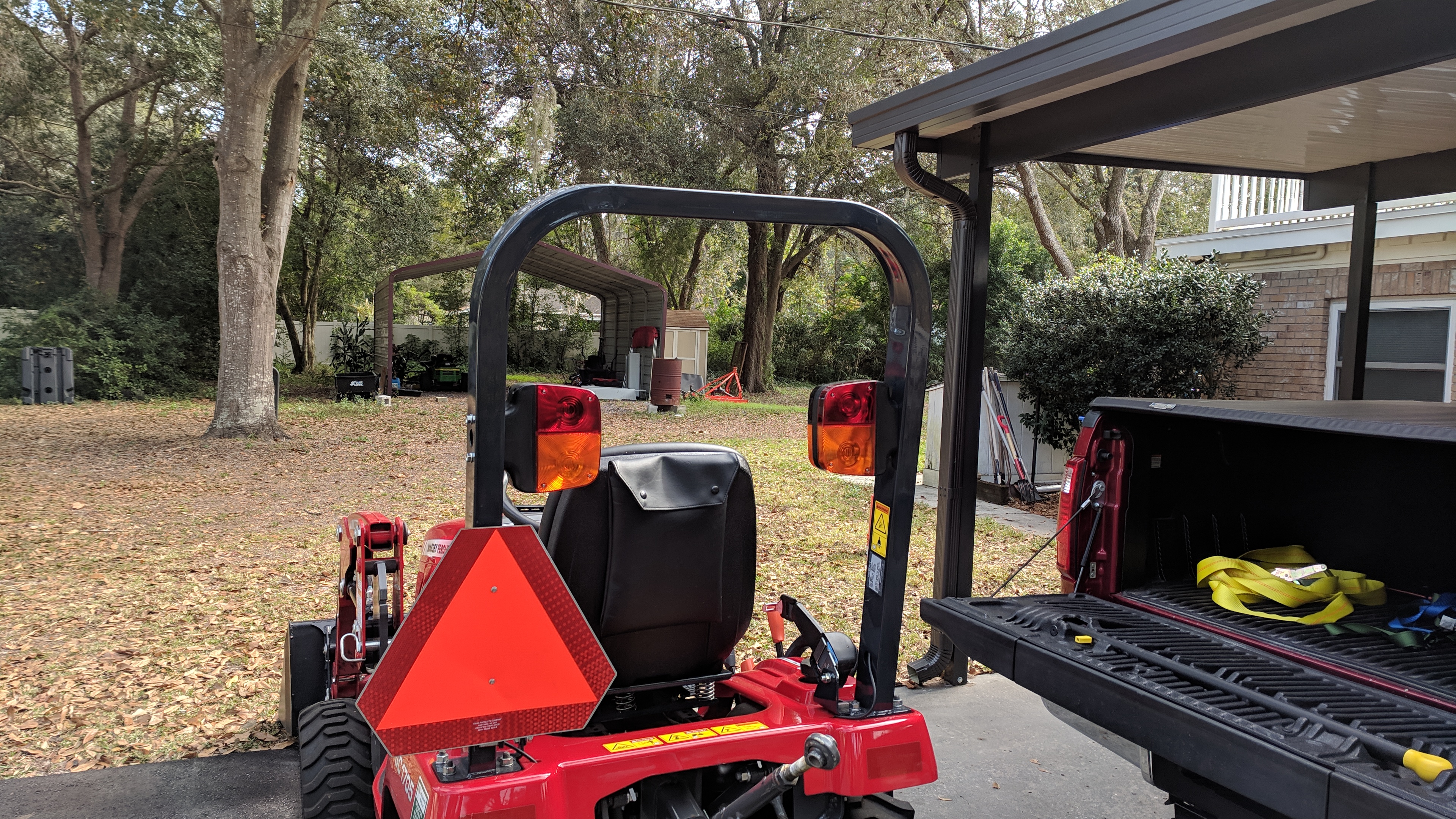

I just followed your advice and moved the lights. I opted to drill new holes instead of using zip ties so it has a clean finished look. Thanks for the advice.:thumbsup:
View attachment 586351View attachment 586352View attachment 586353

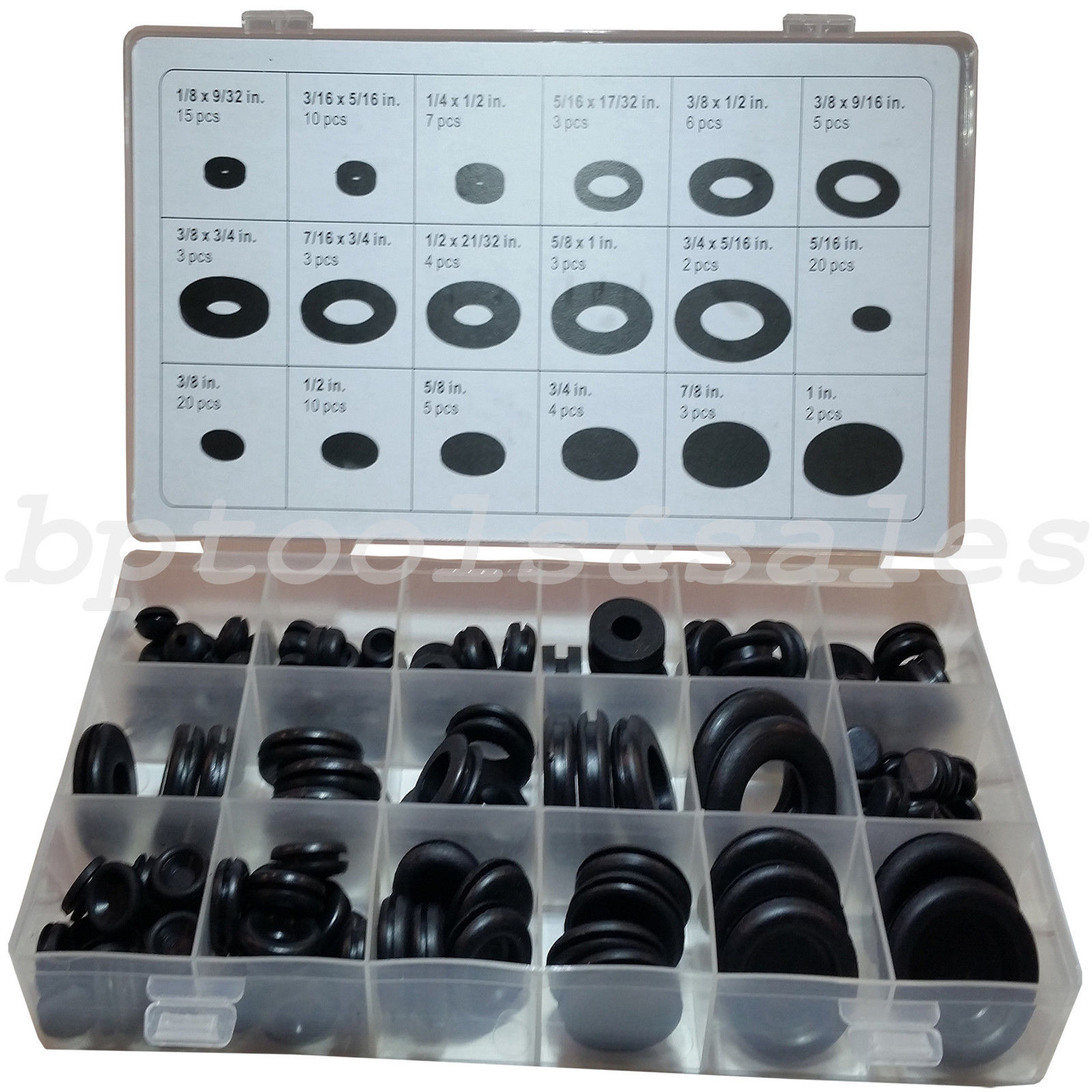

update I just ordered these to plug the factory holes on the original sides
https://www.ebay.com/itm/125-Pc-Rubber-Grommet-Firewall-Wire-Gasket-Solid-Hole-Plug-Assortment-Set/331302514697?ssPageName=STRK%3AMEBIDX%3AIT&_trksid=p2057872.m2749.l2649
