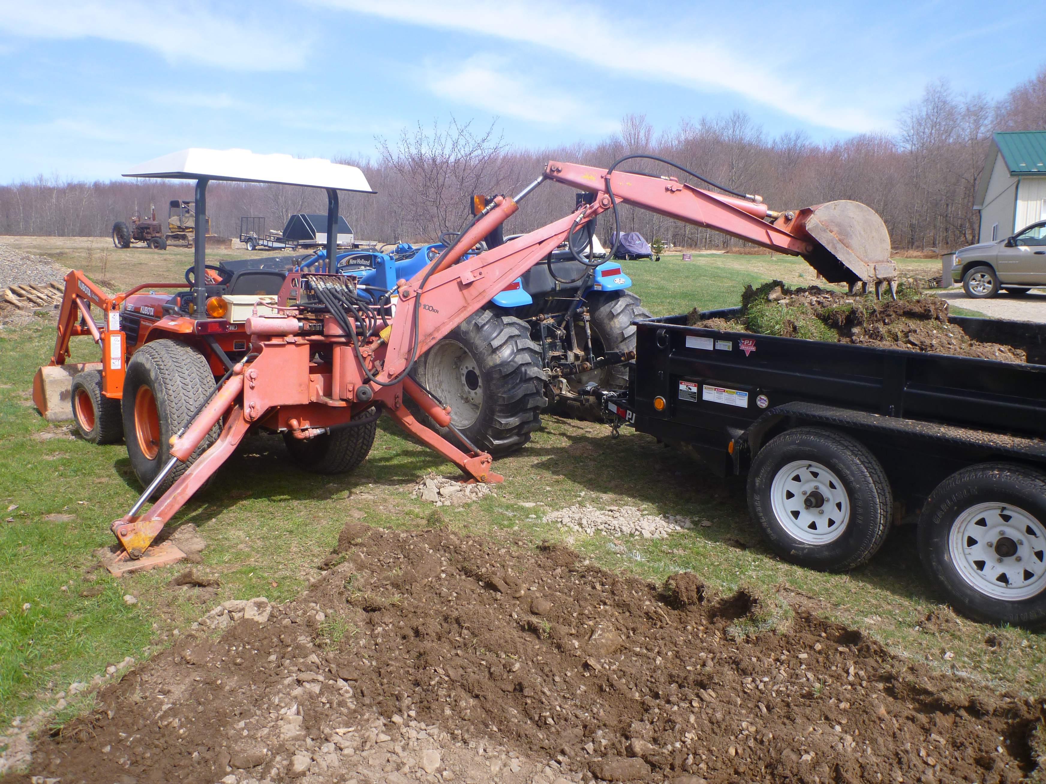

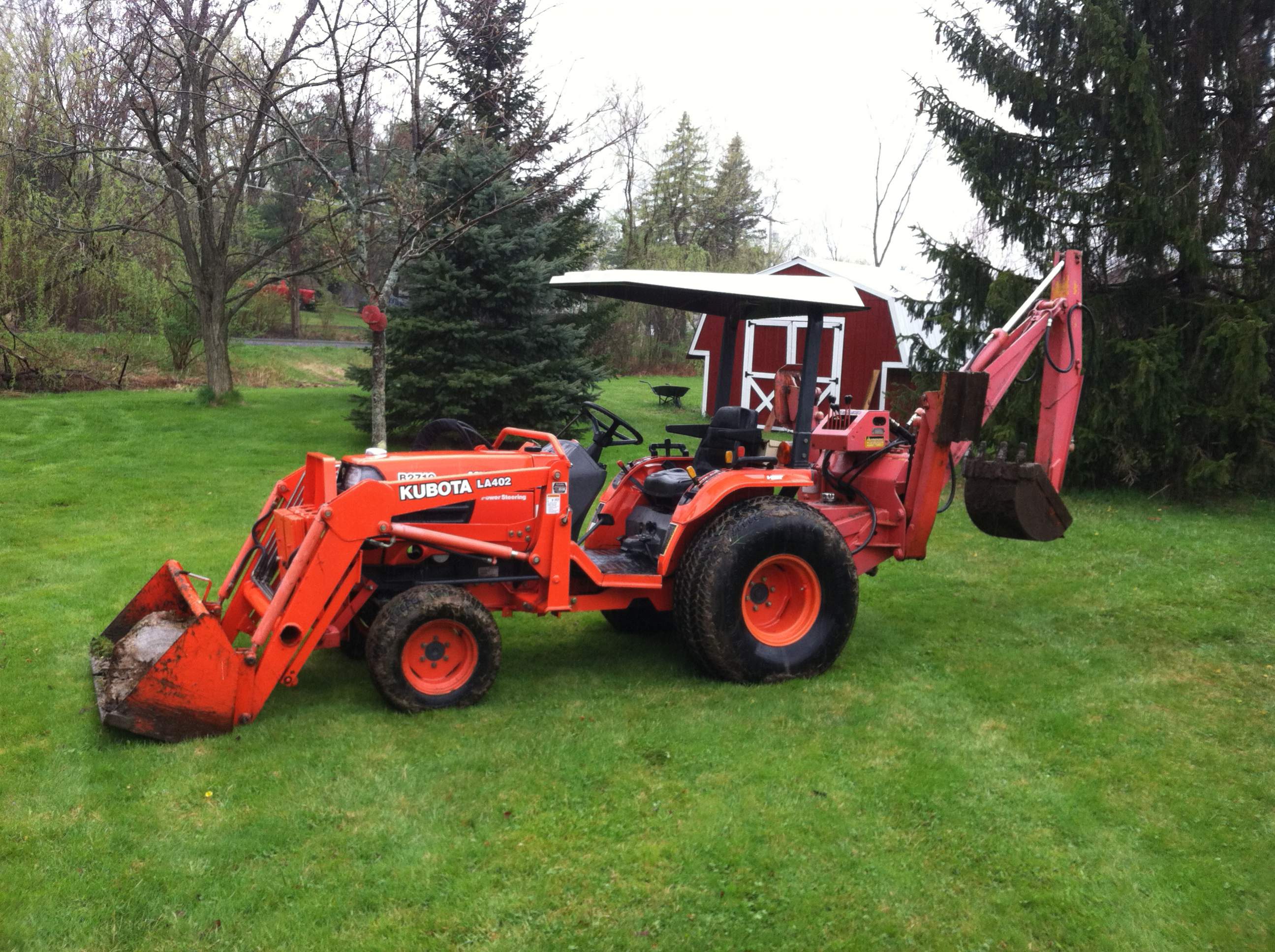

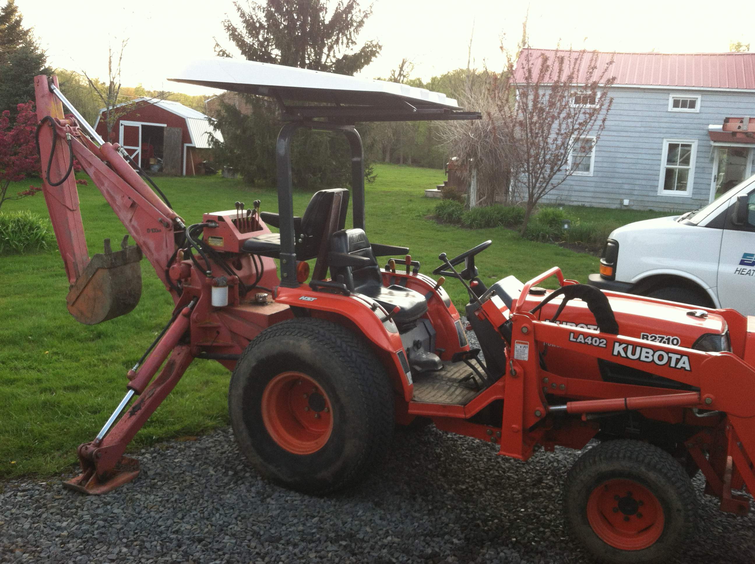

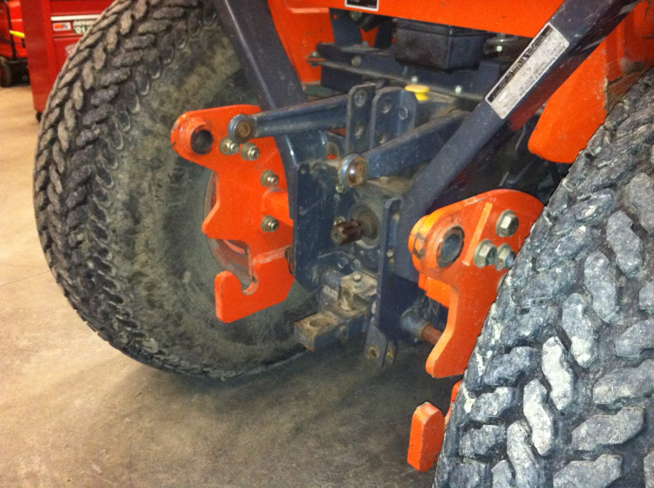

I have a B2710 with a Case D100xr backhoe. Its a little big for the tractor but it digs great. I have to put 300 pounds on the front of the tractor to make it driveable. It has a pto pump, i can look up the gpm for you. It uses a kubota factory subframe kit that the backhoe is adapted to fit and is easy to remove.

IMG_1909.JPGIMG_1732.JPGthanks can you sent me some picture of your installation .
i have a front loader and a cab on it
/ Just acquire a backhoe case Davis D100 backhoe #4
Here are some pics I already had, I can take some more of the subframe if you want.

Yes some pics of the subfram:thumbsup: I will appreciate it if you could
/ Just acquire a backhoe case Davis D100 backhoe #6

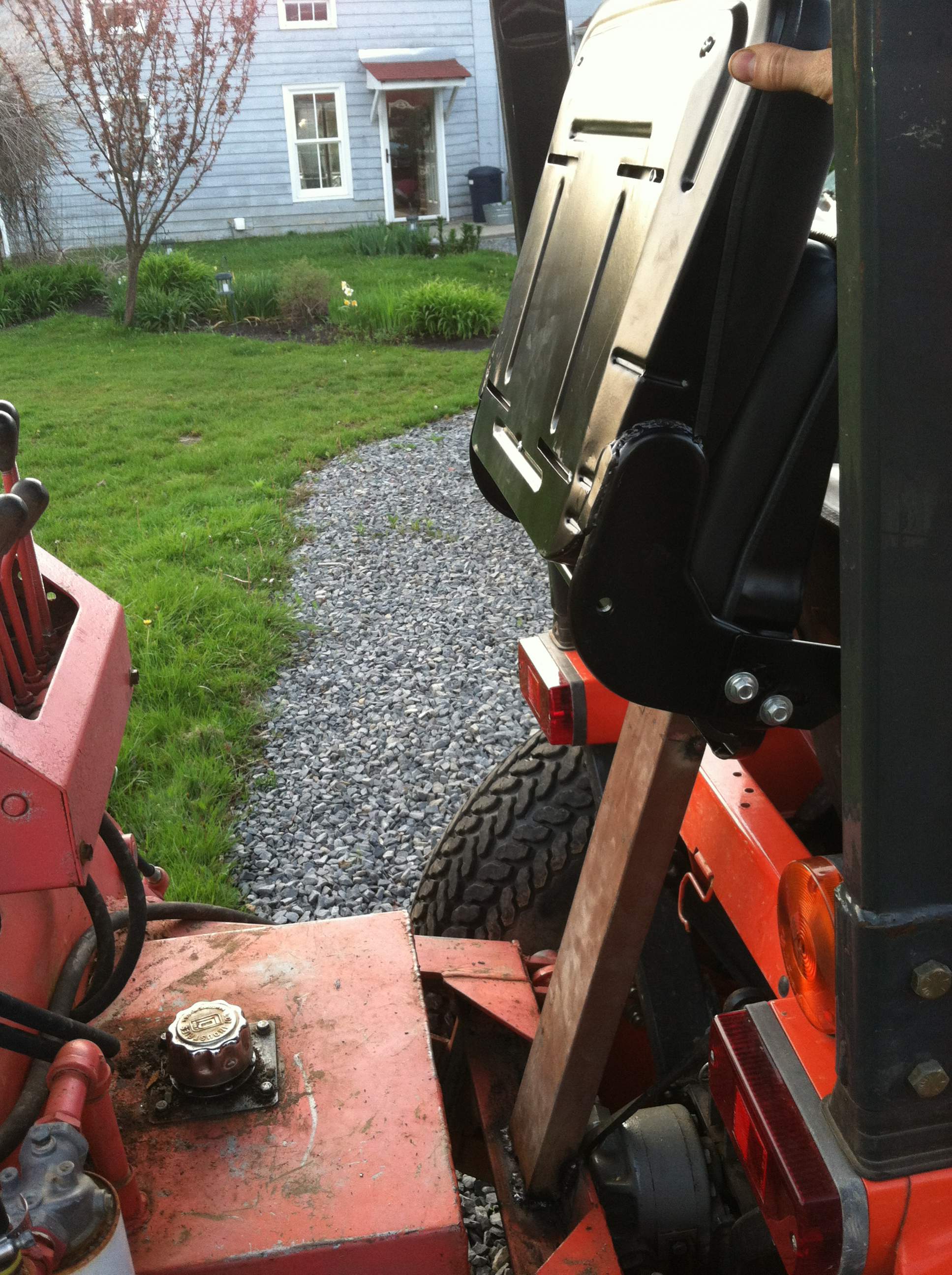

Here are some pics of the subframe and backhoe modifications to make it fit. The subframe continues up to the front end loader mount.
