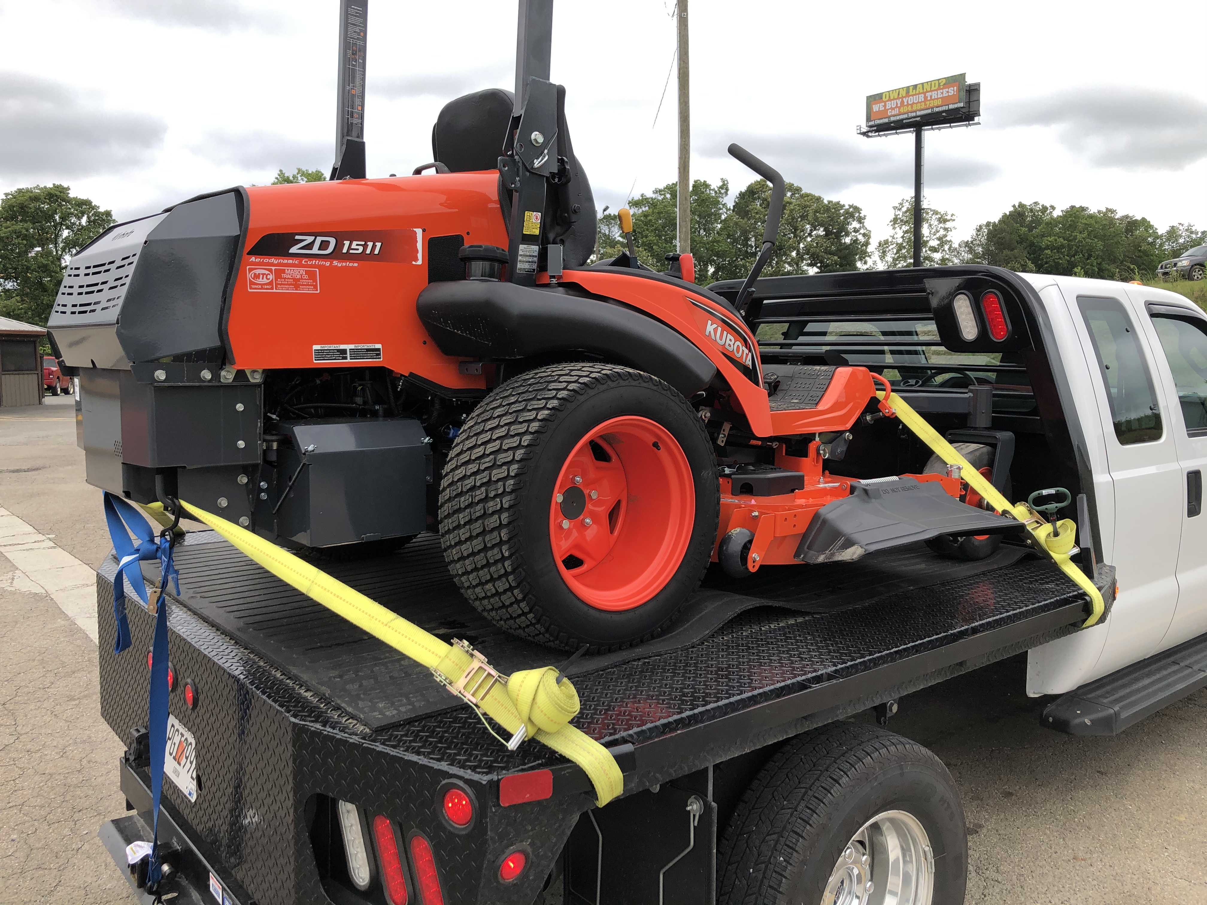

Found a leftover 2018 ZD1511 72 SD at a good price.
0% & 60 was a no brainer.
I mowed the front yard tonight before the bottom fell out raining.
Hope the Regen Mess works out ok as I mow 8+ hrs a week
I’m trying to load pix ......
