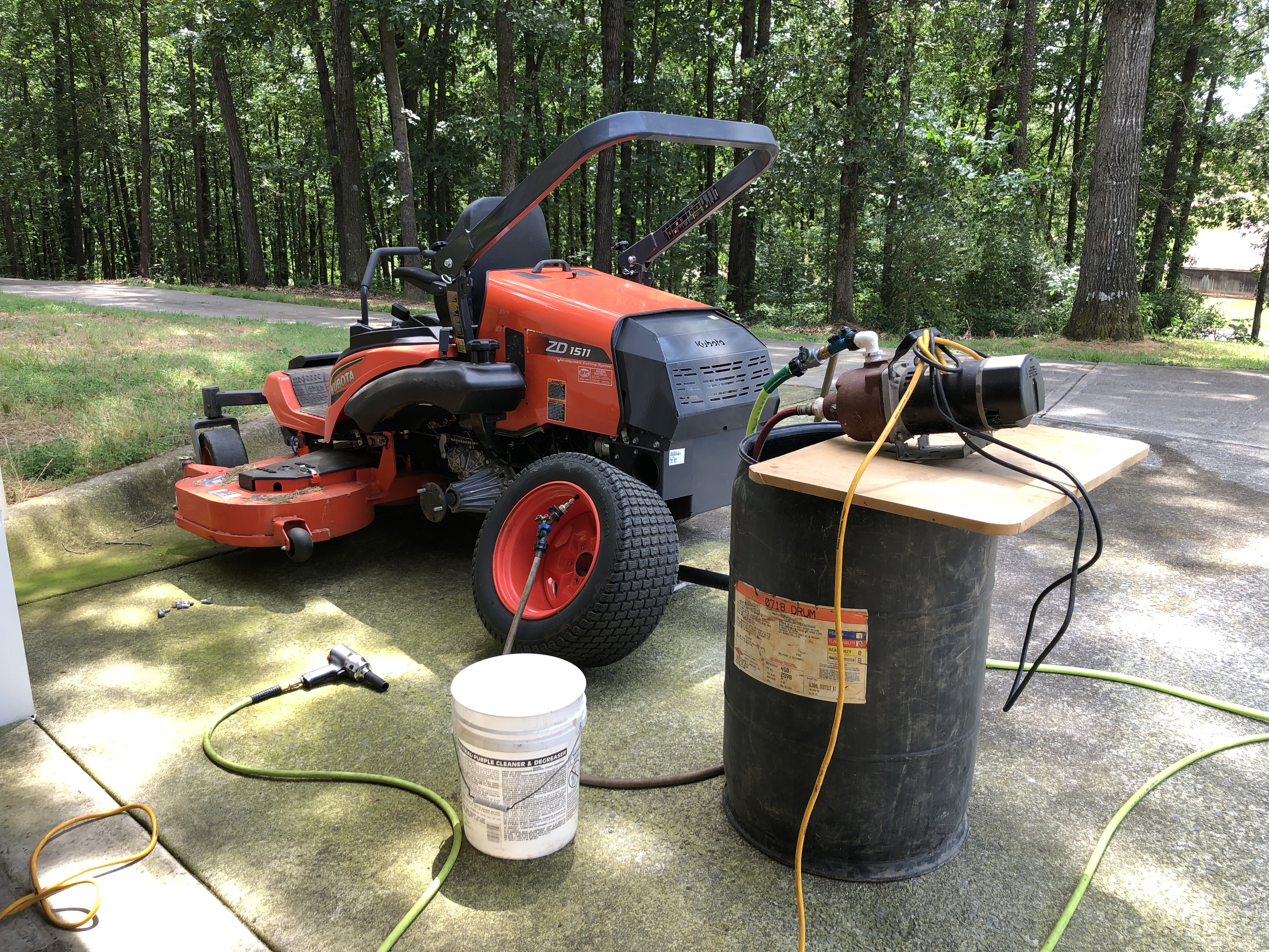

I’m @ 9hrs now on my new ZD1511 :thumbsup:
The 4cyl Turbo Power is Truly A M A Z I N G :D
I fluid filled the rear tires today like I did my ZD1211.
13gals of water / RV Antifreeze mix per tire : 100 lbs per side for increased traction on my hills & ditches.

You are getting close to your first regen if like my ZD1511 which regens between 10 and 11 hours each time.
Be interesting to see how much better traction/stability is with the added weight.
