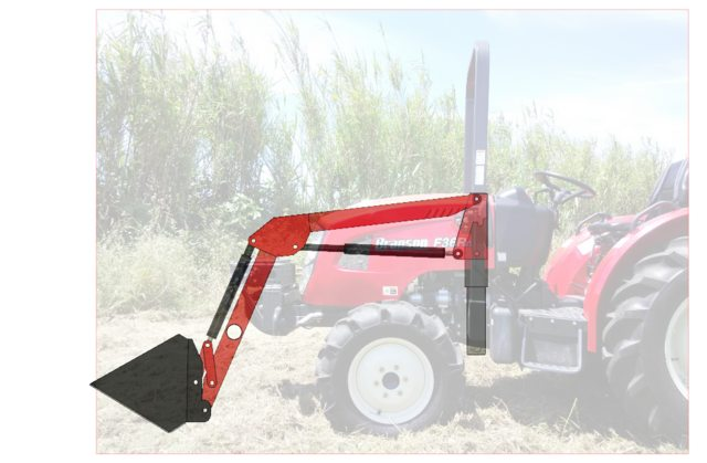

I have seen many pictures of Front End Loaders on Compact Utility Tractors on this site. Having one myself, a CUT with FEL, I have been paying attention to how they are constructed. And they are all pretty much made the same. Not just the geometry but the actual shape of the components. The bracing, gussets, and the prismatic tubular components. By prismatic tubular components I mean stuff like square or rectangular tubing that changes dimension along the length. So even though the tubing might be square or rectangular at any particular cross section the size changes along the length. So If I was to build one for myself I would just find one on a lot somewhere that is the size I want, or close to the size I want, take some pictures with a tape measure in the picture to use for scale, and copy it. No calculations. No wondering why a particular shape of gusset. Apparently the calculations have been done and work well enough for everybody else to use the same shapes and the same changes in dimension. This works for backhoes too. Just copy something similar. They are all using the same geometries too.

But there is far more than just taking a tape measure to it. Welments that are concealed inside, size and type of welds and material properties are just some of the things that could add major differences yet go undetected. In the past before strain gauges or FEA they just added more material, or adjusted for failures later with updated designs. Now, an FEA report can be generated on a laptop in minutes, with materials and geometries that can then be tweaked, and a new report generated. Maybe that's why the designs now have converged to all look alike.

That's more or less how I did mine. Just went ahead and checked lots of loaders in person on farm shows and other events, to get an idea on how it's put together, thickness of materials used, cylinder placement and sizing, hoses, etc. Did take some pictures but didn't really take any measurements.
Another trick I used was to find a picture of another tractor like mine that had already a loader, import the picture to a CAD software, scaling it properly, and then get all the dimensions I needed. Won't be fully dead on but will be perfectly close enough.
In the end, came out with my own CAD model to make sure I had all the right geometry, clearances, strokes, etc.
