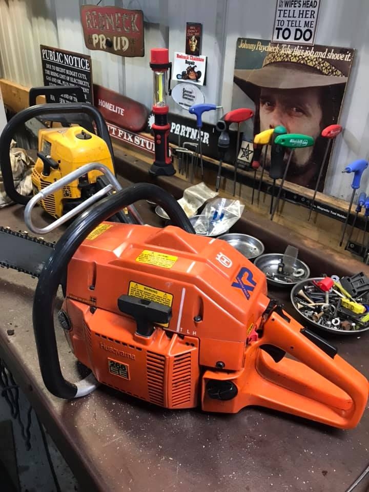

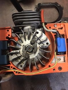

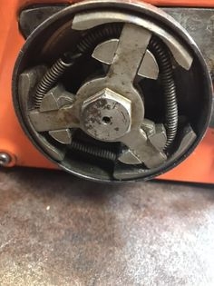

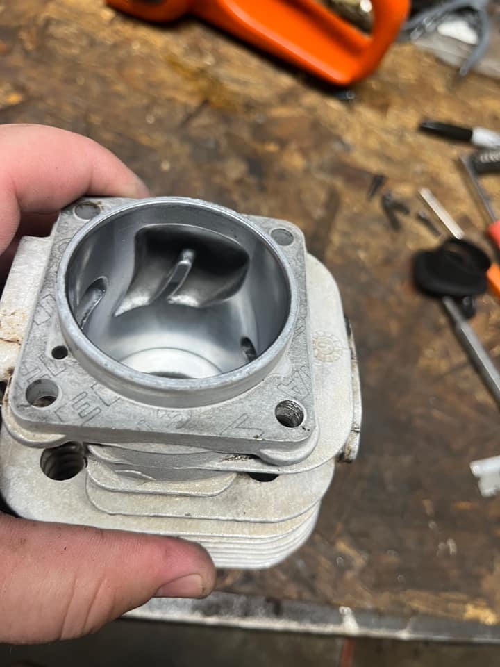

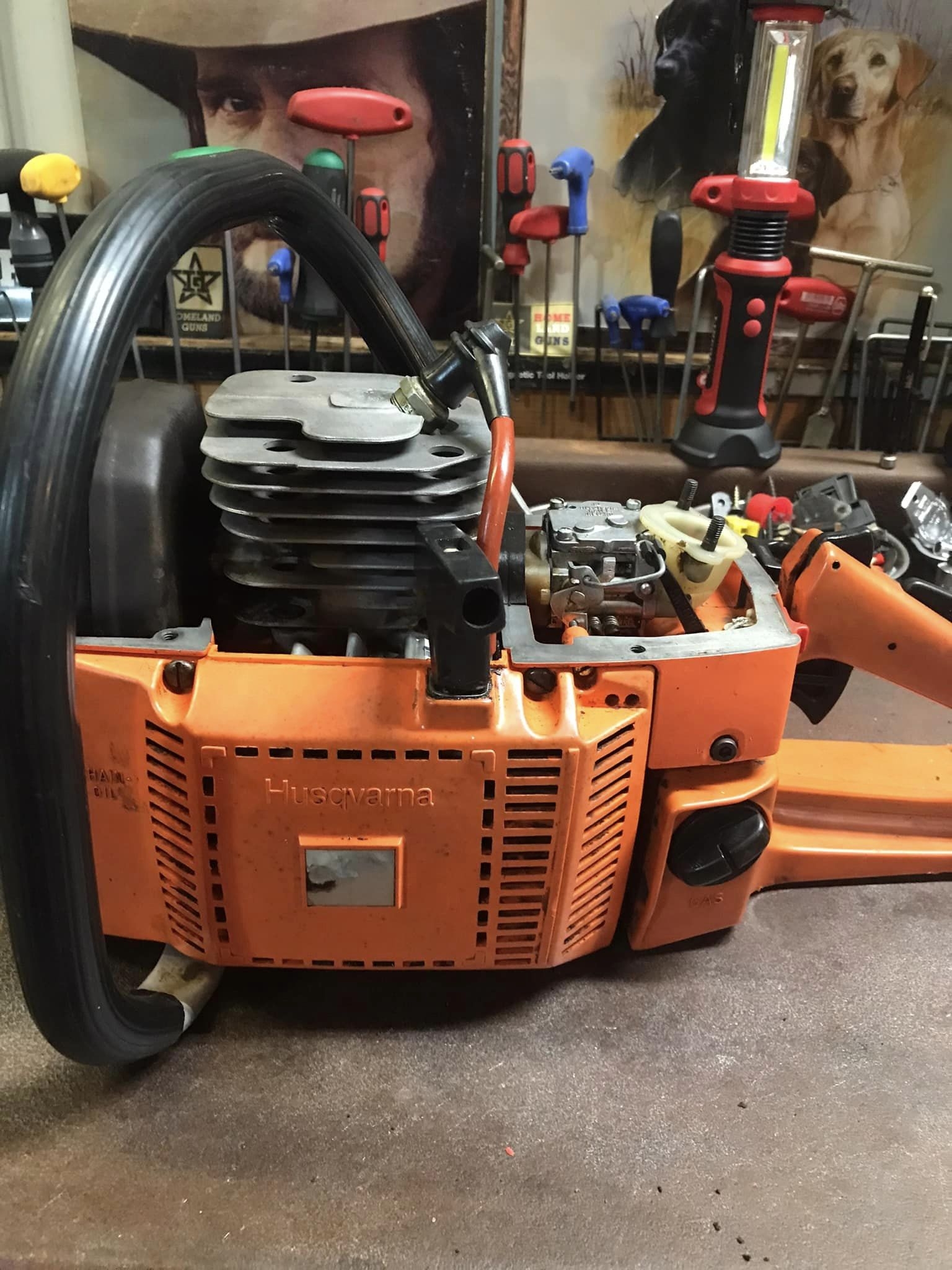

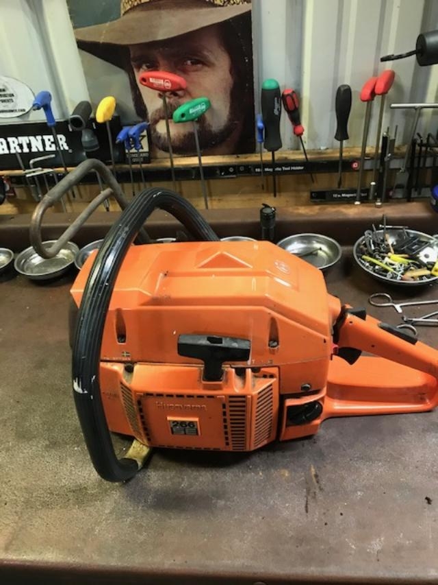

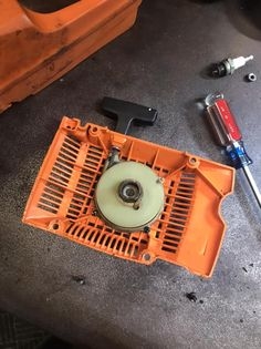

Forgot I picked this up before I had to do that guys G372xp pro. 1983 266 SE before they went XP later on.
Lost track how many husqvarna 266 I bought to flip now. Coarse thread clutch that is hard to find.
Missing some parts and seller kept the muffler bracket on me. Wasnt as shown but dont care. Just for parts or quick flip.
Pretty clean with some scoring started.
Got a good laugh. Couldnt figure out why bar studs were loose when looked over quickly. Figured typical worn case.
But no the guy didnt have the studs in right lined up inside tank. Took care of that yesterday for next owner.

Good saw. Used to have a 266se before it was stolen about 15 years ago. Had it and my 7900 dolmar. Both stolen.
The 266 was a good runner for an old saw.

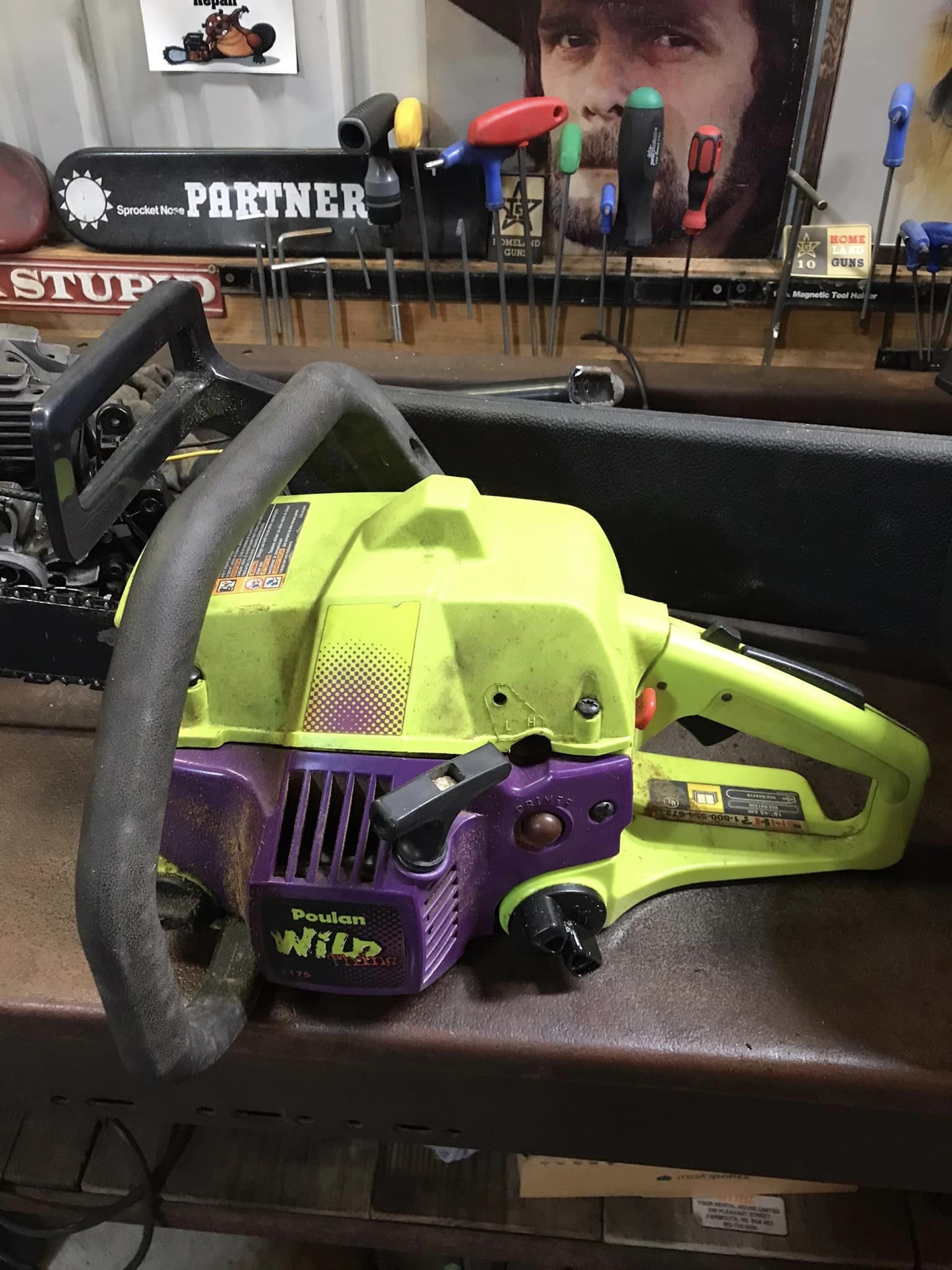

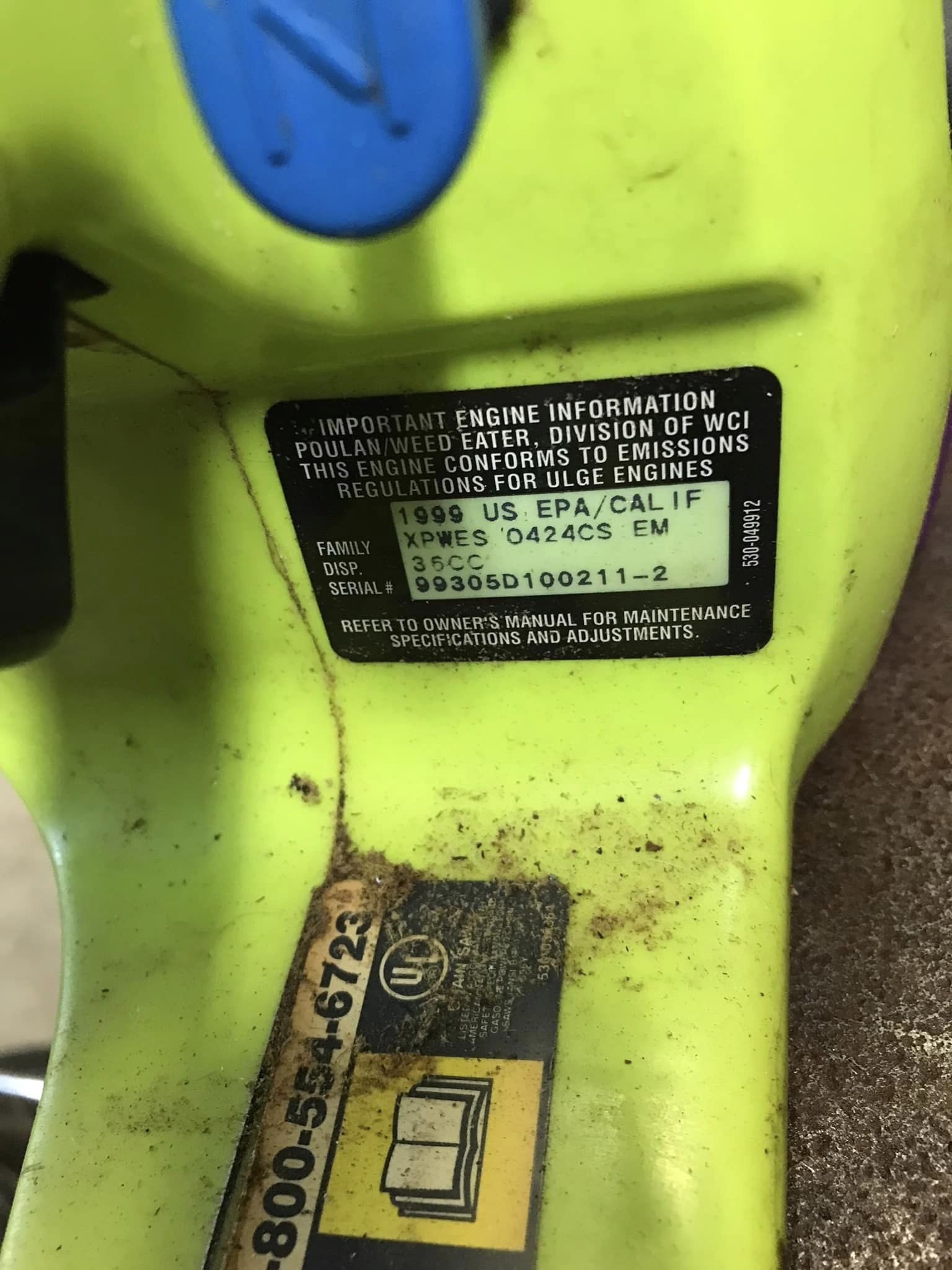

I had always heard the early 36cc poulan saws were indeed 36cc. Not 42cc. So I bought this one with the other plastic one I wanted just to see if so.
Measured bore and stroke yesterday and it is 36cc. Type 1-5 by IPL is 36cc by ring used and 6 up was then 42cc.
Most of the plastic poulans I had over the years that would say 35cc 38cc were all 42cc. So I just always thought the early 36cc would be same.
This one 1999 Type-2 Poulan 2175 wild thing. I always liked the 2375 42cc one the best of all the wild things. If had to have one.

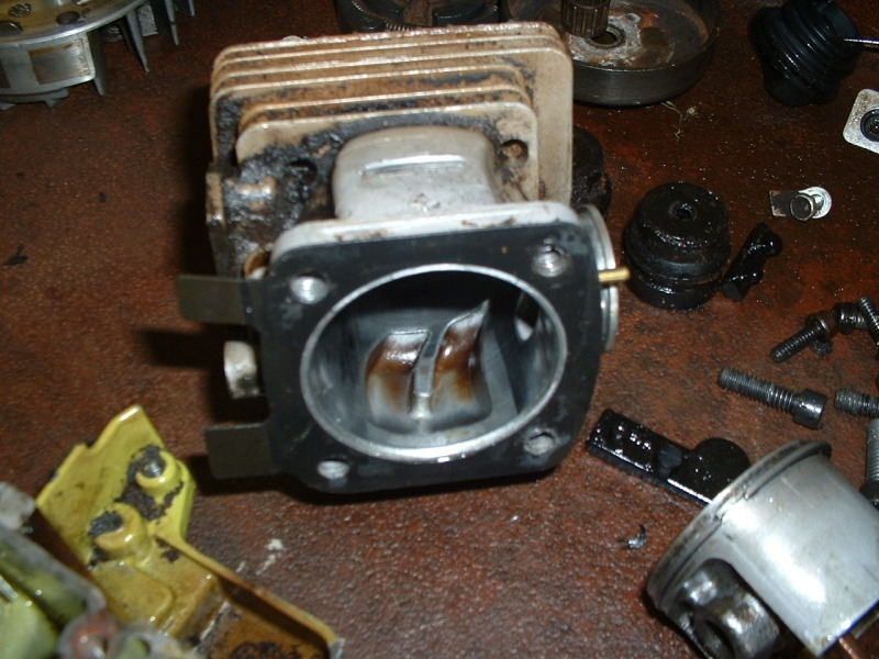

We were talking about open port designs in my group.
Check out how close the poulan 60cc and husky 66 268 are.
