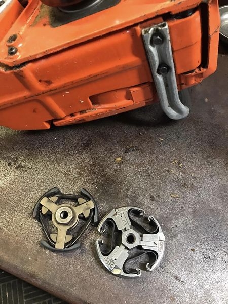

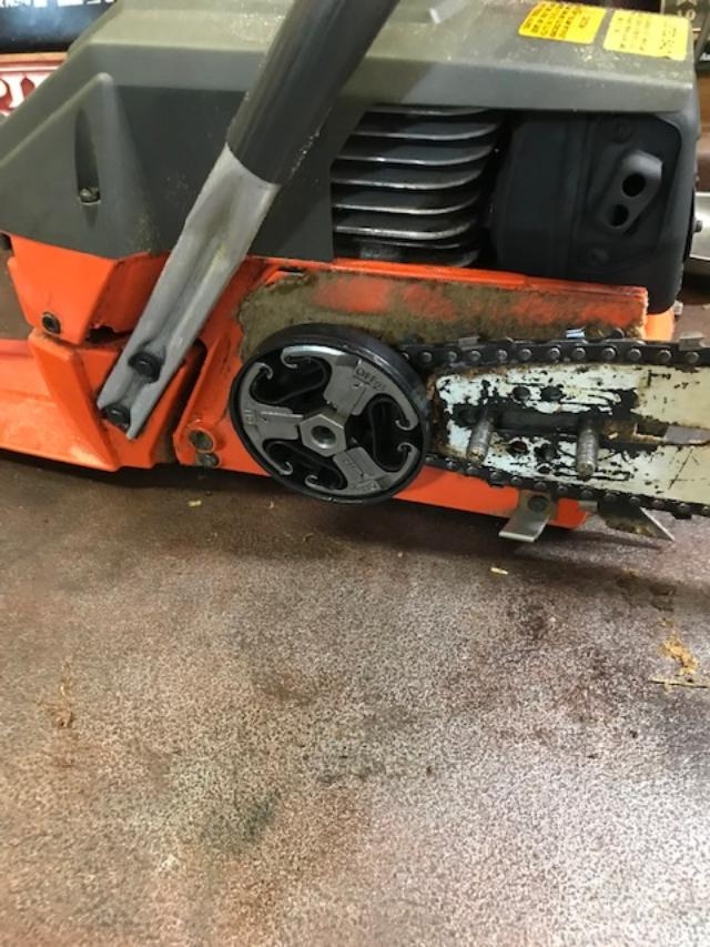

Somewhere in shop I have a NOS spring for 61 clutch. I bought it for a 415 475 clutch many years ago but switched it to newer 505 etc one.
Well when I got 61 I put it somewhere safe to replace this 61 spring. I searched 2 days for prob few hours and gave up.
I know I can cut old spring and heat to bend to reattach it. But that’s a last resort thing for me if had to. I know I will come across that dang spring someday now. 😂🤦‍♂️
So just updated this 61 to the newer style they went with later. Creep gone and works good.
More like the 372 design clutch.

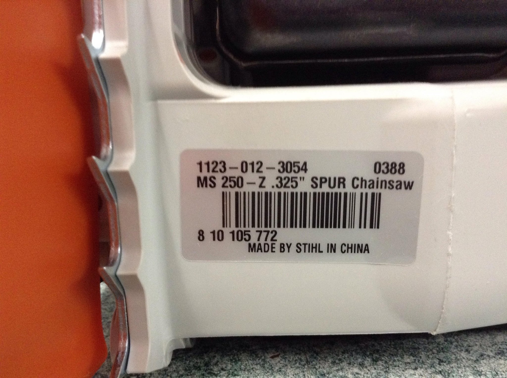

What ever helps you sleep at night thinking that. :ROFLMAO:
Father law and uncles retired GM. Friend engineer in GM. Friend retired Ford engineer.
Lot of OEM cars and truck parts not even made in US.
Why you think were are even building a chip factory here is Ohio right now. ;)
Lot the parts sourced from overseas. If you believe otherwise your living in a dream world.
So high end alternators, starters that are new just like I said.
Back to saws. Even if China, Germany, Sweden, Japan made.
Since there is no real made US saw anymore. Just assembled with domestic and foreign parts ones.
View attachment 881002View attachment 881003
Again, this is NOT about buying things from overseas or any other country. I will agree that it's difficult to buy anything made in the U.S. these days....This IS about buying STOLEN designs such as cloned chainsaws, or any other stolen designs. There is a very real difference....

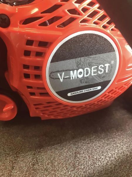

US dealer feedback = I've been running the V-Modest version for a few weeks (videos on the Tube) and it does good. Definitely not the high end screamer my Echo is but it has way more low end torque. The throat in the carb looks smaller so that makes perfect sense. I also sell the KNK Power version which has a much bigger muffler but still doesn't rev real high. When it comes to actually cutting with them the torque seems to make up for the speed. They spin fast enough to keep the chain from chattering and you can lean into them without stalling the chain. I've got 1 of each out for porting and can't wait to see how they compare when i get them back.
I know the guy doing the porting and he is top notch. He did the 2511 for the dealer too.

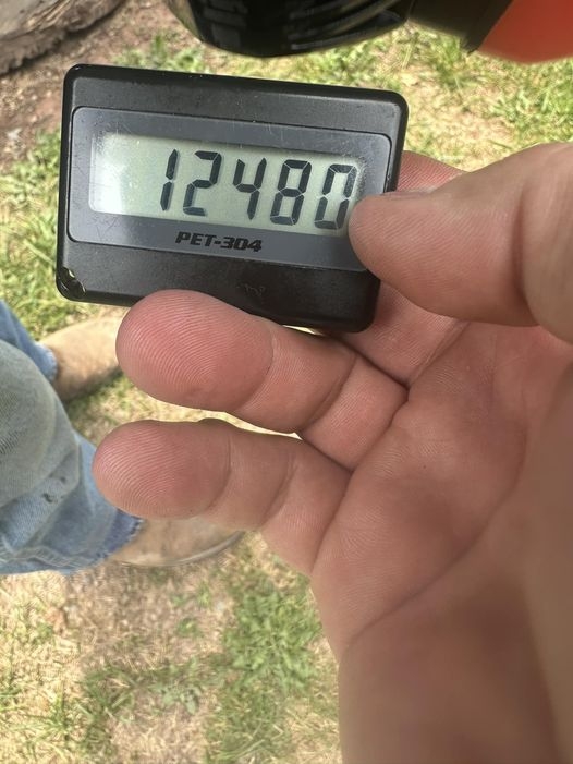

This US dealer shows a little different rpm with his clone 2511 then what has been said by another.
40:1 right out of box. He stated it does just like his oem ones he takes out of the box.
Going under knife next for some porting.

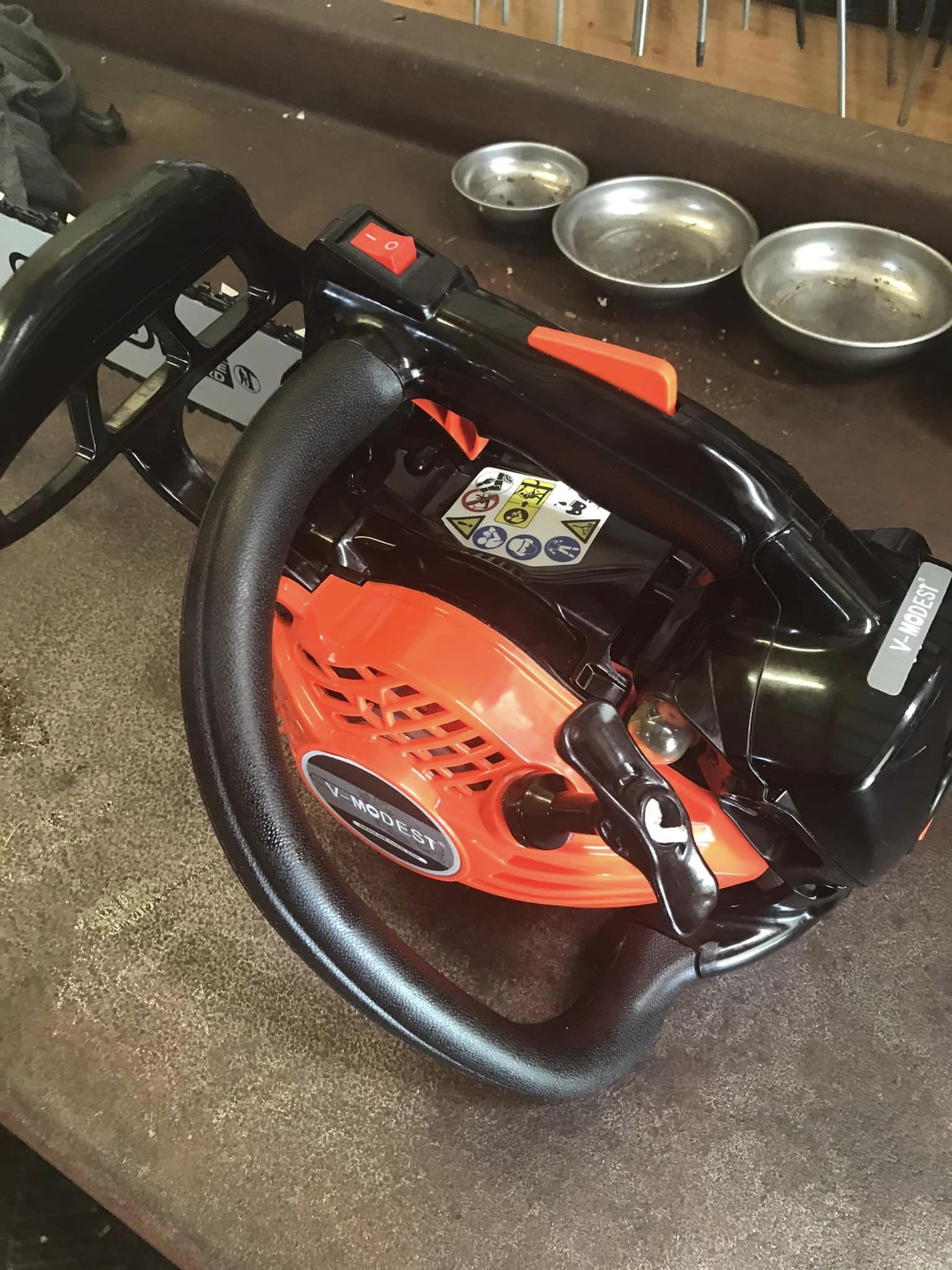

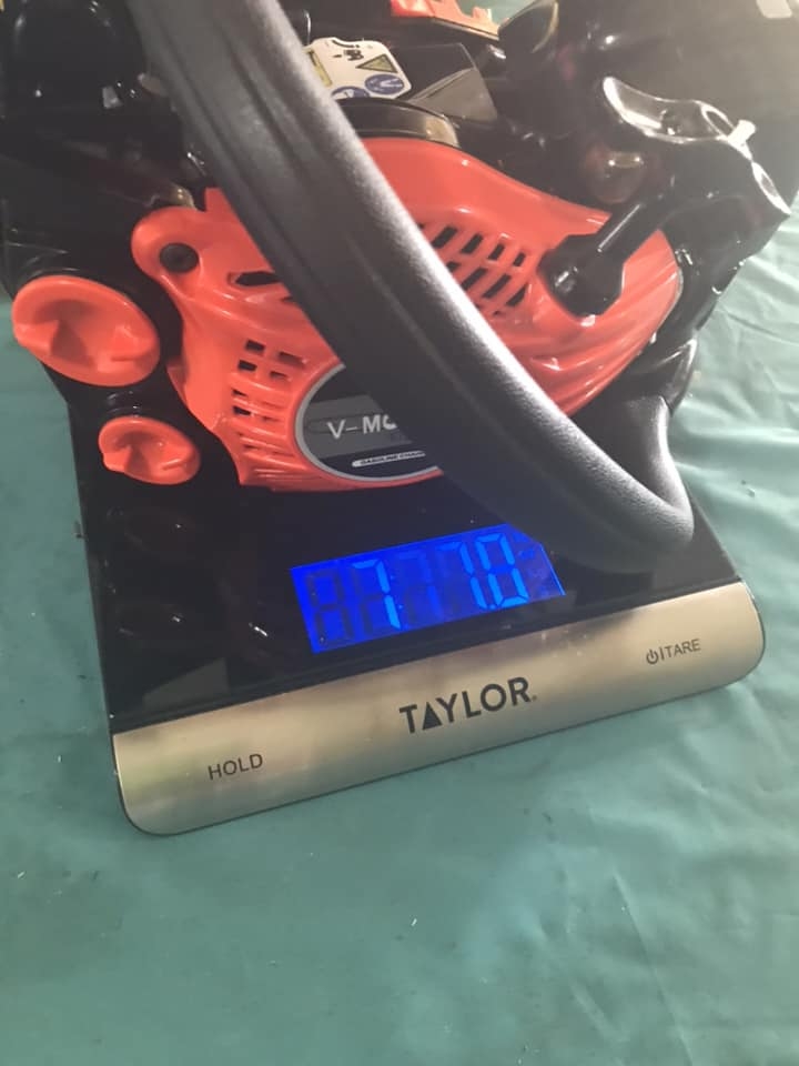

Everything being bought from 2 USA dealers.
Not one to shy away from trying out clone saws.
Got my arm twisted this week.
Clone 2511.
Since we already know the pho dry weight. Like 2oz more due to extra bar stud and nut we figure.
I did this weight with 12” 3/8lp it came with and both tanks full.
Mine was only 10.8K out of box with bar chain on checking after test cutting.
So will retune after get some mix through it. If she likes it prob settle in the 12's somewhere. I like safe not on edge of max.
Getting the 12" 1/4" mini micro cutter 043 bar chain and spur drum set up for it now. All ready ordered.
Oh there is even a rear handle version now too ;). Also make that 5 top handle versions I have seen now.
What you see was 140 shipped to me from US dealer in state next to me.
The 12" 1/4" micro bar, chain, drum, bearing set is 50 shipped by US dealer I just ordered from 2 states away. .

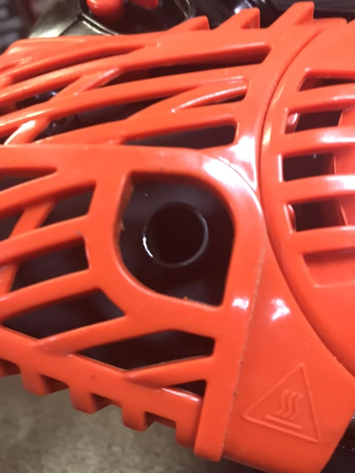

To cool. The muffler is a hollow can with pipe already. Flows fine. Nothing going to be modded or added to this one.
