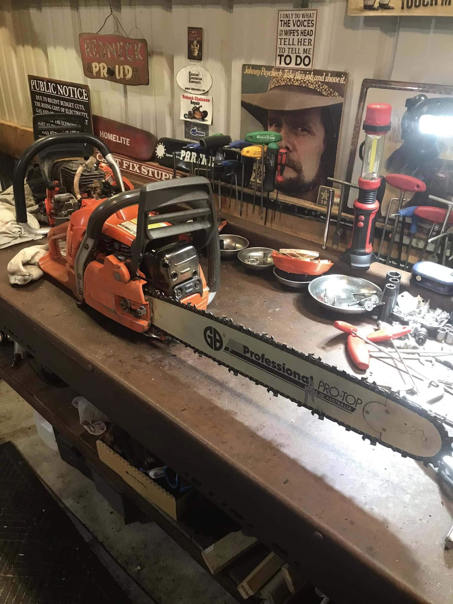

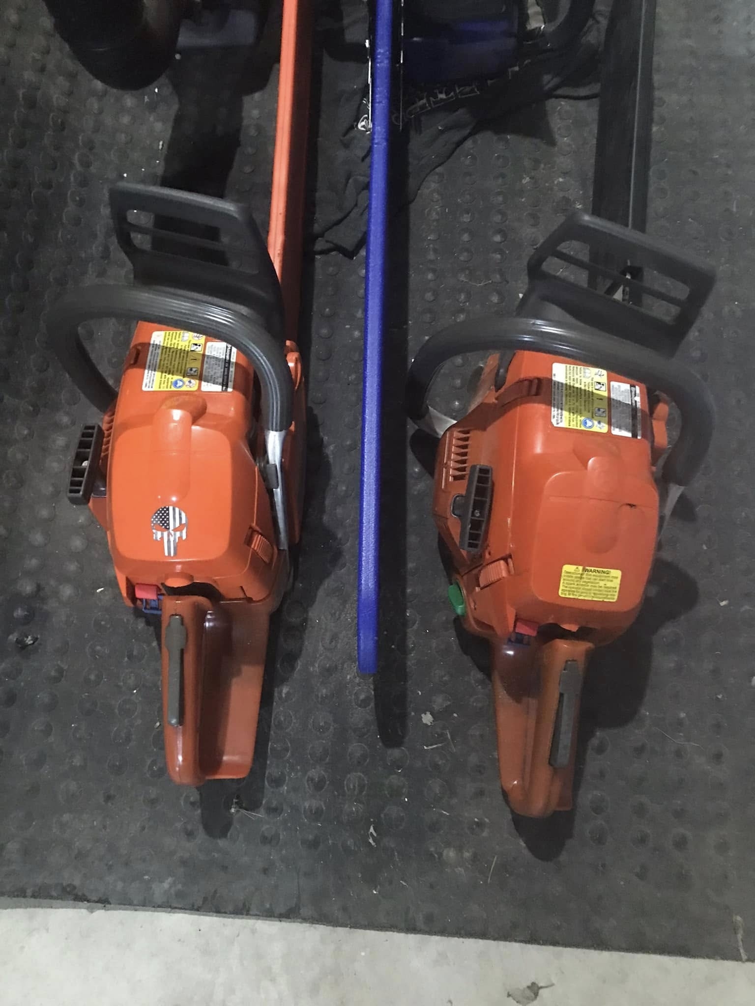

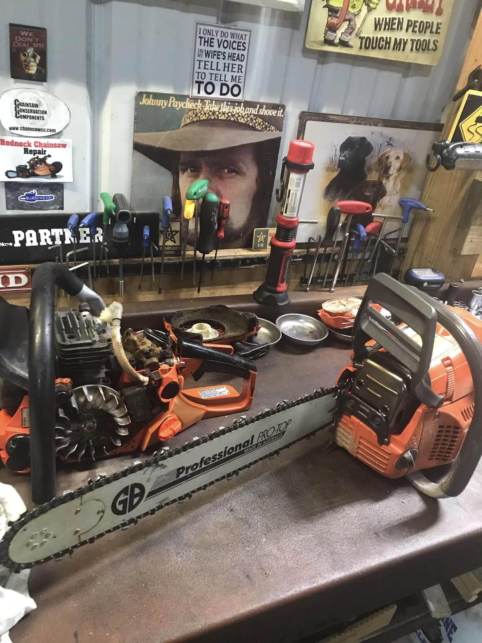

Took some trades on my jred 670 champ I had redid a few years back.
Was suppose to be getting a running 353 and running parts saw OE 346.

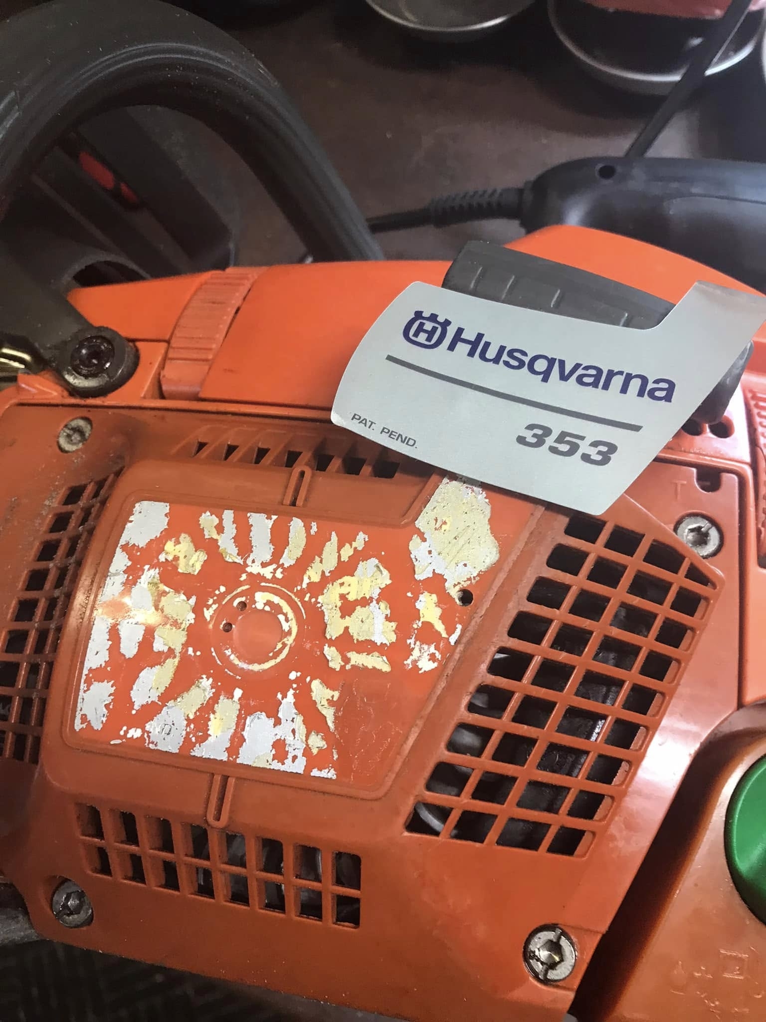

Well well what a surprise when it arrived. Someone fooled last owner. 353 decal on a 359.
So got the heat gun out and got that 353 decal off there.
I have a ported 359 so not worried but was surprised when opened up box and unwrapped saw.

Well Kevin, it could be worse and was a 455 Rancher :ROFLMAO:
   / Just another junk chainsaw
#1,954
Yep why I told guy dont worry about it. It's fine since I have a ported 359 already.
I was like never know when I might need to steal something from it.

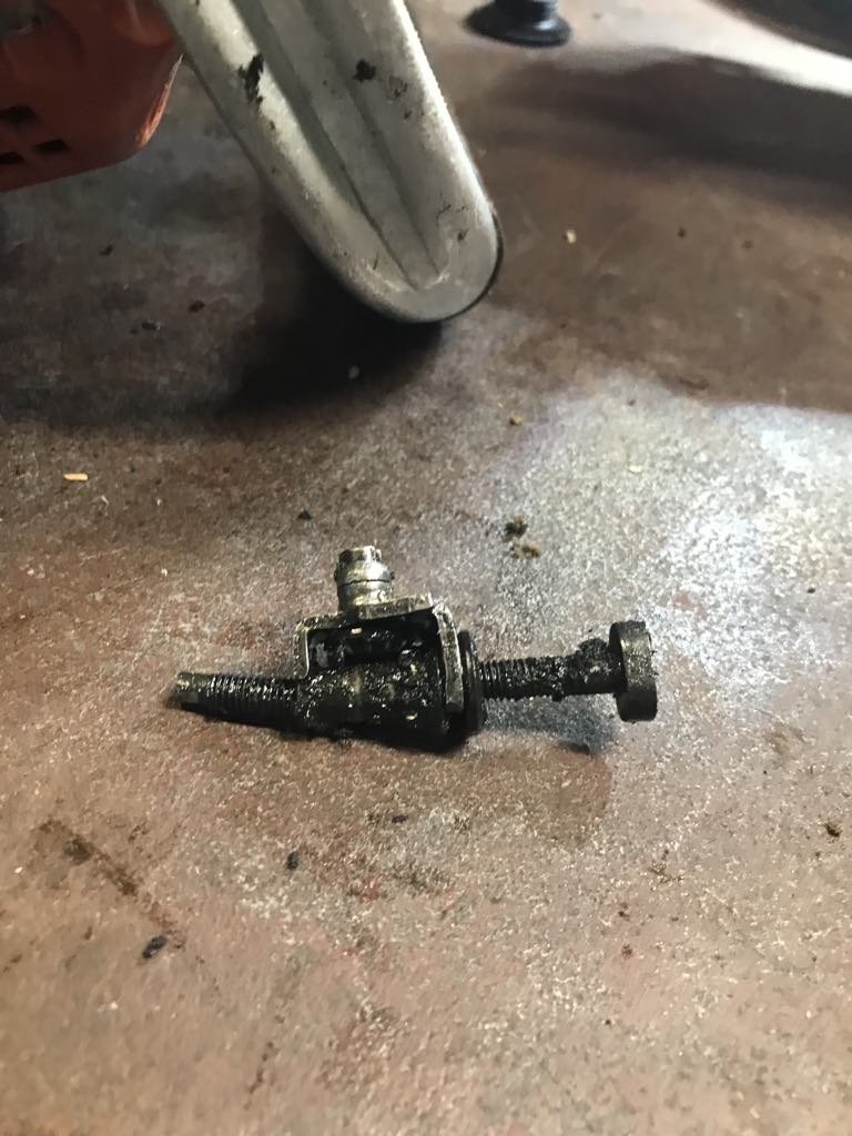

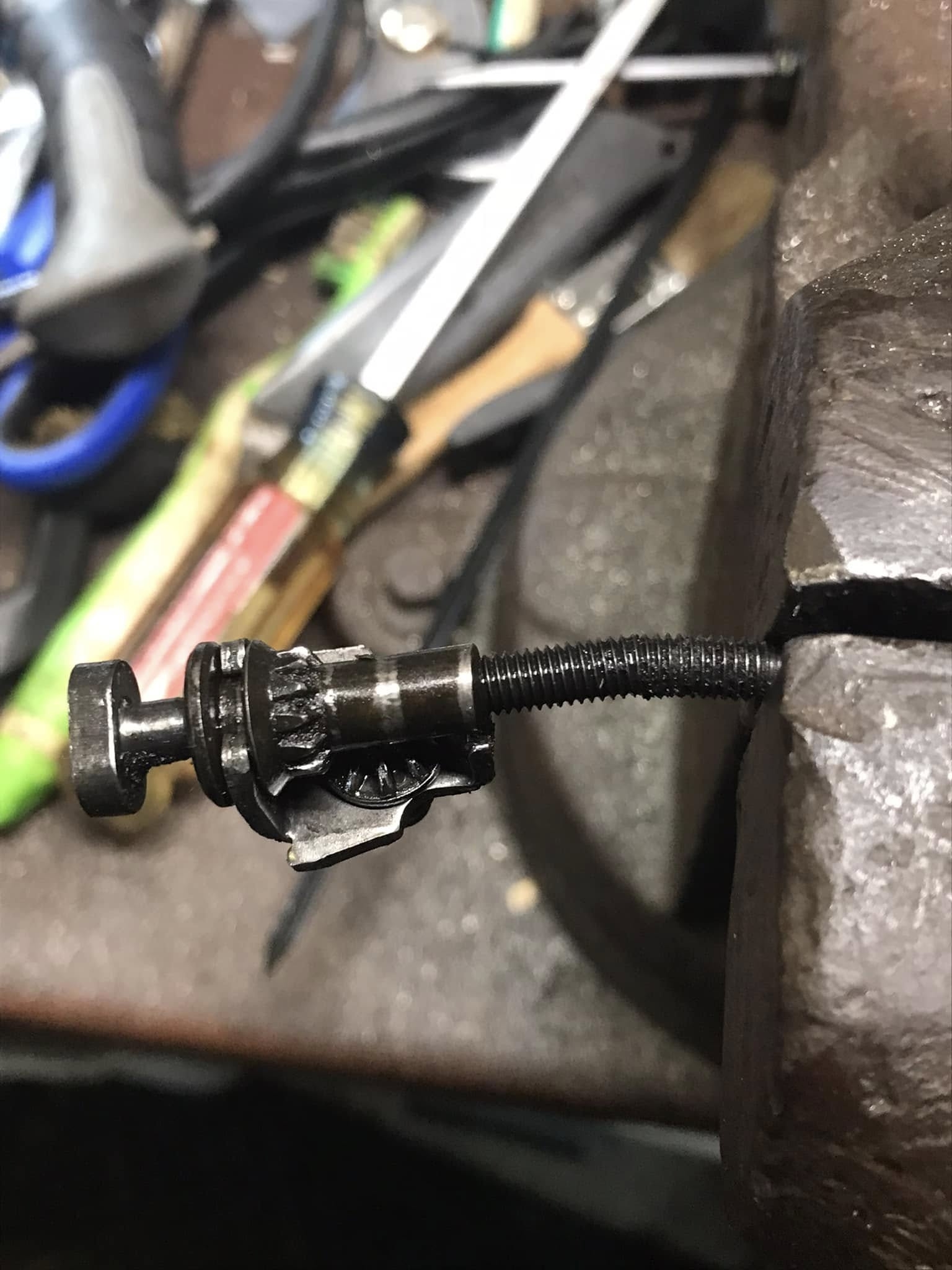

Like today stole the 346 tensioner to put in the new 359.

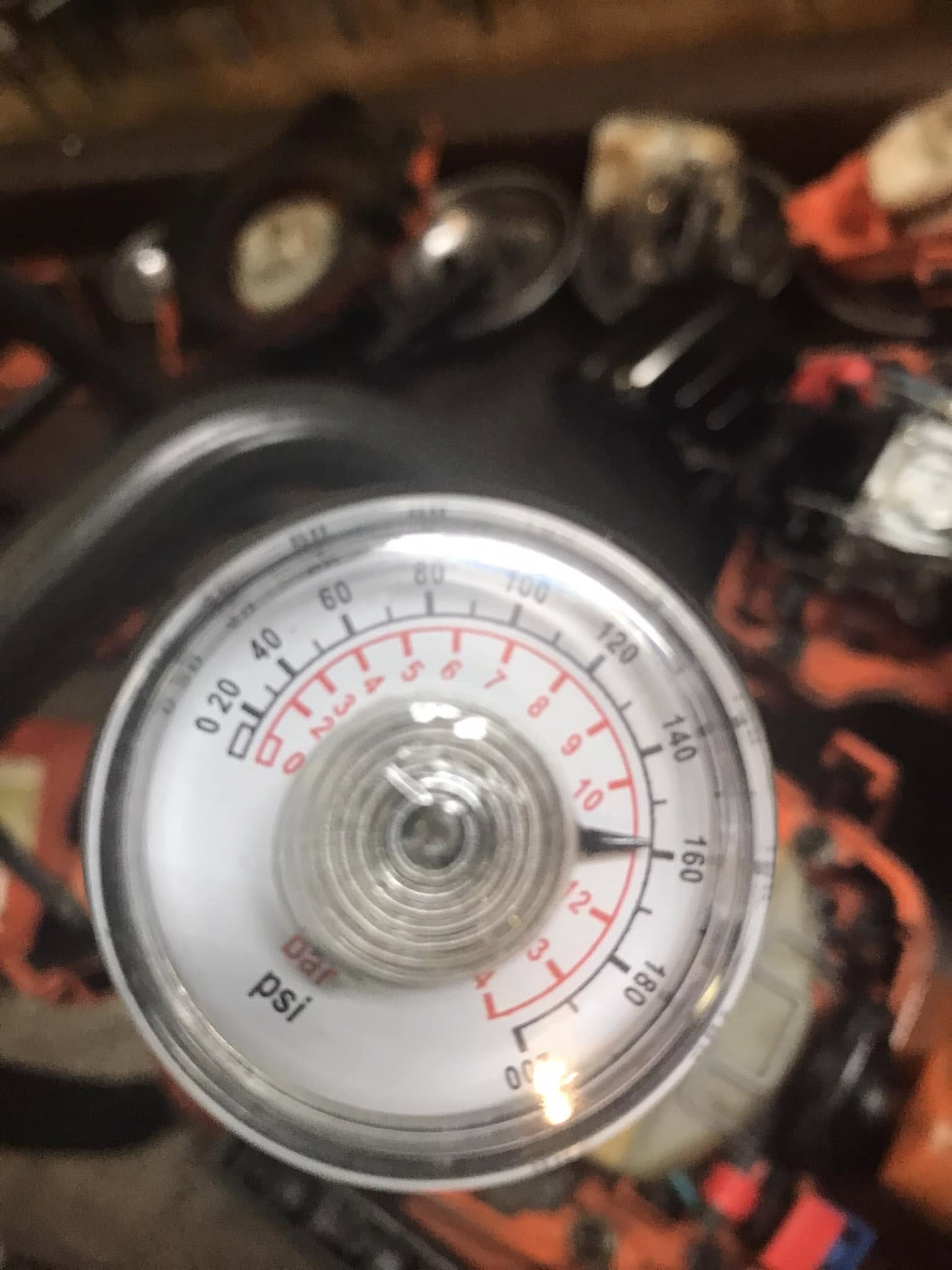

Muffler modded it my free way and test cut with. Already gasket delete and 160psi showing.

#1,956

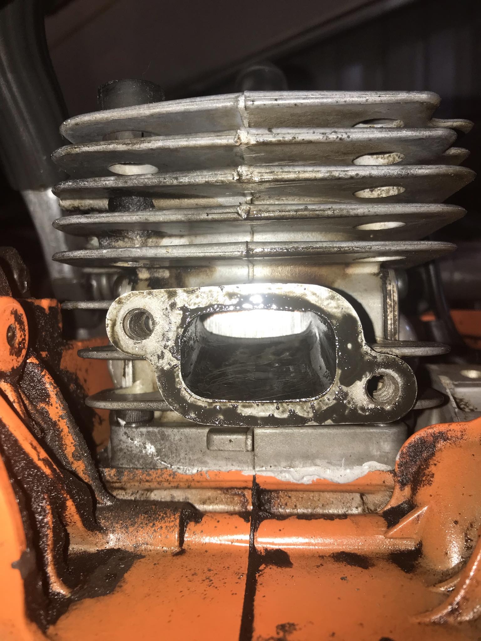

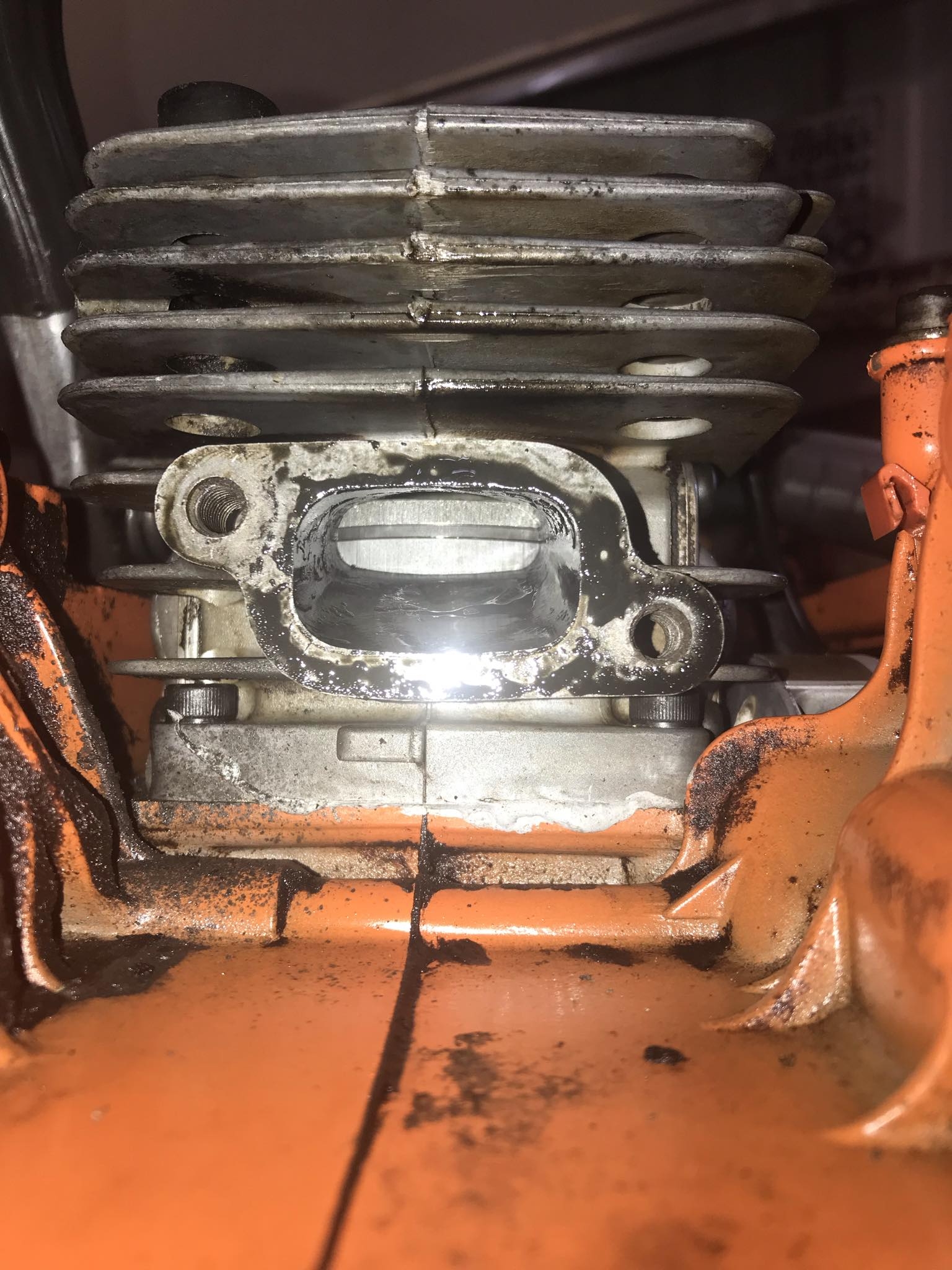

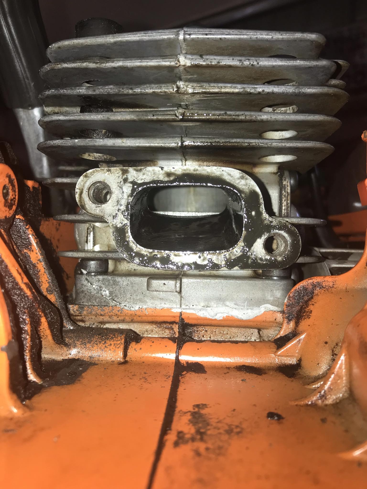

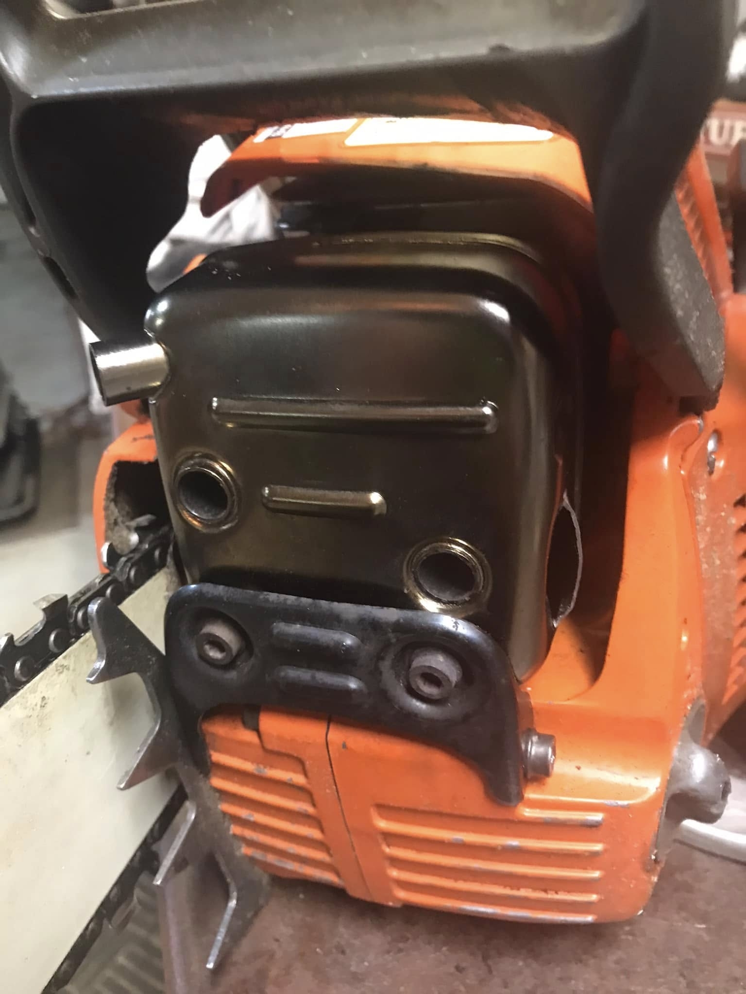

The trade in 359. Did a free muffler mod and open inner baffle couple more besides the one they come with. Gill left side.
Already has gasket delete.
Took tensioner from 346 for now.
Test and cut like a muffler modded stocker.
Echo clutch tool works for these.

#1,957

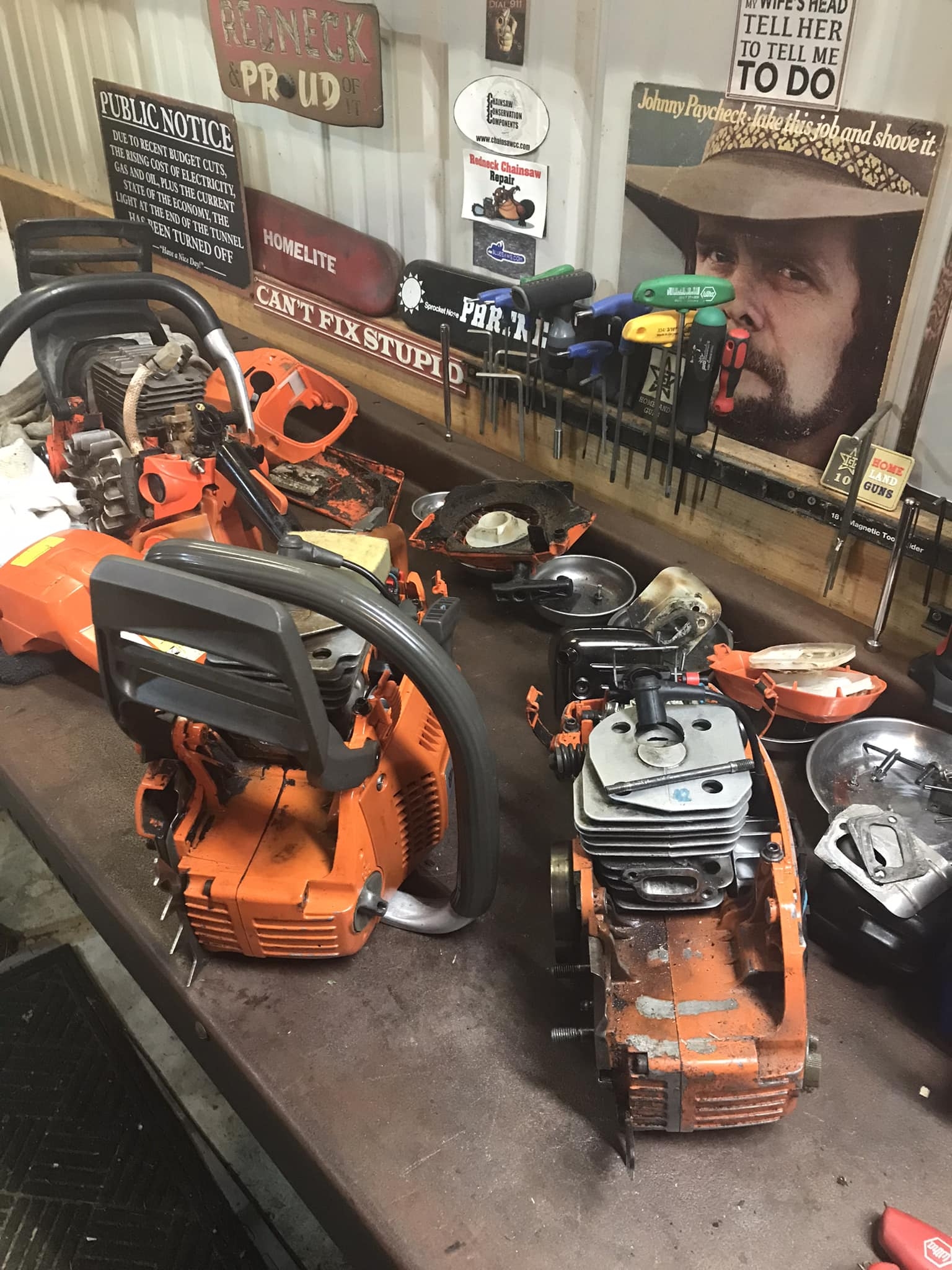

People need to stop using used oil. Nasty thick black residue all had to be cleaned out of whole side under metal plate.
   / Just another junk chainsaw #1,958
I used it once, talk about a nasty mess. Not that my saws are pristine but I do try to keep them cleaned up.

I bought a brand new 359 around 2011 probably and really liked that saw. Wish I had never sold it. What are you going to ask for this one, without bar and chain?
#1,960
It's not perfect looking inside. But fine for use and 160psi. 2009 model
So dont know might keep just to have on hand.
Before I started cleaning up the mess of old mix etc etc.
If I pull it down I will do a fresh crosshatch up after cleaning better then last guy.
Got a new NLA OEM 359 decal coming for recoil too.
