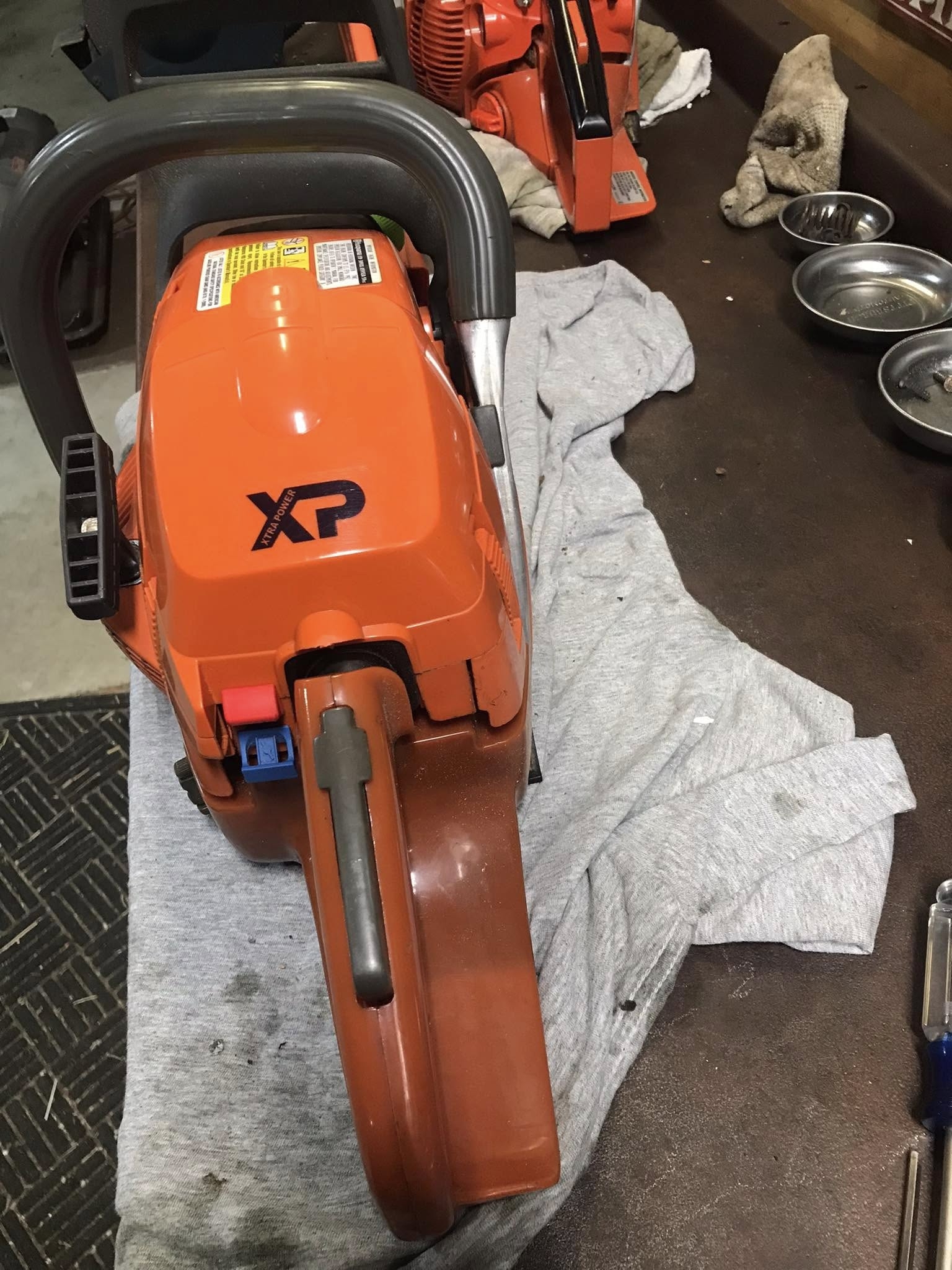

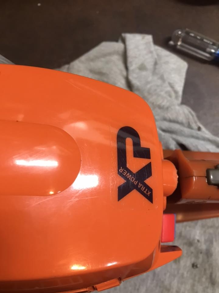

Finally the finishing touch I wanted to add to the ported 359. Just didn’t care for past owners decal selection and removed it.
But without putting the Fabcorp sticker on saw I wanted to show it had Xtra Power. 😁
Even though saw is not a XP.
I wanted to either go with puff xp or a older xp design.
On this one the older 268xp design was the winner in my mind.
Joseph Salva at Sugarcreek decals had what I wanted.
It’s a clear back sticker decal and of very high quality.
Thank you for offering this service.

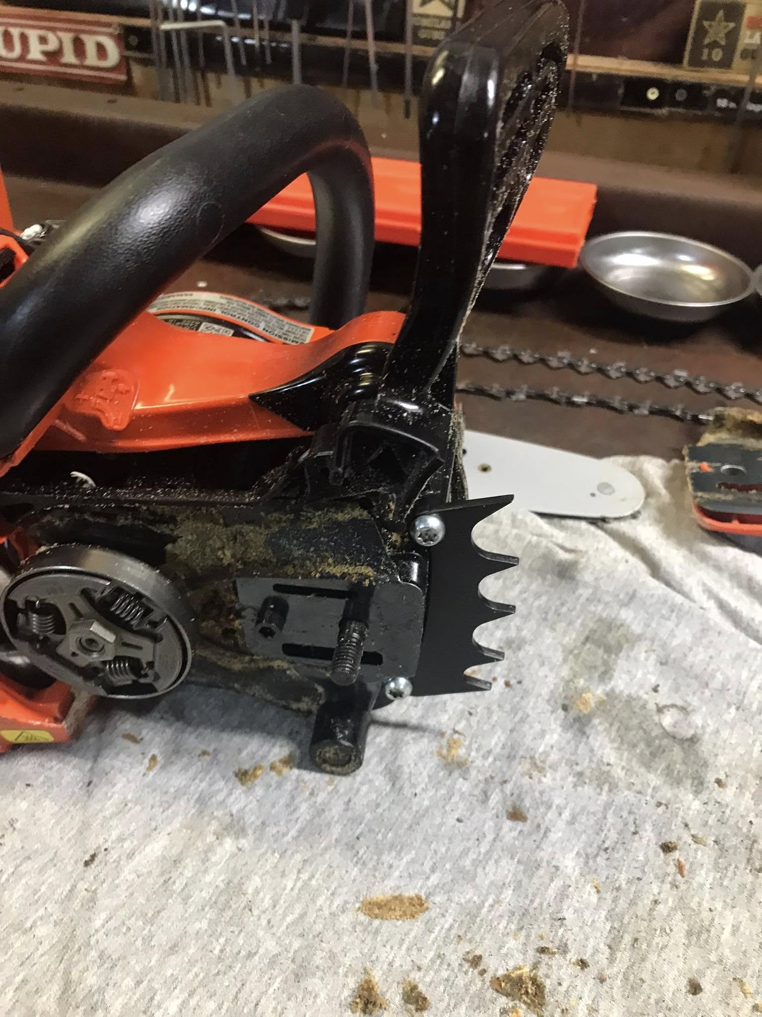

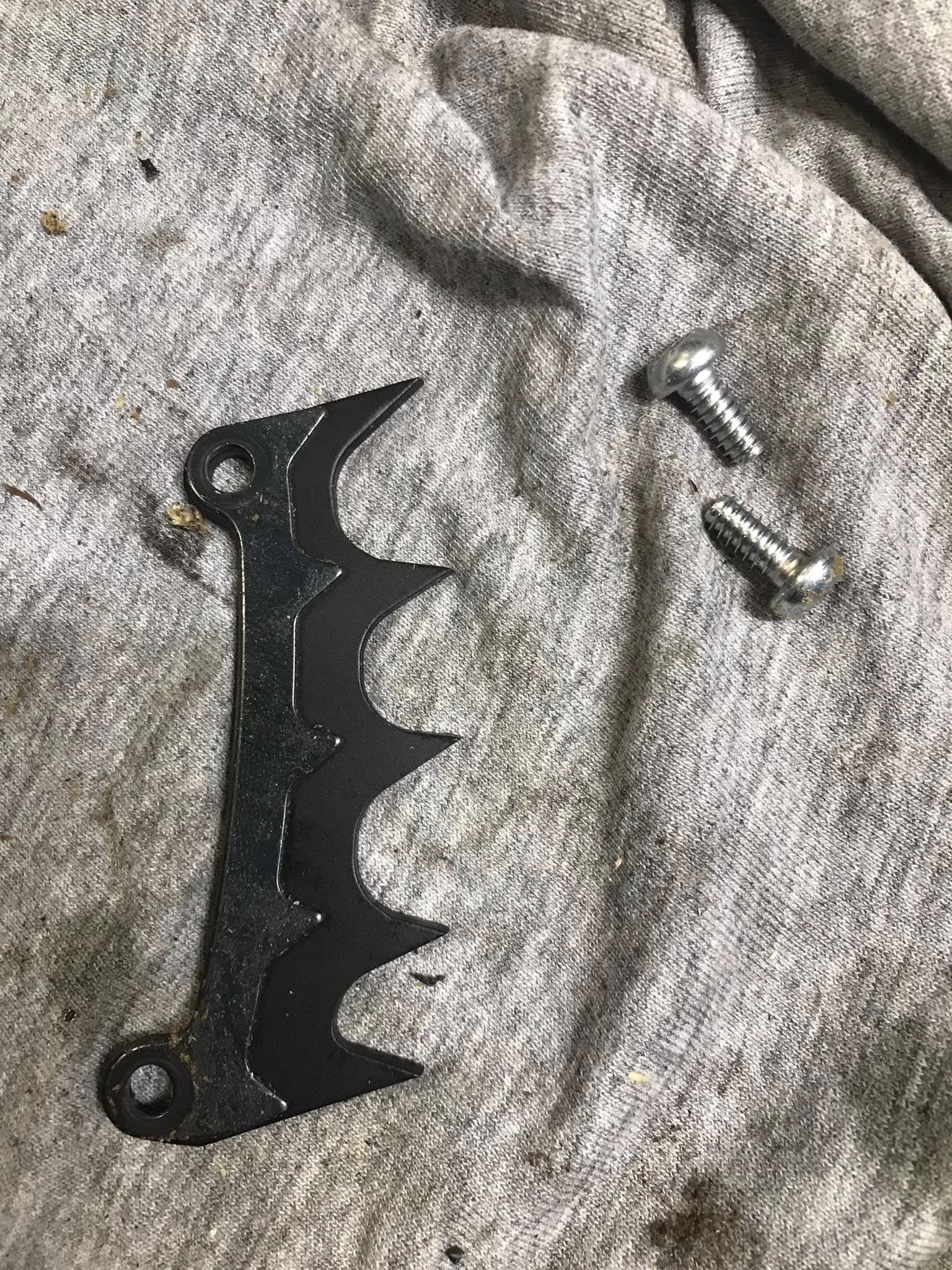

I changed directions on my thinking after some run time on the echo 2511 rear handle PN. For spike I wanted for my uses.
So I went with a 5 point bigger spike over the 3 point I was going to get.
Pics show how much longer and thicker over small oem one. With same spike angle design.
10 bucks shipped.
OEM one basically worthless. Look how tiny.

Where did ya get this at?
   / Just another junk chainsaw
#2,076

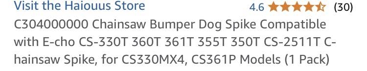

My wife was making a order on amazon actually and saw it there. Same one that cost double the price on ebay. 10 shipped.
I figured worth the try to see before going to a 3 point Jason Egan spike I was going to get.
