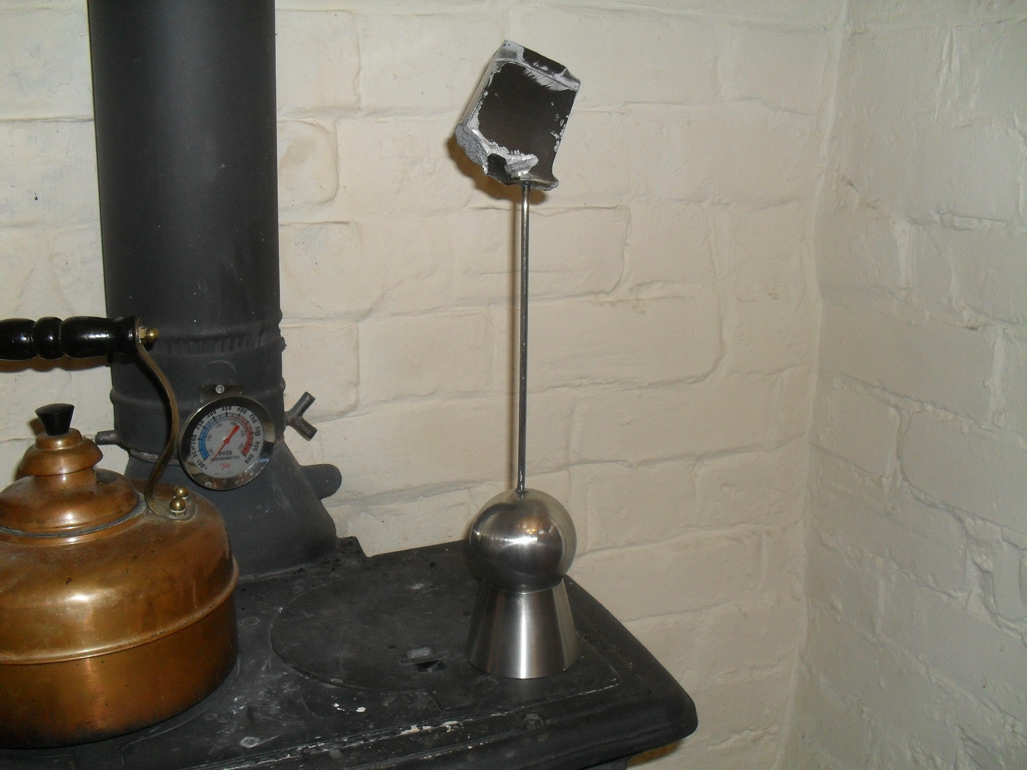

Thats some peanut-buttery drill bit. Never seen a (good) bit do that.
You said its made in the UK? PLEASE tell me its not a Clarkson-Osbourne. Thats my usual brand (or Dormer). Id hate to think quality was slipping.
/ Just bent a drill bit
#29
Thing is that the bit did drill into a hardened steel ball bearing when other bits wouldn't even scratch the surface.
I'm thinking that only the tip of the bit was hardened or coated with whatever.
My fault it broke though, if I had followed the rules and clamped the ball before drilling then maybe the tip wouldn't have snapped off the bit and jammed the drill in the ball which then began to spin out of true till it bent the bit. The ball was very heavy.
did the job though:thumbsup:

Well you're right of course and I haven't had to sharpen any of mine yet and that is the first one I have had any trouble with.
Here is the finished trophy for my friend who wrote his car off on a wet roundabout.
You can see the size of the ballbearing in this pic, I drilled into it just over an inch and it isn't just case hardened steel it is stainless steel (not magnetic and very hard)
The bit on top is a piece of his wheel that was picked up off the road, we are to present it to him tomorrow together with a photo of him alongside his wrecked pride and joy with his head in his hands:laughing:
All in good fun and he will treasure the trophy I'm sure.
Serves him write for not buying a Lotus, he went for the cheaper Vauxhall alternative :D
(you may have noticed that Sutol is Lotus backwards)

I can only think that the bit was so hot that its shaft was softened allowing it to deform after the hardened cutting edge had snapped off.
Unless anyone has a better explanation:anyone:
Bound to have been a carbide tipped bit.

Diamond sharpens carbide just fine. Green wheels [silicon carbide] would be 2nd choice.
