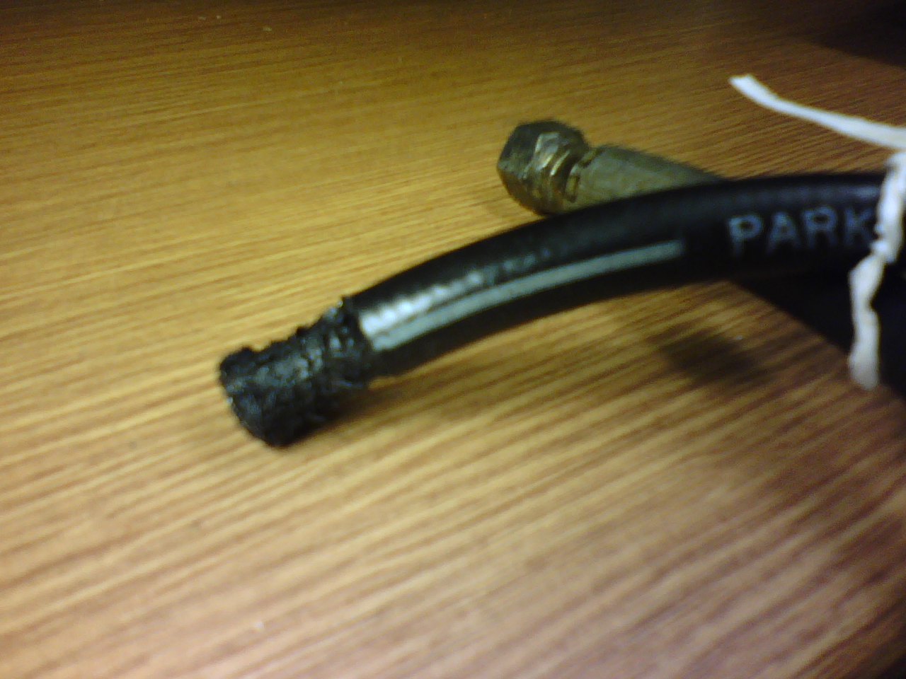

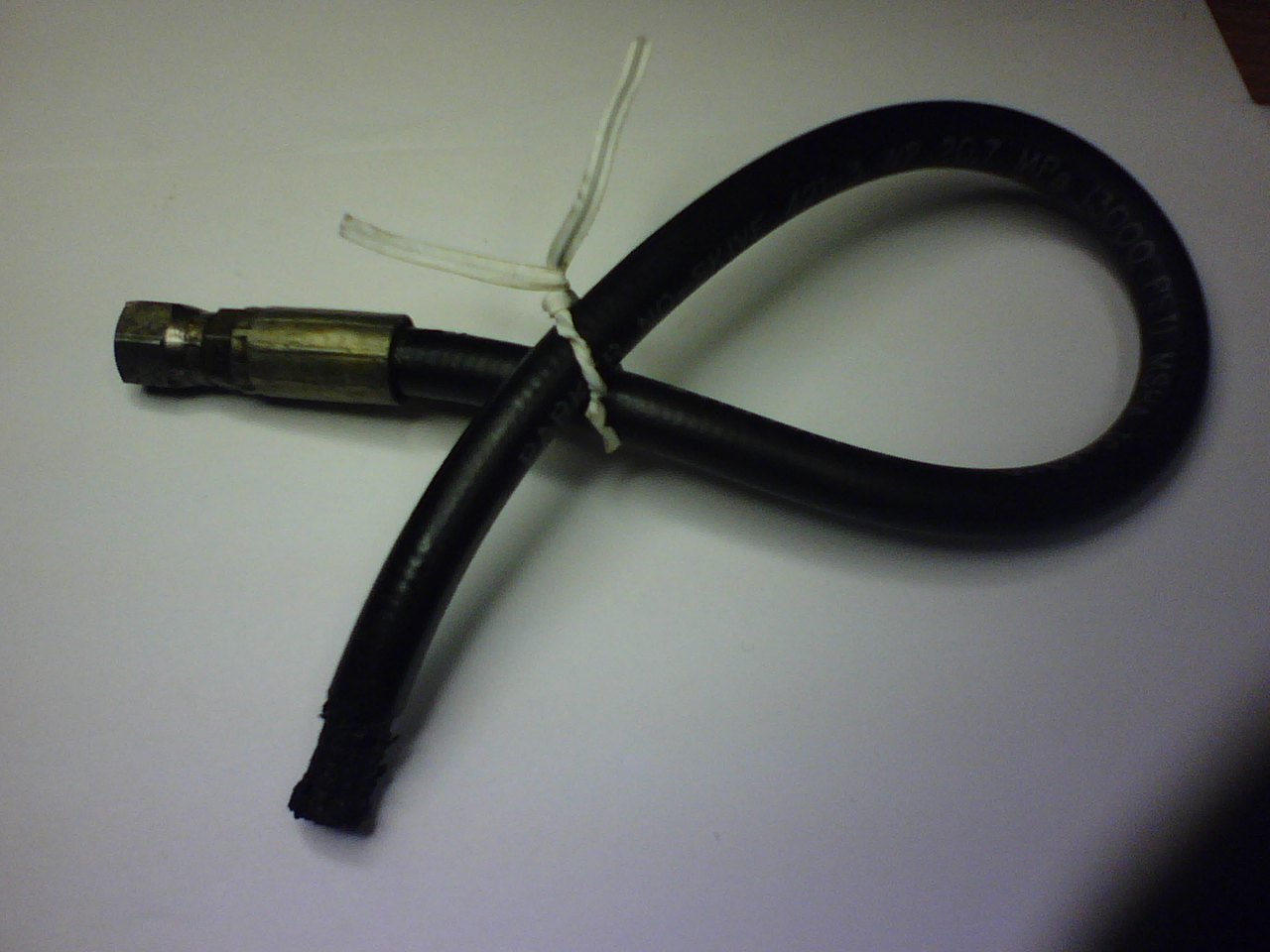

Had my first hydraulic failure this weekend.
Mowing the lawn, and all of a sudden there was a little river of hydraulic fluid purring on my feet.
One of the hoses from the steering cylinder to the steering wheel pump "degloved". The JIC fitting pulled off the hose, taking the rubber sheath off the hose in the process. I screwed the hose back on the fitting so I could drive (carefully) back to the garage.
One of the interesting things was that the hose had almost all the insulation rubbed off where it was zip tied to the other hoses in the center column of the tractor. An accident waiting to happen.
Fortunately, it was easy to just detach the 3 foot hose from both sides and carry it to the local Parker store. I was thankful it was not one of the hoses that ran all the way to the engine compartment. $30 and 20 minutes later, and I am back in business.
   / Just blew a hose #18

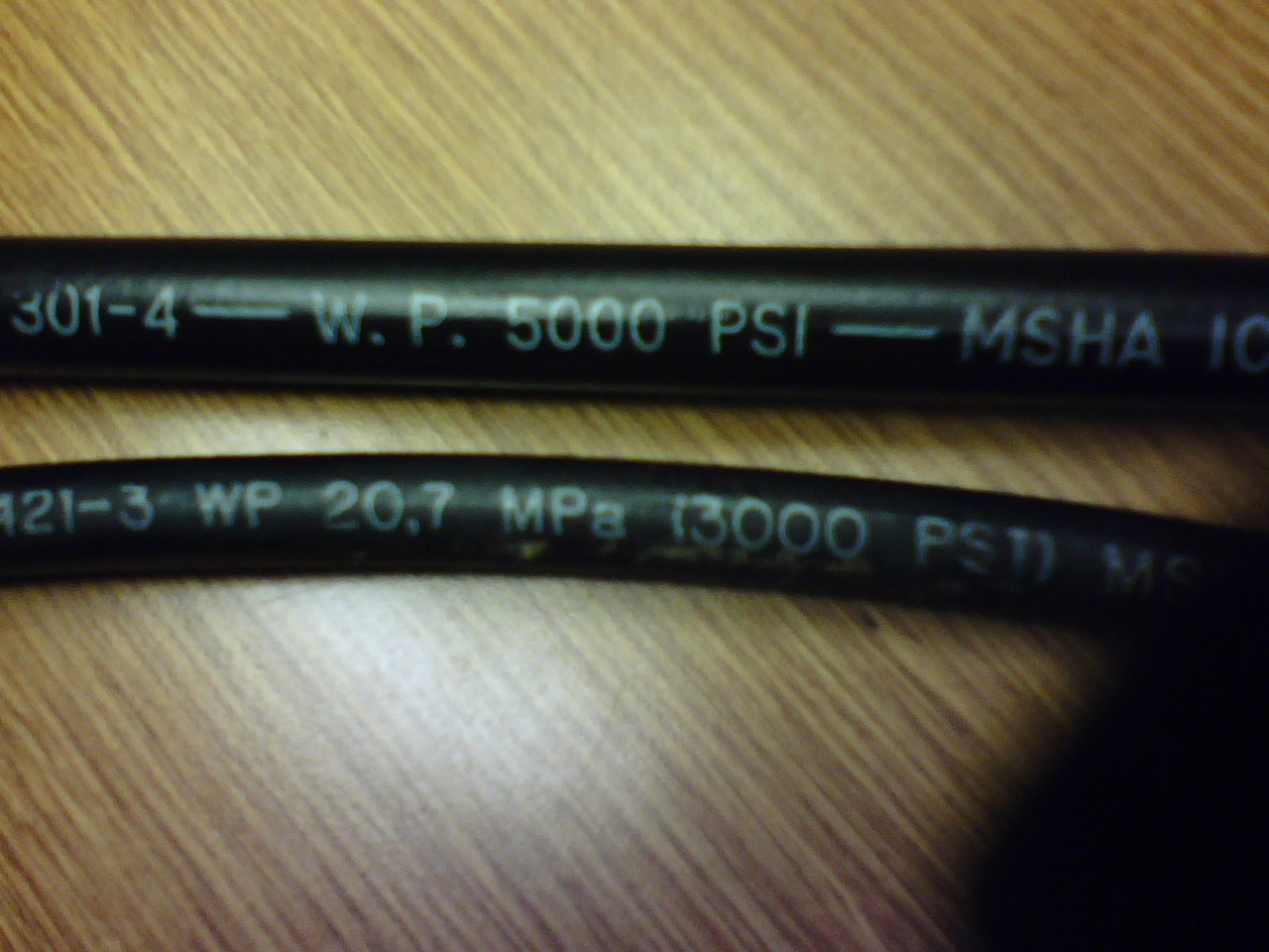

This happened to mine. The end pushed off the top of the lift cylinder next to the lift tilt control valve.
Writing on the old Power trac hose reads PARKER NO-SKIVE 421-3 WP 20,7 (3000 PSI) MSHA IC-40/10 SAE100R1AT-3 5 mm. I replaced it with a
PARKER NO-SKIVE 301-4 --- W.P. 5000 PSI ---MSHA IC-40/10 ---- ---- 4-2Q88. TYPE AT --- MIL-H-52471/5 ----- シ X 2W------- SAE 100R2
I know what some of these numbers mean but certainly not all of them.

That looks exactly like my hose looked. I wonder if this is a typical failure mode, or if Power Trac's hose crimping machine is turning out duds.
The steering cylinder doesn't see as much work or pressure as other hoses, so it is surprising to me that it would fail first.
   / Just blew a hose #20
One thing I would add is that I am amazed at how quickly hydraulic hoses rub down. I never thought of that as the hoses appeared to be static, but I guess they pulse more than I can see and I have had a number of wear spots that I have replaced.
