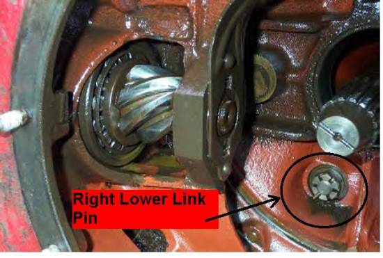

This is the second time i have heard this, and I am dang intrigued. Please elaborate on the process I would need to go through - took a hard look at the PTO last nite, my arms are plenty long and I bet I could reach in there......way way way easier than the trumpet route /forums/images/graemlins/crazy.gif
As for the gear oil. i am using the TSC oil 'for older Ford tractors' as was recommended on ytmag.
   / Just bought 2n, have some questions #22
Re: leak
Put a good sized drain pan under the PTO shaft, or nose the tractor into a ditch. Pull the four bolts holding the PTO shaft in and pull it out. Look at the bolt on the outside to get an idea where the nut would be on the inside and reach on in. There is a cottar pin through the nut you have to pull and then you can get a socket on the nut, I forget the size. The PTO shaft is out of both of my 8Ns but I don't have the time right now to pull a cottar to put a socket on the nut to size it. The boys over at www.ytmag.com in the 9N- 2N- 8N forum could probably tell you the size off the top of their heads.
   / Just bought 2n, have some questions #23
Re: leak
Here is one way to handle the trumpet alone...
Once you remove the left trumpet(sitting on the seat is left), you can repair the right seal by removing the ring and pinion gear..
Any other questions, mail me....Ken N Tx

Here is a picture of the nut on the right side.... ring and pinion removed..
