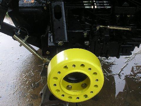

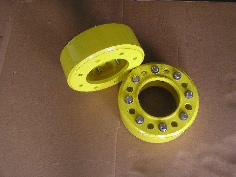

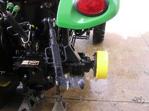

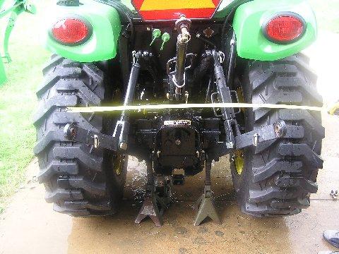

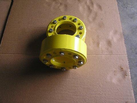

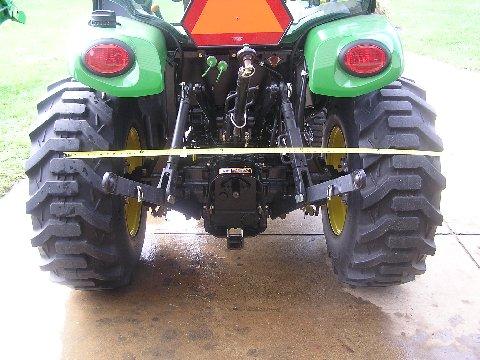

dirtworksequip said:
... I then ordered 4 inch wheel extensions from Unverferth. The biggist drawback with them is they are expensive ($720.00) ...
... I ended up with a 66 in rear wheel track which made the 3520 alot more stable. ...
Here are some pictures of the wheel extensions metioned by dirtworksequip along with pictures of his tractor with them installed. It's one mean looking setup and it certainly appears more stable.
Dirtworksequip, it appears you only put them in the rear and not the front. Is this the case?
Thanks to dirtworksequip for sharing his cool modification.
They look great and make your tractor look better also. The hard part for me would be getting over what they charged you. I can't believe that they charged that much.
They are certainly beefy but not $700 beefy. I guess the expense comes from the fact that these are very low quantity items and that each set needs to be made custom to a particular wheel hub configuration. Economies of scale I suppose.
That gets me wondering. Is there any standard among compact tractor wheel hubs (bolt patterns, etc.) or are they all different?

I figured the $720 was cheaper than $25,000 on its side or worse. The wheel extensions did make a big difference,but I still will not take it where I have taken my old JD 870.
