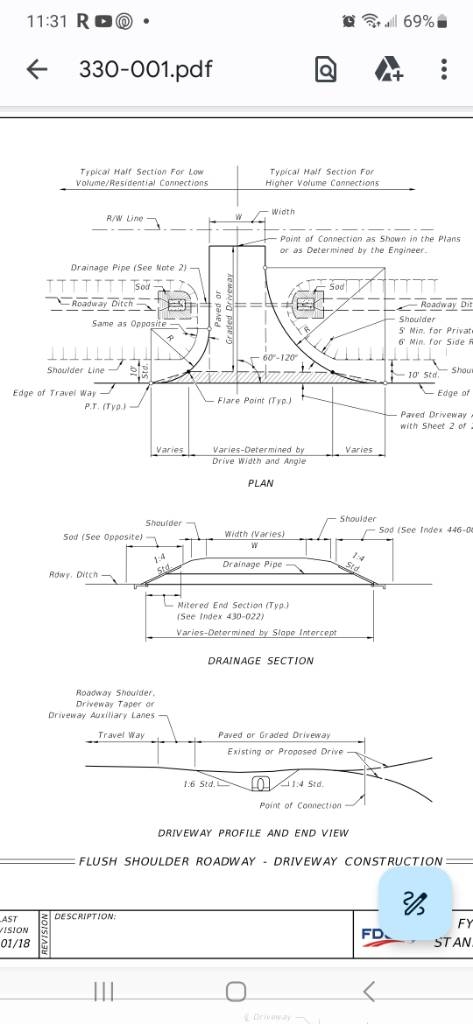

If you can talk the county into a swaled or ditch block style driveway, over a culvert, that will save some $$$$. I think a 40 ft 18" CMP with 4:1 cut miters is around $1800 for just the pipe. If you do have to do the culvert; go with 40 ft over 32 ft; you won't regret it down the road (unless they spec the length in the permit).
Swaled drive basically goes down to the flow line, following the existing grades/slopes; and allows free flow of water. If that creates a slope of greater then 10% down and then 10% back up; you'll drag trailer jacks or corvette noses. Only good with a hard surface drive (asphalt or concrete)
A ditch block drive has a minor low point at the center for water to flow after it stages up; but doesn't follow the contour of the ditch. This works well where there is very little flow, and good percolating soils. Only good with asphalt or concrete.
This all assumes there is somewhat of a swale on their road side; a typical paved road cross section. should be about 2-3% 'crown'; 4-10% grassed shoulder; 4:1 front slope; flow line/ditch invert; then 3:1 or less back slope to the ROW line. Dirt or gravel roads; might have more cross slope or none at all; and may or may not have a grassed shoulder at all; or even a shoulder that is higher then the edge of travel; from a lack of maintenance...
18"x20' pvc culvert is $460. 30ft is $680. County will install for free. I just have to provide the culvert
100% spend the money for the 30 ft. 20 ft sounds wide till you're tired, it's dark, and you're pulling a trailer.

On a state Access (driveway) permit, for a residential; we would call for a poured mitered end section; 4:1 slope on that; then min 2 ft separation from the top back of that MES to the drive; for roughly 10-11 ft more pipe then the width of the 'throat' of the drive, on each side. Allows easier turning movements; safer; and allows you to turn off the road at a min of 10 mph. You shouldn't have to come to a stop in the road in order to make a right turn. The miters allow some over travel without something catastrophic, and also are allegedly safer in a crash than a head wall or plain pipe end. Minium total pipe for a 12 ft wide driveway throat (not the radius or flared part where it touches the road) would be 32 ft; more like 40 ft for a 16 ft wide drive.
I'm not saying to over build beyond what is required at all; just pointing out people frequently underestimate the length of pipe really needed; and 8 or 16 ft more of pipe is easier and cheaper the first time, then redoing it in the future.
