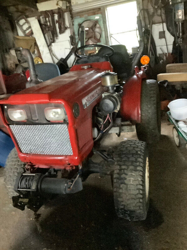

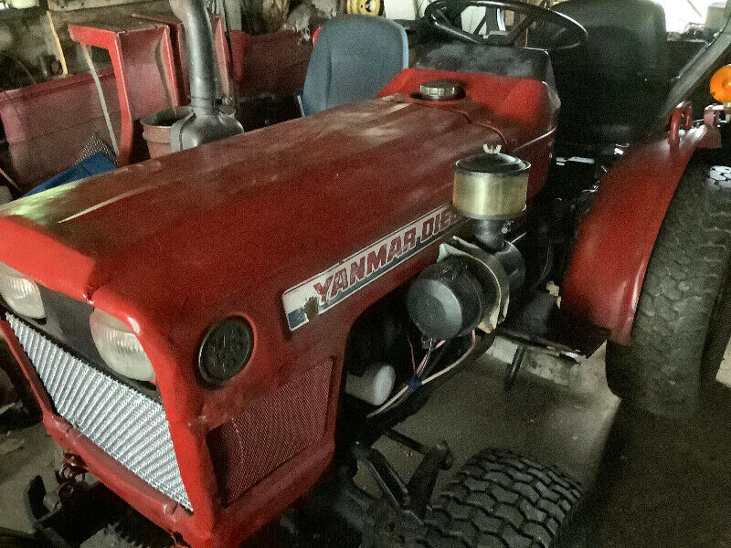

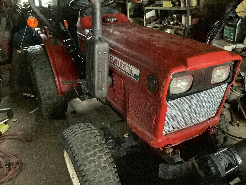

Tractors are new to me. We just bought 6 acre field and it is too much my Cub Cadet 2518 (2WD 20HP Kohler w 48" deck). Some CC repair part shipment delays this June let the grass get ahead of me so now I need a bush hog to make it mow-able again.
I'm hoping the 169D will do the job with a 5' bush hog and a 5' tow mower. The high torque 3 cyl. diesel should help??? but I'm keen to gain advice from this forum. The land has a gentle hill.
Tractor Overview:
  • Everything functions.
  • ROP was sawed to be modified to fit in garage. The seller has metal to modify it for pins. I'll have to deal with it.
  • The tractor has cracked tires so I'll probably have to get a new set.
  • Some weeping from the rad so I am guessing a re-core or a replacement.
  • I forgot to bring a volt meter and the seller had to use a charger so the alternator, vreg, or battery may need attention.
  • No fluid leaks. A bit damp around the front left axle seal.
  • It looks a bit banged up on the hood and is missing the small side panels.
Some photos from the ad:

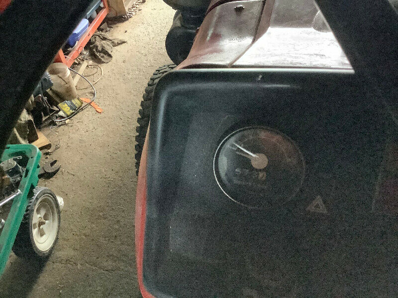

5800 hours on meter

Only 580 hours on the meter but could be 1580. It rolls over and starts again.
Cracked tires won't likely hurt a thing and might last for years.
Make sure you keep the front axle level ok if leaking. If not leaking badly a little Lukas power steering stop leak might possibly do the trick.
Don't let it overheat, these little engines won't stand for it.
Not sure whether a regular 5' rotary mower or a pull behind rotary mower or both. "If" regular 3 point 5 footer that is a little much for the 169, however, doable with proper care given.
