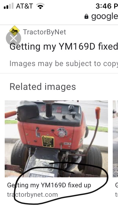

The caption with the above picture I supplied was labeled as a YM169D.
Uh no.
That photo first appeared in this post
https://www.tractorbynet.com/forums/yanmar/201072-getting-my-ym169d-fixed-up.html#post2327897
It shows a YM186D that has PowerShift, and the orange lever on the left is the shift lever.
YM169D has a 3 speed manual transmission. (Both those tractors also have a range selector sending different gearing into these transmissions).

Not disagreeing with you or the op just pointing out that the photo and captions indicate it is a 169!

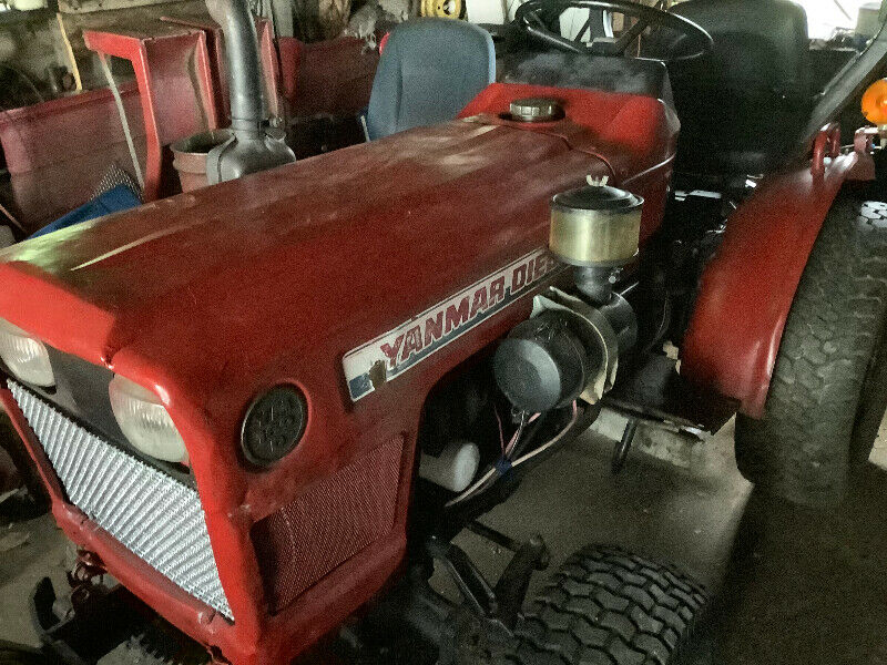

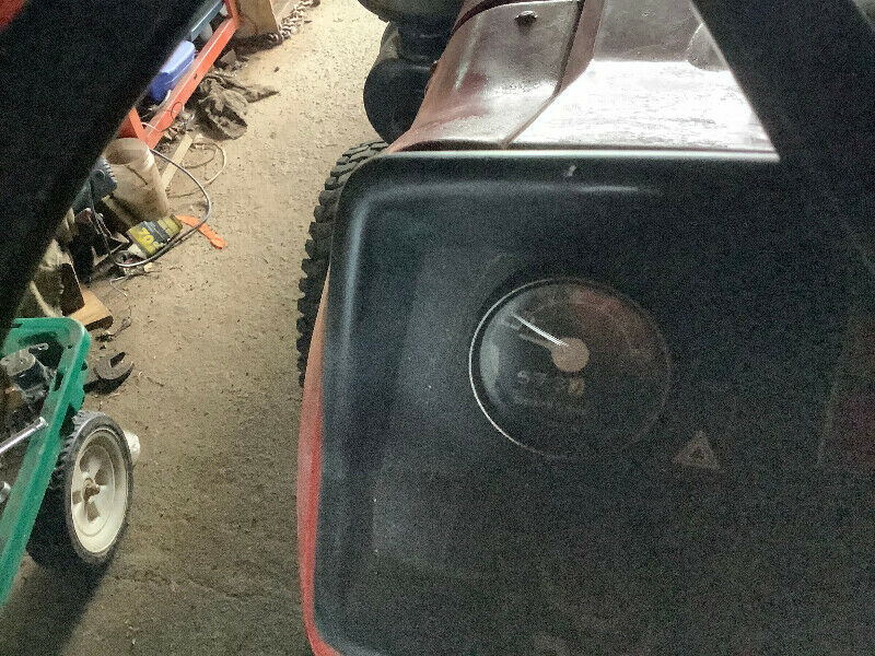

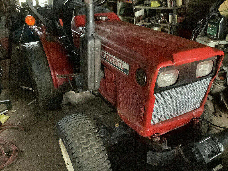

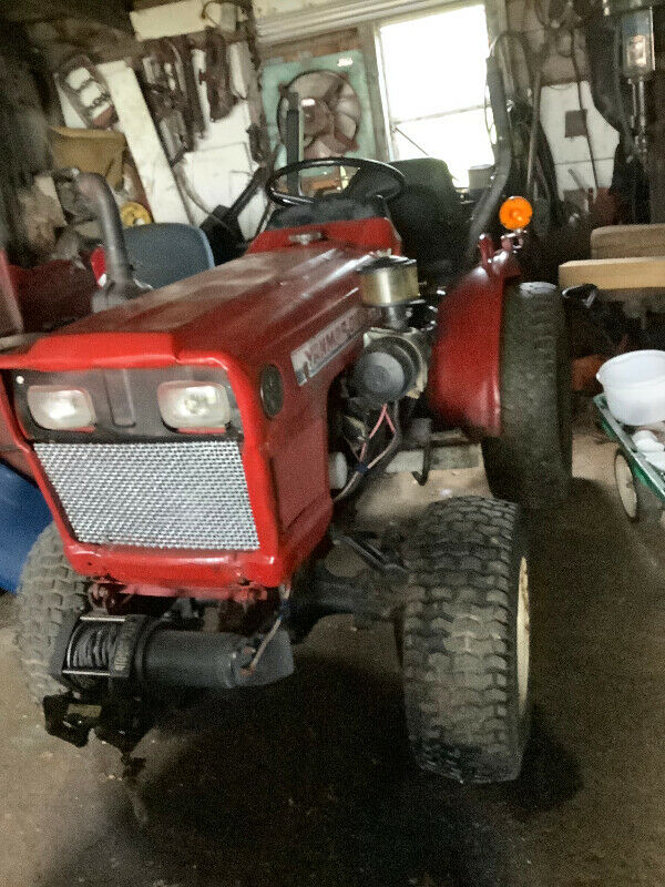

Tractors are new to me. We just bought 6 acre field and it is too much my Cub Cadet 2518 (2WD 20HP Kohler w 48" deck). Some CC repair part shipment delays this June let the grass get ahead of me so now I need a bush hog to make it mow-able again.
I'm hoping the 169D will do the job with a 5' bush hog and a 5' tow mower. The high torque 3 cyl. diesel should help??? but I'm keen to gain advice from this forum. The land has a gentle hill.
Tractor Overview:
  • Everything functions.
  • ROP was sawed to be modified to fit in garage. The seller has metal to modify it for pins. I'll have to deal with it.
  • The tractor has cracked tires so I'll probably have to get a new set.
  • Some weeping from the rad so I am guessing a re-core or a replacement.
  • I forgot to bring a volt meter and the seller had to use a charger so the alternator, vreg, or battery may need attention.
  • No fluid leaks. A bit damp around the front left axle seal.
  • It looks a bit banged up on the hood and is missing the small side panels.
Some photos from the ad:
5800 hours on meter
