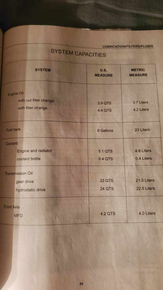

I just did a full service on mine and had $350 in everything from the dealership. With a 7 year warranty ill buy everything from them just so its on record that i put the correct stuff in it.
did your new fuel filter come with a large AND small 0 ring? mine was missing the small one, i had to reuse the old one.
Nope. No orings at all. The previous one i ordered off ebay and it had both.
