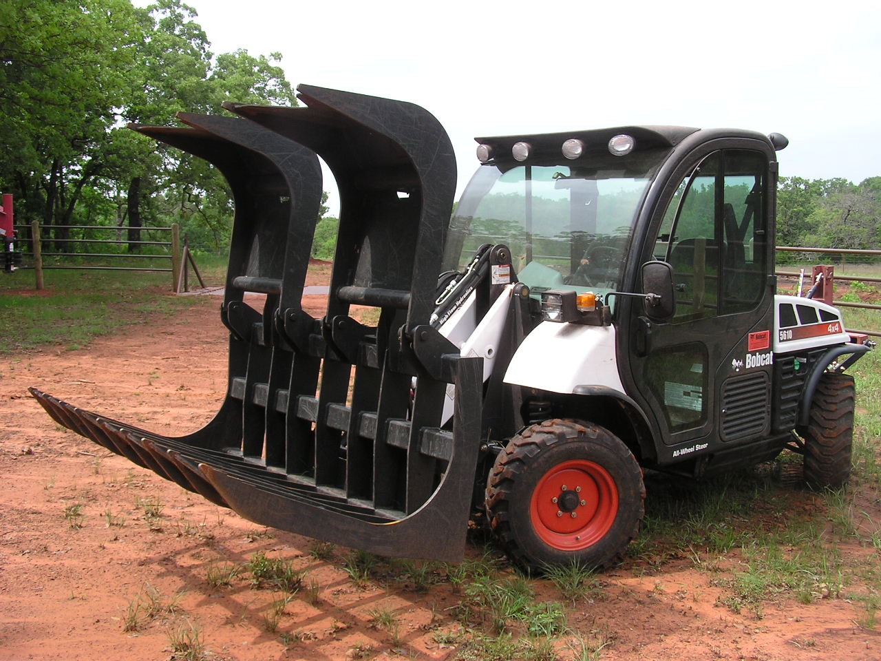

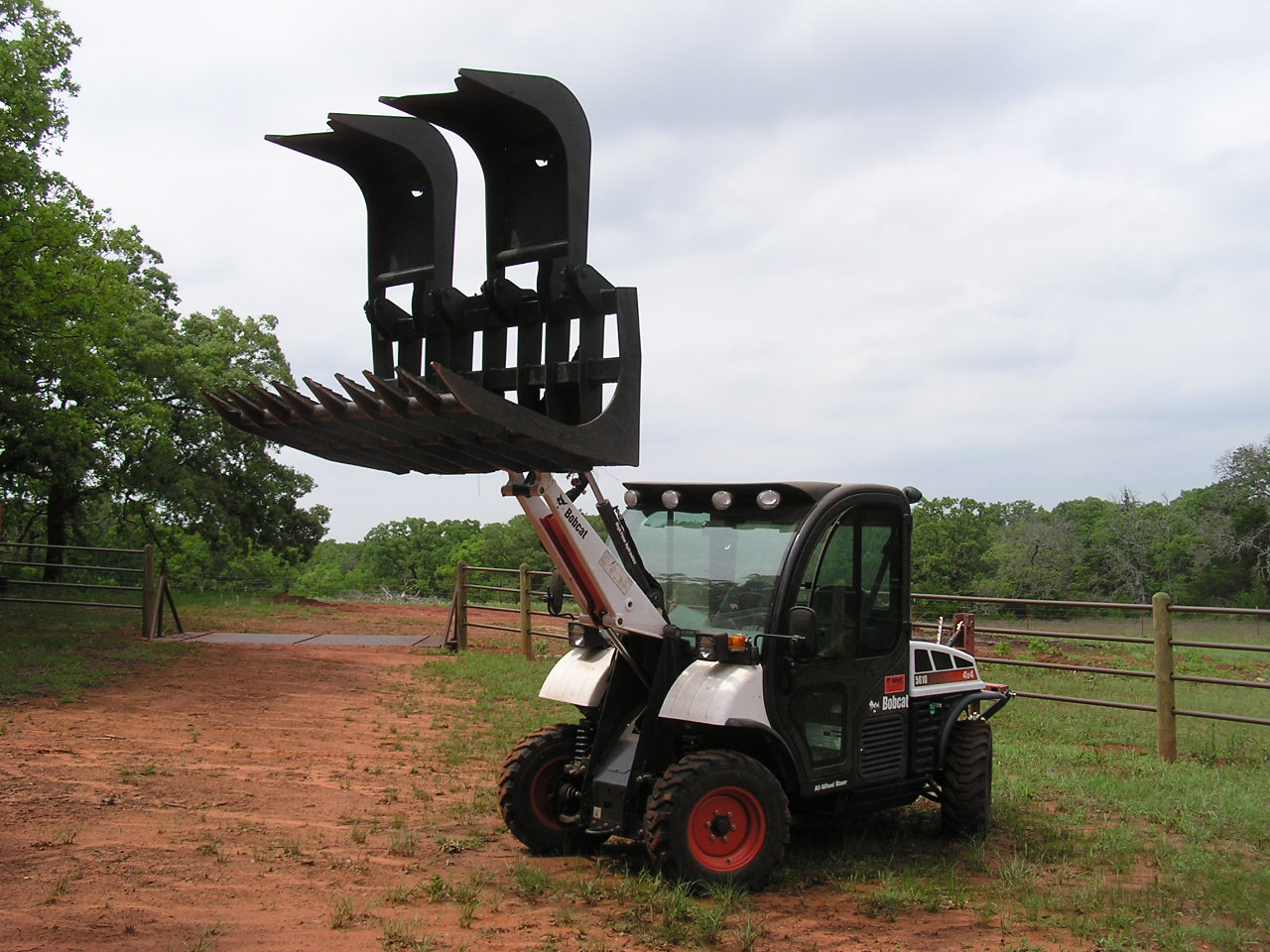

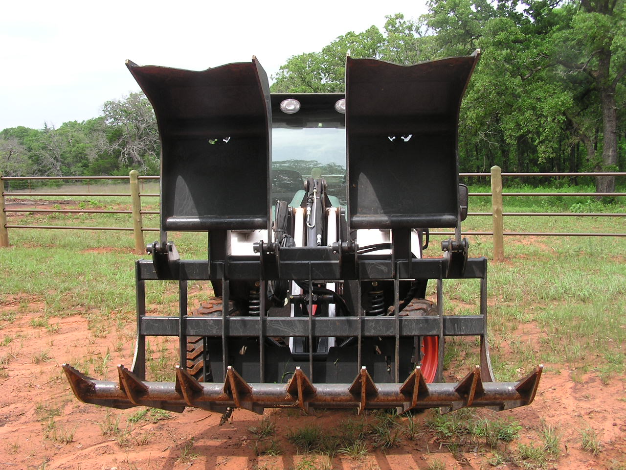

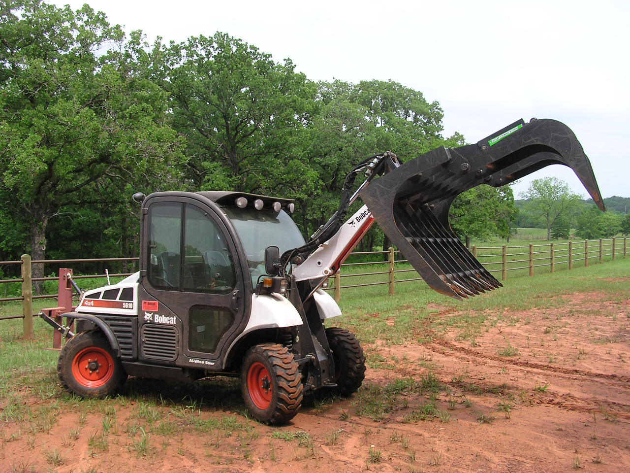

-What size skeleton grapple would be fine to use with the 5600? I have had some tell me to go as wide as the machine others say go 6 inches wider on each side. Is there any rule as thumb to keep in mind. It depends on your main use. For picking up brush, I like wide with dual lids.

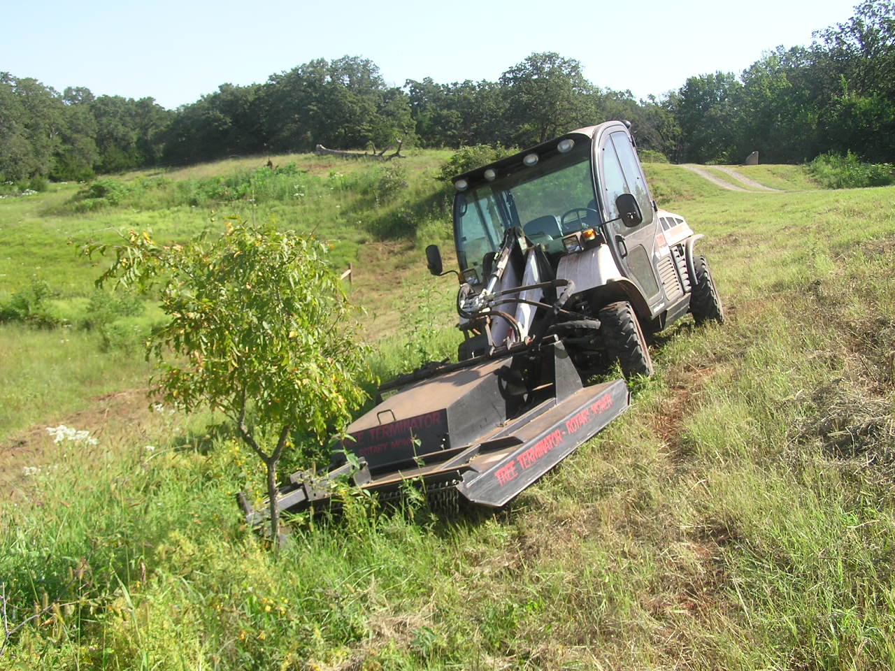

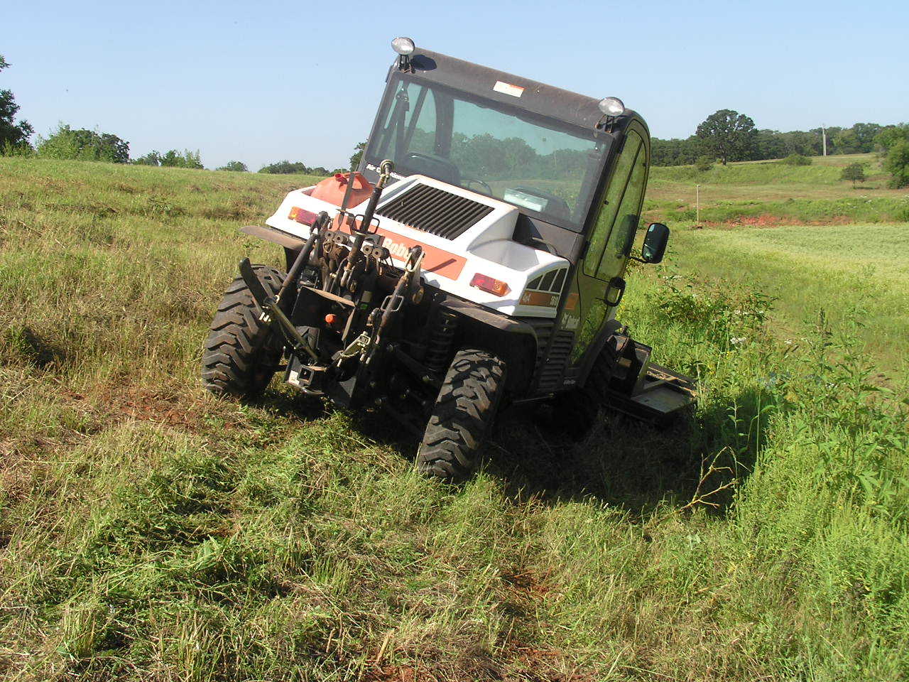

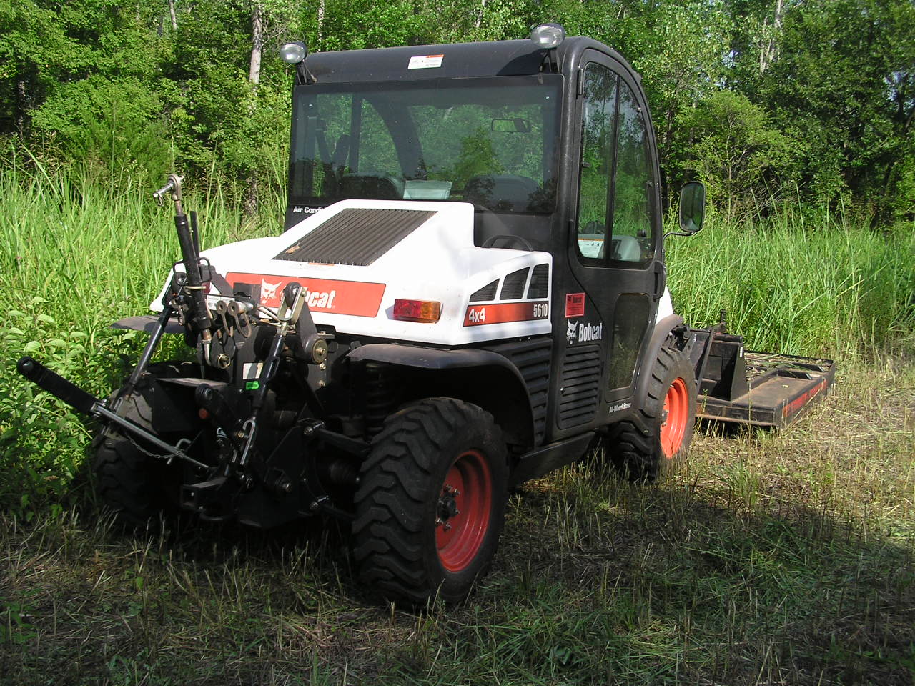

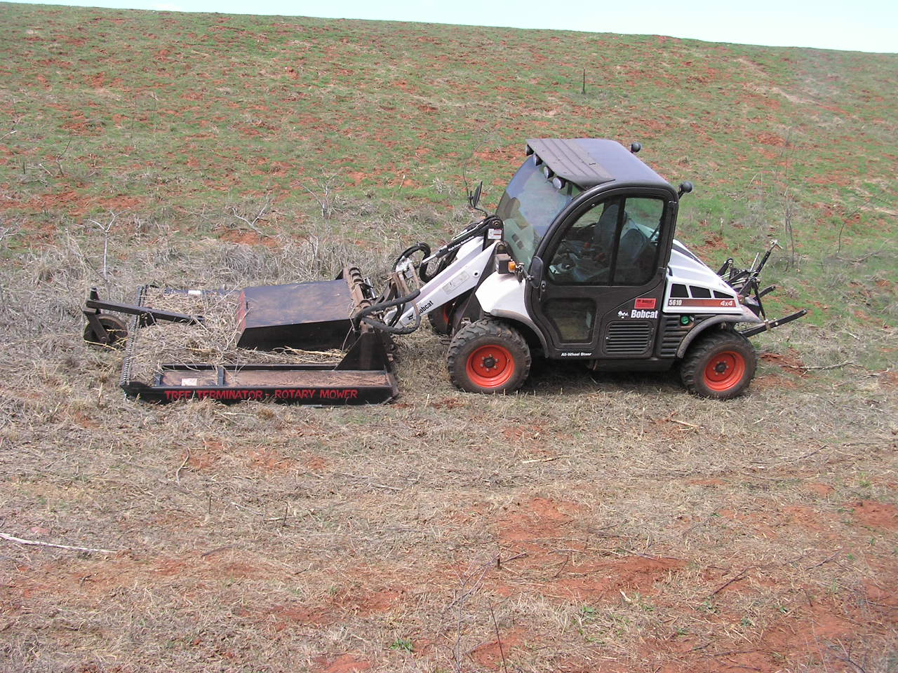

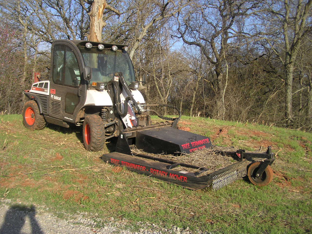

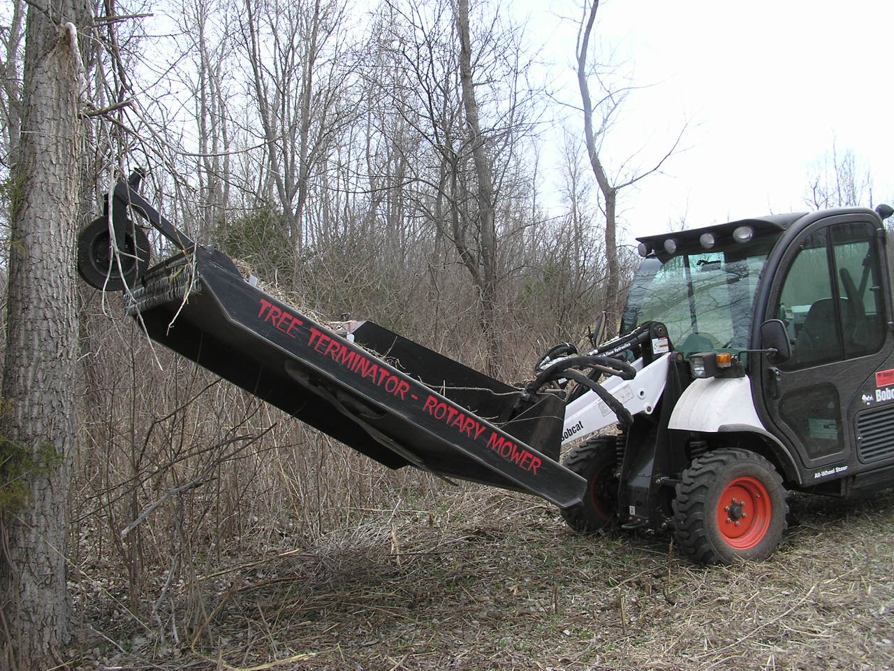

I went with the battleship rotary mower. 7' wide weighs 1800 pounds.

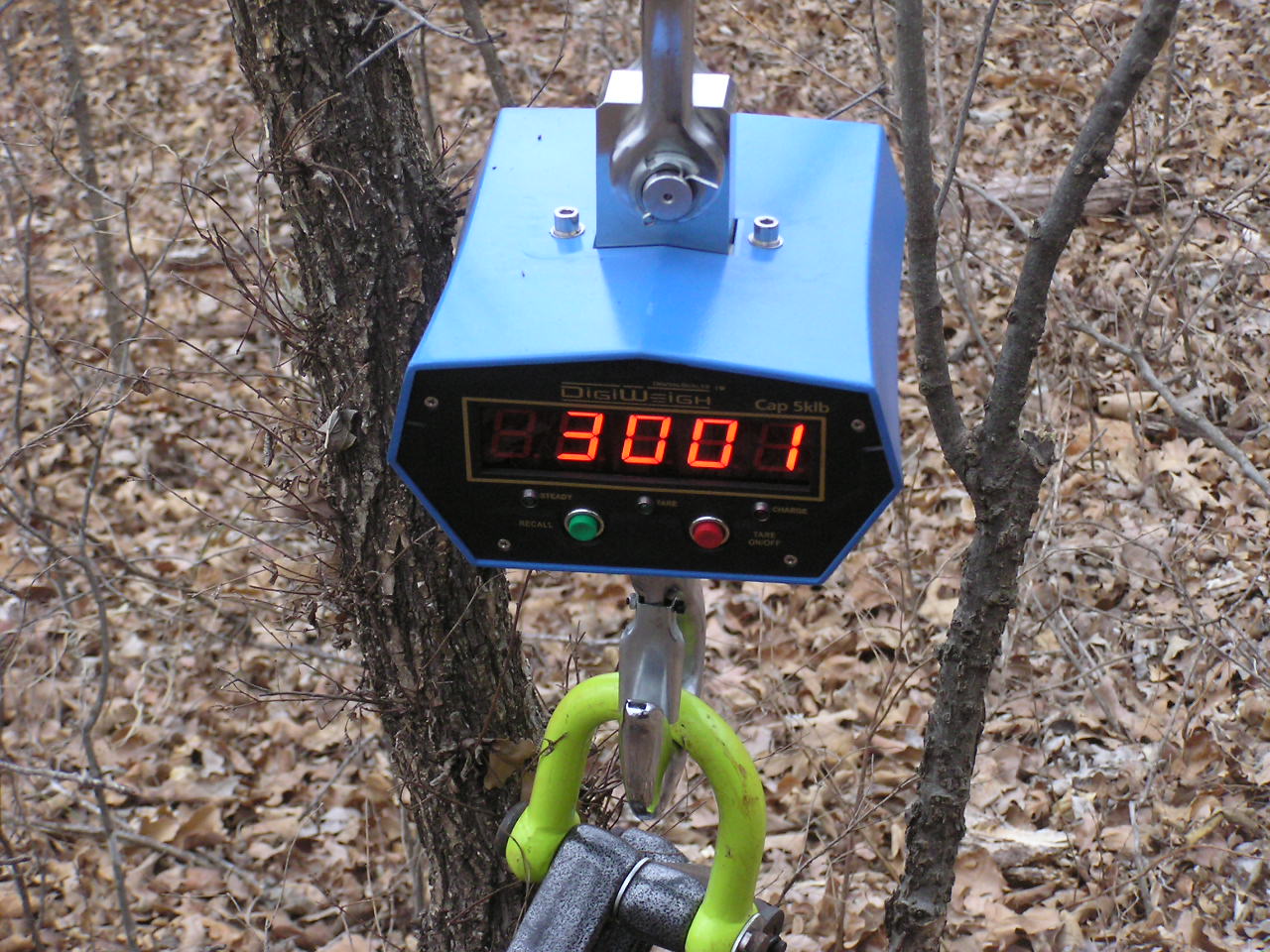

I measured the lift at the SSQA plate with no attachment, 3001 pounds.
The 5610 handles it fine with no counterweight on the 3 point.

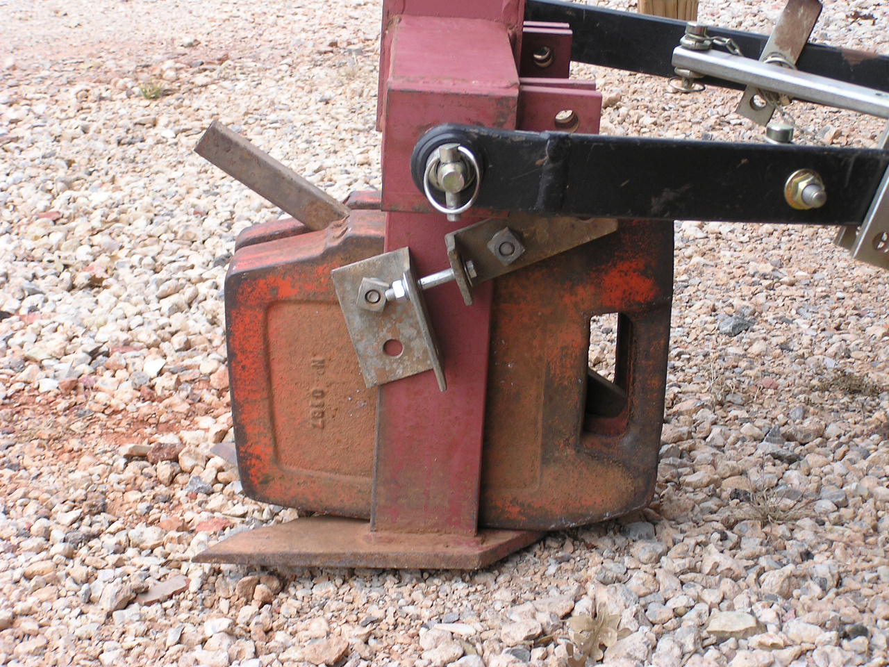

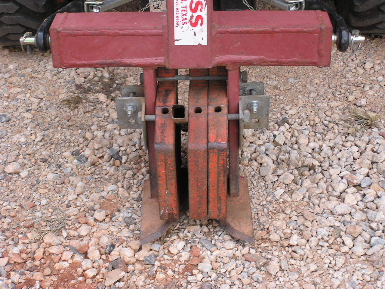

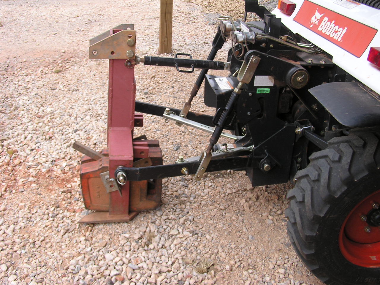

I did put together a 400 pound counterweight for better traction on the rougher, uneven areas of the pasture.
