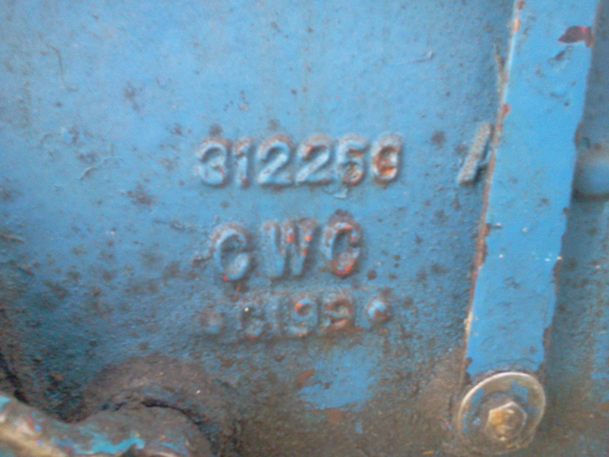

Congrats on your new tractor. Since you haven't stated weather your tractor has a ORC or DDC trans and you haven't got the manuals yet a word of caution should be taken if your trans has not been switch out to the later style DDC trans it would have came with the earlier ORC trans. there should be some diagonal slash marks on the shifter indicator thru gears 1,2,5,6 and 9 are freewheeling gears and will not hold the tractor back as a brake on down grades. Using the proper gears on a down grade will be an effective brake. A fully loaded hay wagon and the wrong gear going downhill can get you in trouble fast.
If your tractor was in the recall prior to serial number 97341 there will be a tracting number in the same location on the bellhousing but it will be on the oppisit side of the trans.
There was an exchange program in the mid 60's where you could exchange your ORC trans for a DDC trans. As soundguy said #'s on the cases are different.

Looks like my tranny is the ORC style.

be aware of that if ever going down hill or unloading from a dovetail trailer in a or gear range. :)
