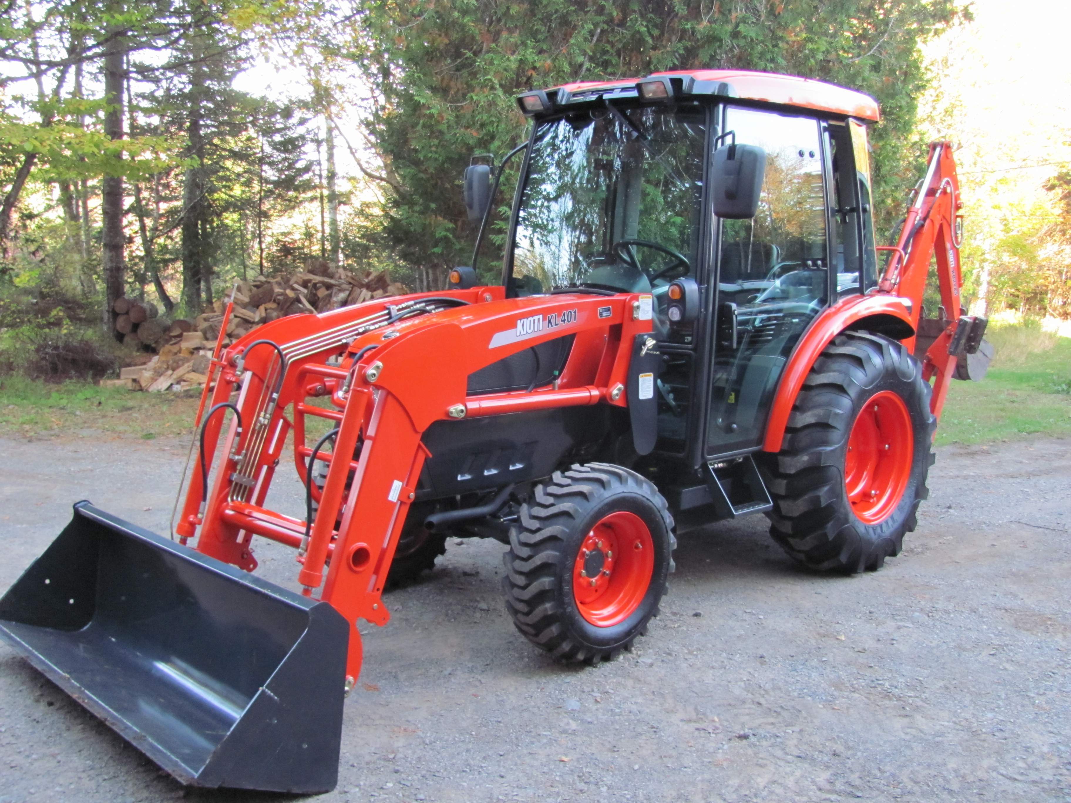

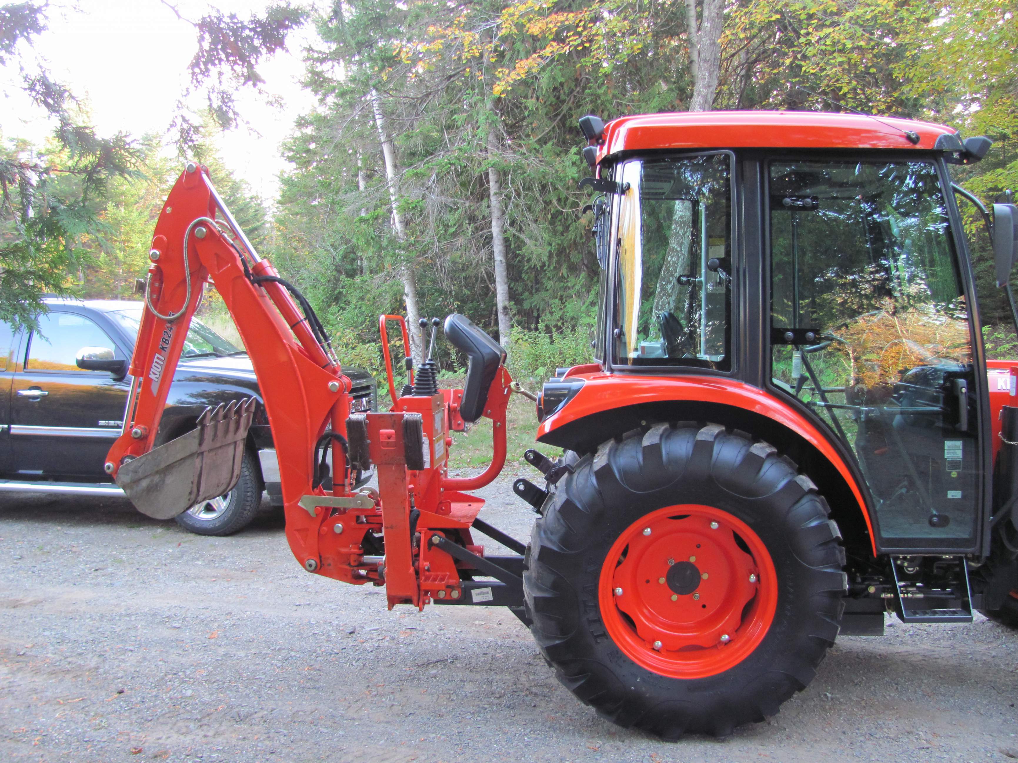

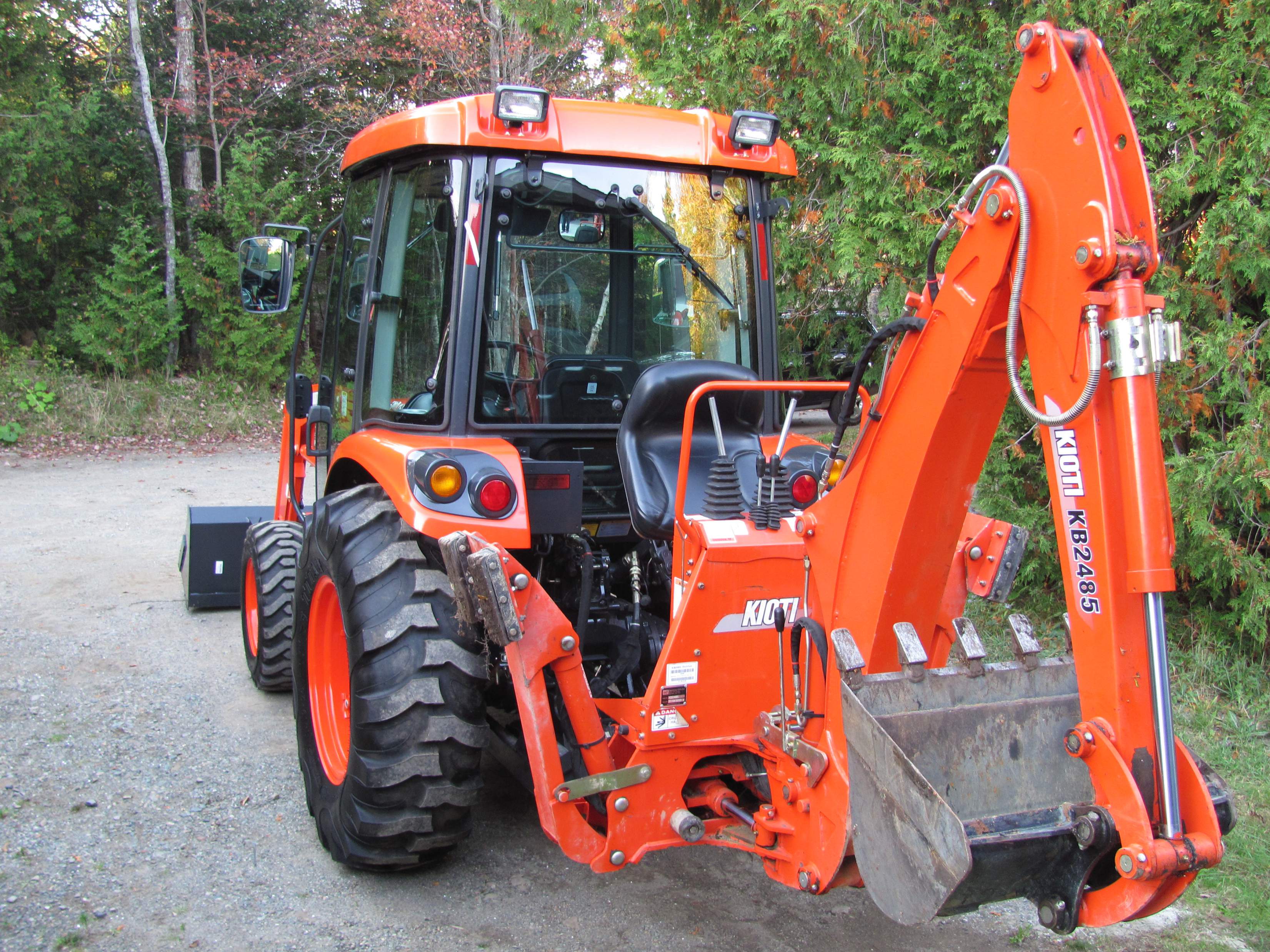

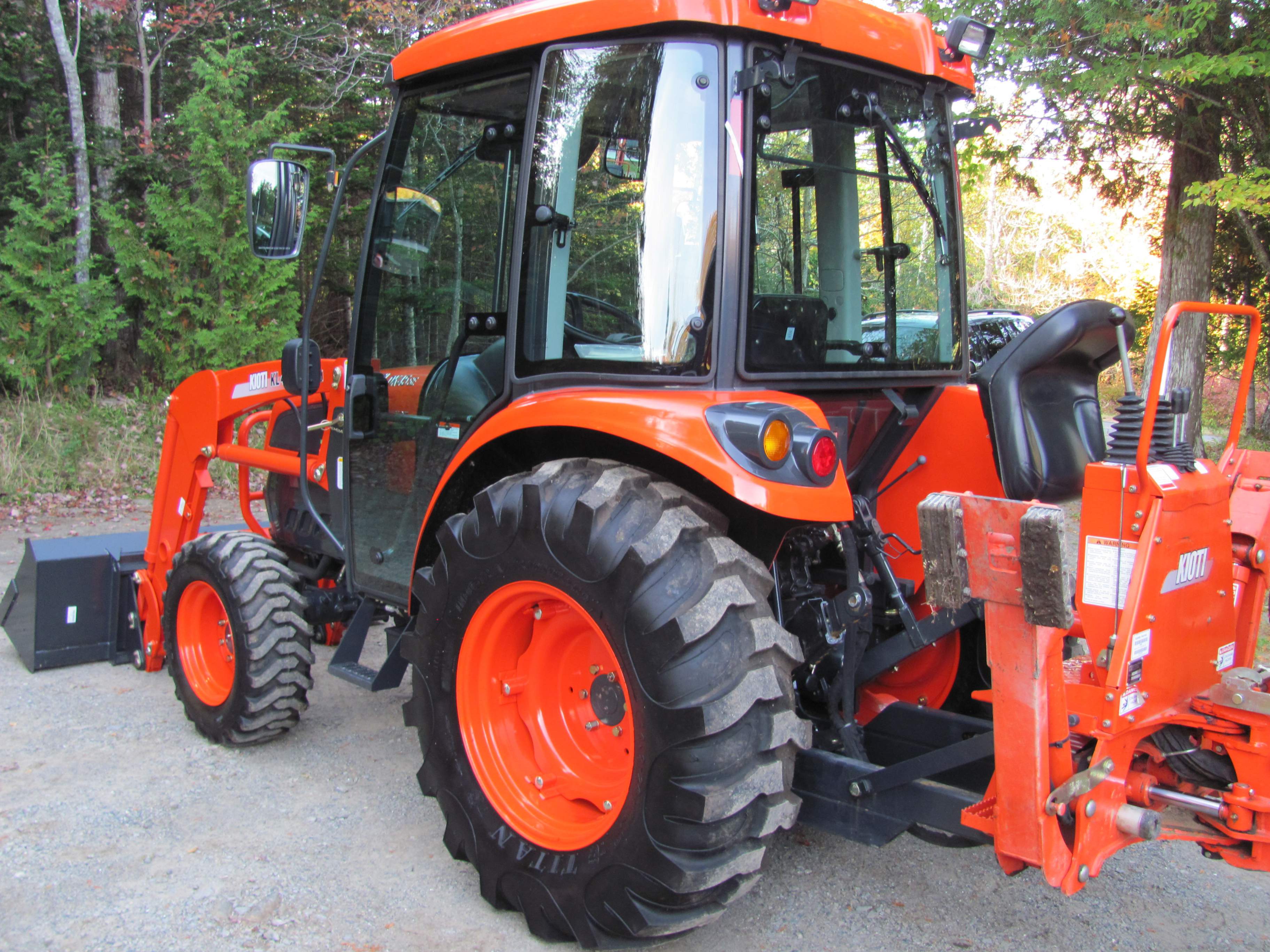

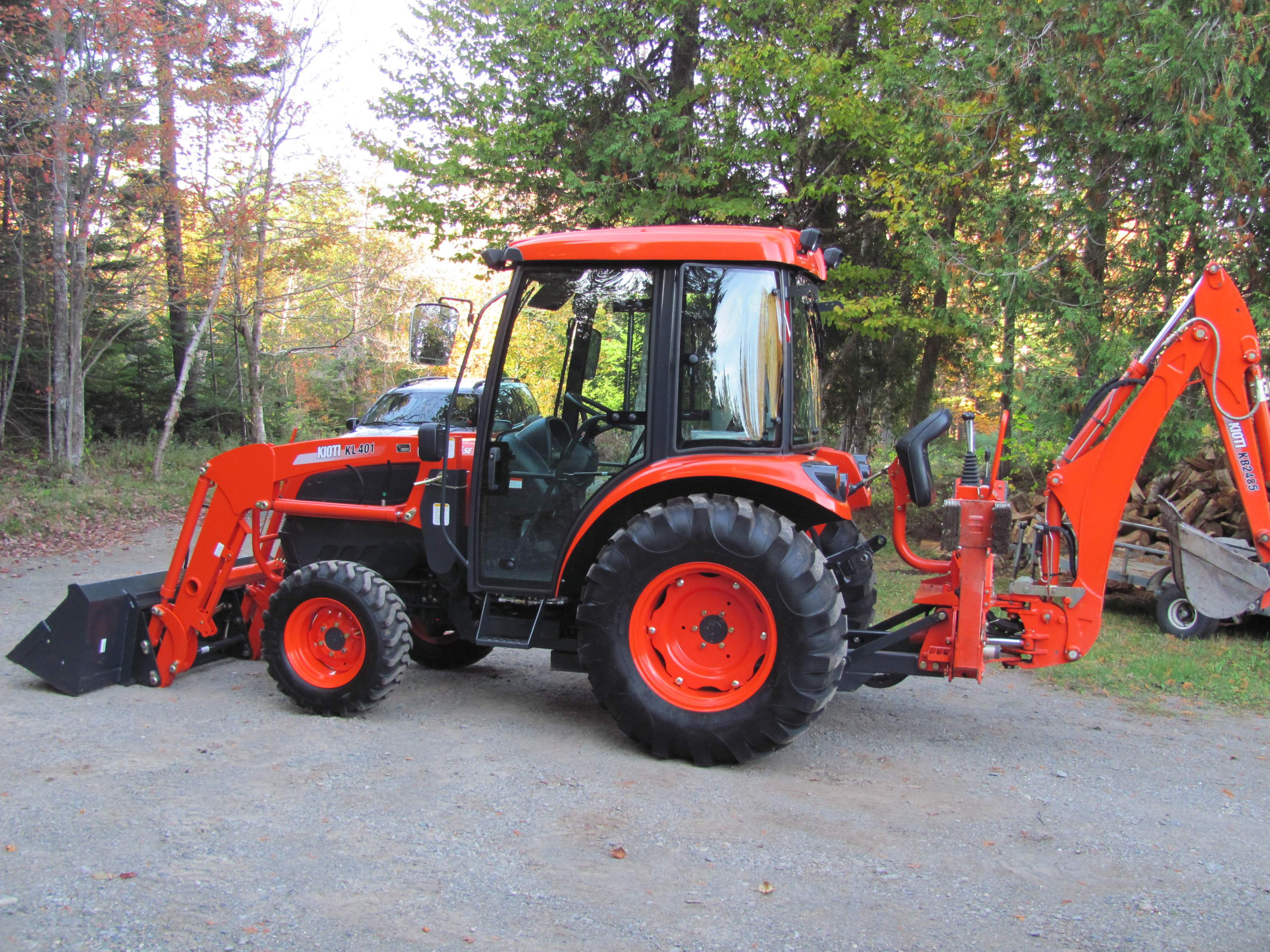

I just bought this one today. New tractor, hoe is slightly used. Been playing around with the hoe it is nice.
My last and only other tractor was a 9N ford 20 years ago.IMG_1357.jpgIMG_1358.jpgIMG_1359.jpgIMG_1360.jpgIMG_1361.jpgIMG_1362.jpgIMG_1363.jpgIMG_1366.jpgIMG_1367.jpgIMG_1368.jpg
I like the idea of the return line from the hoe.

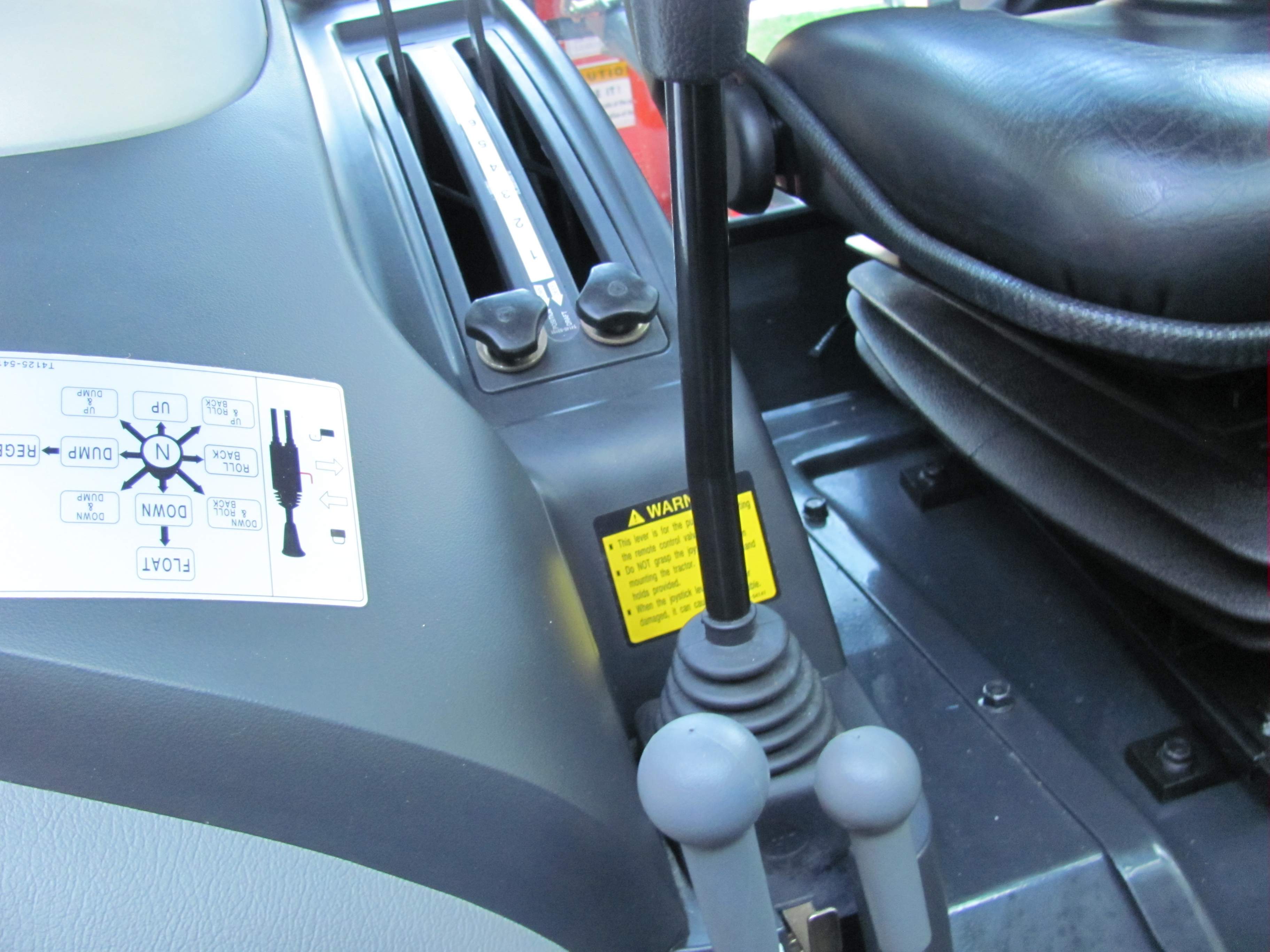

The knob to control the 3PH which is located near the floor boards between your legs when seated is to slow the LOWERING of the 3PH ONLY. It does NOT affect the raising of the hitch.
The return line on the hoe is SUPPOSED to be connected to the hydraulic fill/return port for better overall flow than just connecting to the other port on the remote bracket.
A hydraulic hose loop, to be used when a backhoe is NOT connected to the detented remote ports can save a hydraulic pump meltdown and huge associated expense, as mentioned by GRSthegreat. It bears close attention to having one made to use when needed as described above.
Thanks CM I will do that as I have to make up some hoses to run forward.
The dealer did this up nice for me besides he had to sub the 40 I asked for up to a 45 due to availability.
