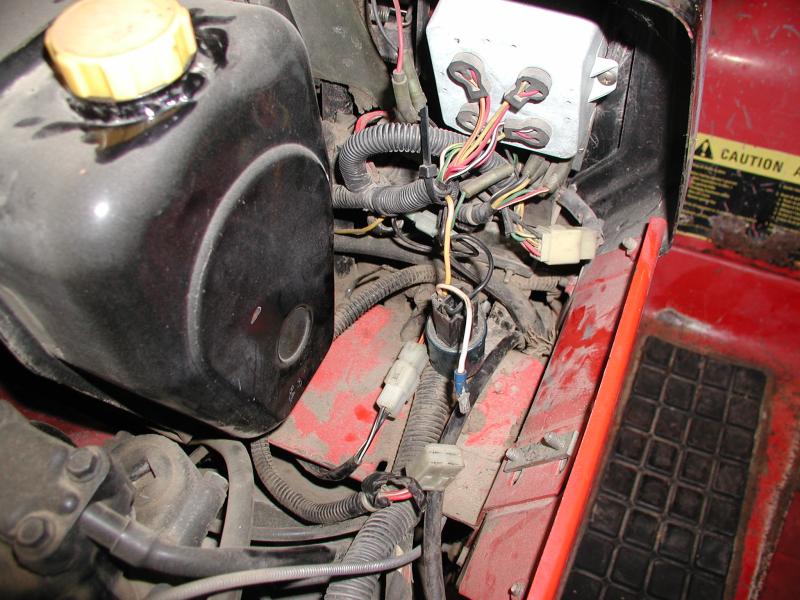

Here's the wiring. The PTO clutch is disconnected, the plug doesn't appear to have anywhere to go.

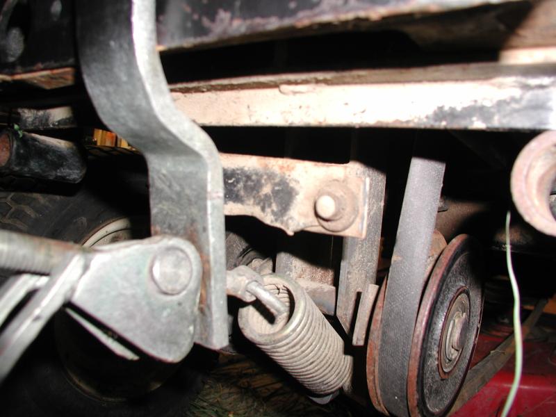

The PTO clutch works, but the tensioning mechanism is very very loose. The pulleys in the picture move side to side a lot. I'm going to have to fab some kind of bracket up to hold it better. There's a little bit of sheet metal at the top, I couldn't see where it attached.

Fixed the starting problem, it was a maladjusted clutch switch. Got the hood off, and found that the pin that the whole PTO adjustment assembly pivots on was falling out. Looks like an easy fix. This thing is looking more like a sweetheart deal all the time. The main thing left to fix is the wiring to the PTO, and get a reasonable seat on there. Anyone have dimensions on a seat for the GT14? Or a used one? I'll buy new, but only want to spend about $50. I'm sure the OEM seat isn't that cheap. Also, is anyone making decals for this thing, I'd like to take all the sheetmetal off and straighten and paint it before the wife sees it. (She's out of town for a couple weeks)

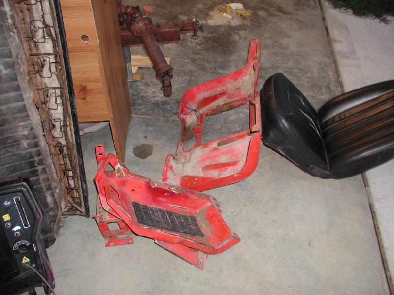

#19
Yes, it's very comfy, but I can't stnad the looks of it. It's coming off. Anybody got any sources for a really comfortable aftermarket garden tractor seat with good lumbar support for a bad back?
BTW, I'll post photos a little later, I have the tractor sheet metal torn completely off the tractor. Right down to the chassis. All getting straightened and painted next week. I want it to look pretty for the wife. It's going to be her surprise.
I've got manuals coming, wow, expensive.

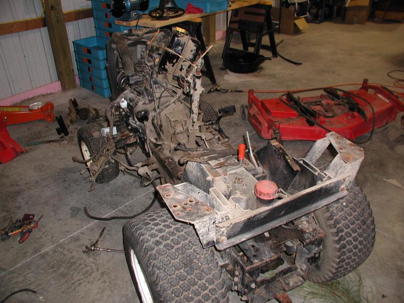

#20
More sheetmetal
